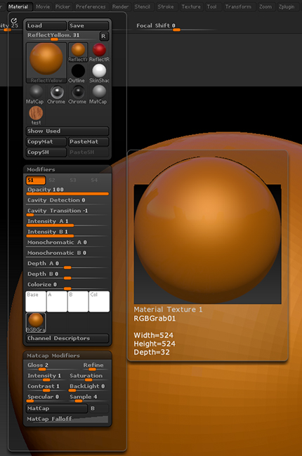

Is there anyway to export the sphere map from a material through zscript? or through any other method? I’m currently taking a screenshot from zbrush window… but as you can imagine, I can’t automatize that.
Ideas?
Edit: I’m now thinking on some sort of cheap workaround. What if I could simply draw a polysphere in the canvas, change the document size to 256x256, make the sphere fit the canvas, and export the document as psd?
The only problem I see, is that I would really like that after this is done, I could return to the document I had before, with the tool I had before drawed on the canvas. And with the same “camera” position and all. Would that be even possible?

actually I ended up using the workaround I mentioned. Cropping the canvas to 512x512 drawing a sphere with the selected material applied, and exporting the document.
Together with the macros I’m using for GoMax, it revertes to the document you were using before, loads the ZTool you had, and restores the camera position

You don’t need to crop the canvas. The MRGBZGrabber tool can be used to capture the Sphere at exactly the size you want. Additionally, if you hold ‘Ctrl’ and drag the MRGBZGrabber across a second time you will get two spheres side by side in a single texture.
Here’s a script that shows the technique.

I see what you mean… Does not seem to be possible at the moment. But atleast for GoMax it’s good enough. Since what I really want is that the end result is exported. You could always make a screenshot of the spheremap :confused:
You can extract the two spheres. It’s simply a question of setting some of the Material Modifiers. Here’s a revision of my earlier script. It tests to see if the material texture is square; if it isn’t a second sphere is grabbed.
It might not work in all situations but perhaps it will give you some ideas.
EDIT: I switch off Shadows in this version, as they would otherwise change the effect.

The method I described allows you to store the matcap A and matcap B of the texture applied to the canvas as two seperate maps, which can be exported from the texture palette.
note: after drawing the shaded sphere on the canvas use grab document to extract a texture.
Then with the flat shader selected begin the matcap process.
These textures are diffuse and dark areas, which could be used to enhance your shader network in external app. (colour and diffuse for example).
Using grab document to capture the shader ball from the canvas won’t allow you to seperate the diffuse, the dark areas or the specular…it is more like baking, where as my method allows more control in the render.
