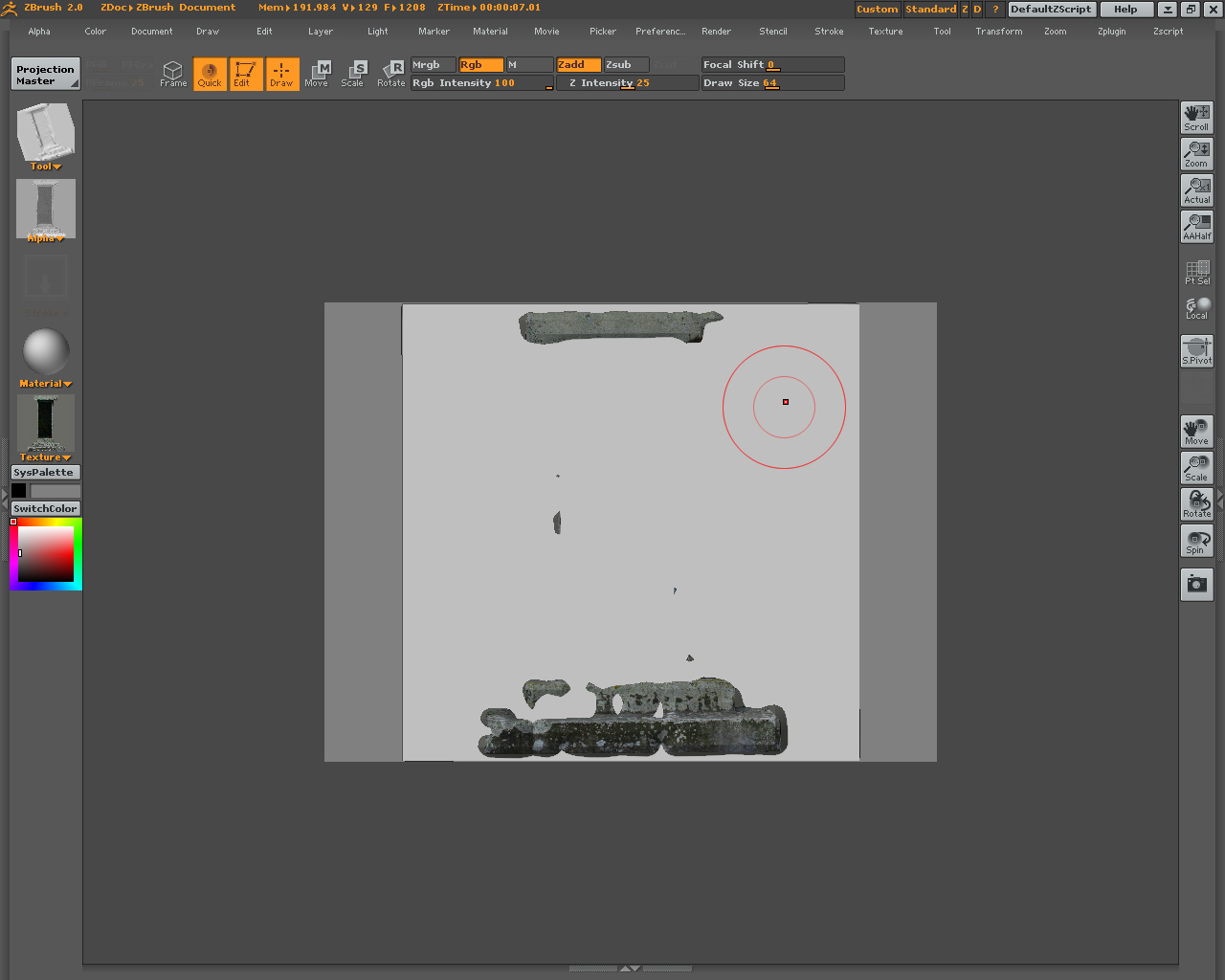

- Set the color palette to black.
- Texture: Set Width and Height to 2048 x 2048 and click New.
- Drop into Projection Master with only color checked.
- Select or load the Feature tool.
- Texture: Load mask file texture created in Photoshop for this tool.
- Click the marker that we just stored for it. This will redraw the model in the exact position.
- The feature we are drawing should be completely white and the rest of the wall should be black.
- Bring the feature forward in Z space by pressing Move in the shelf to get the gyro. You should not be in edit mode. Then click and drag downwards once or twice.
- Repeat steps 4 through 8 for every other Feature that you have included.

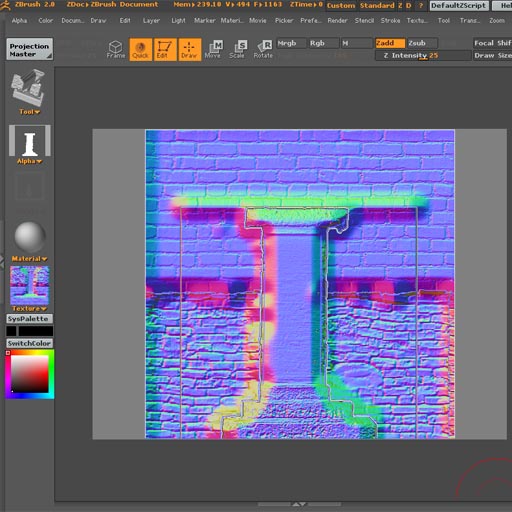

Converting the Mask to a Stencil
We will use the Stencil while working in Projection Master to keep the Features from being effected by our broad placement of the bricks that we will do next.
- Select alpha created from grabbing the canvas and make it a stencil. To do this, select the Alpha in the Alpha palette and click Alpha: Make St.
- Invert the stencil. Stencil: Invert.
- Now, let’s make it easier to see through the stencil. Click Stencil: Elv.
- Position the stencil correctly by clicking on Stencil: Vert or Stencil:Actual. This will position and resize the stencil so it lines up vertically or according to its actual Pixol dimensions.

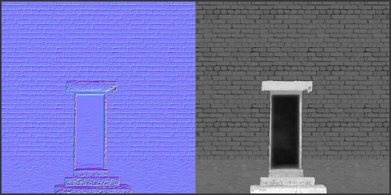

- Generate the normal map. Tool: NormalMap. Click Tangent, set the resolution very high, let’s say 4k. Then click Create NormalMap.
- Generate the bump map. Tool: Displacement. Click Adaptive and set the resolution to 4k. Click Create Displacement Map.
- Export the maps. Texture: Export the normal map and the texture map. Alpha: Export the displacement map. This will be our bump map.
