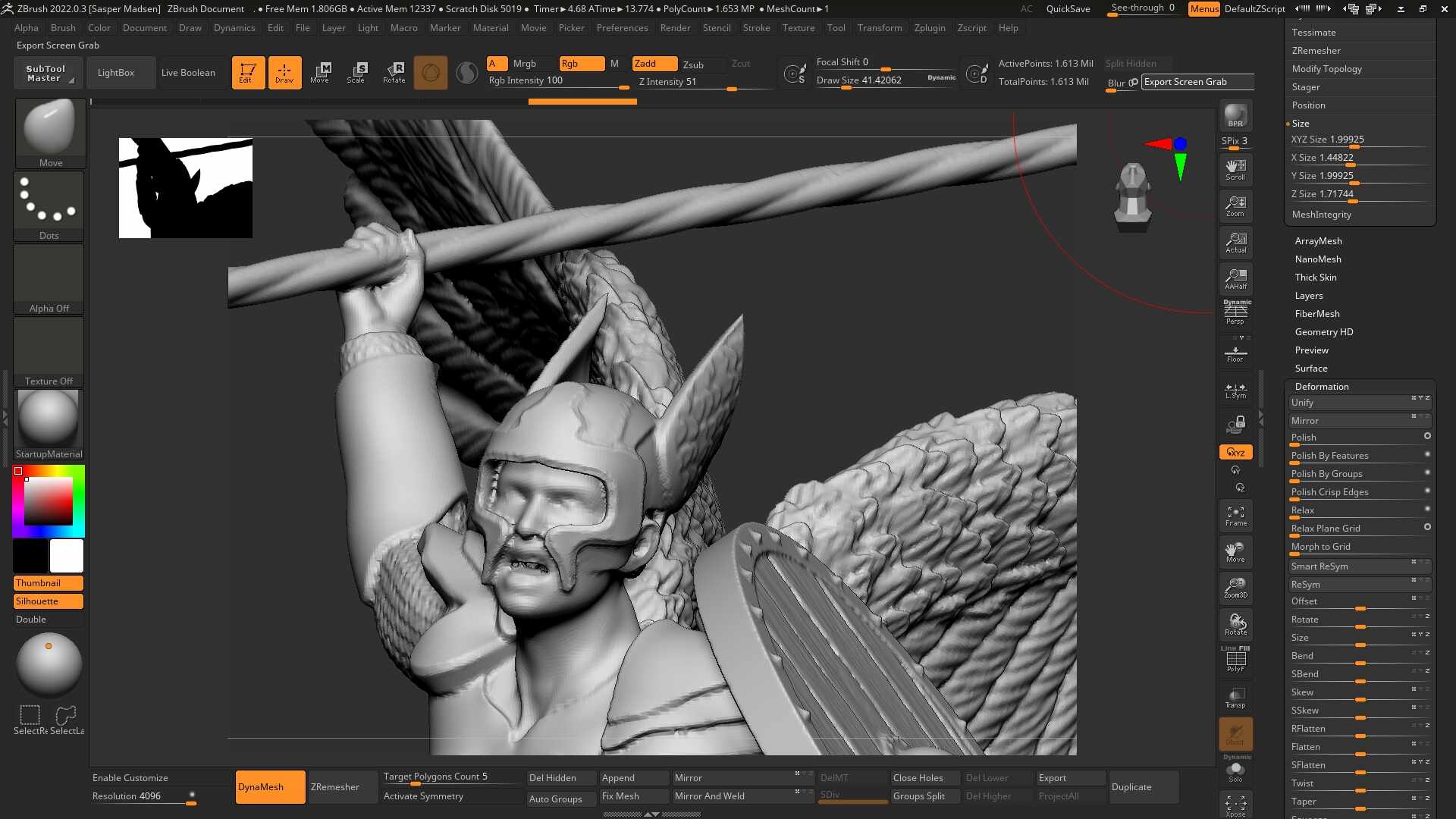

ZBrush ScreenGrab01
The model is pretty detailed,

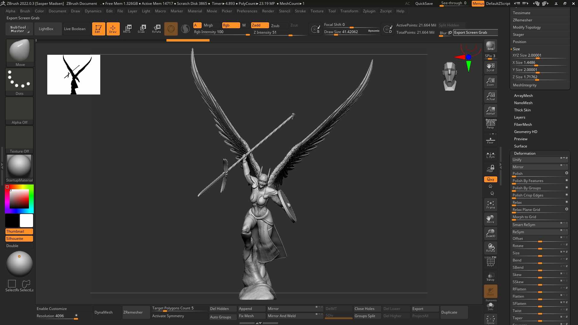

ZBrush ScreenGrab02
but when i dynamesh it, i lose all that detail.
ZBrush ScreenGrab03
I just can’t figure out why. I have tried unifying the mesh, Manually setting the size to 2, using relative dynamesh, but nothing seems to work. No matter what i do, i cant push the resolutin past 1.6 mil, sometimes 2.0. But that’s as high as it goes. Some of the subtools can be pushed beyond that on there own using dynamesh, but it seems, that when i merge when together, something is limiting my output resoluition. Using the dynamesh resolution slider caps at about 2016.

I think that using Dynamesh to get a single, water tight mesh is an older method. Also your (beautiful!) model doesn’t fill much space in a bounding box around it so it will be difficult to get a high density mesh even with maximum Dynamesh resolution.
