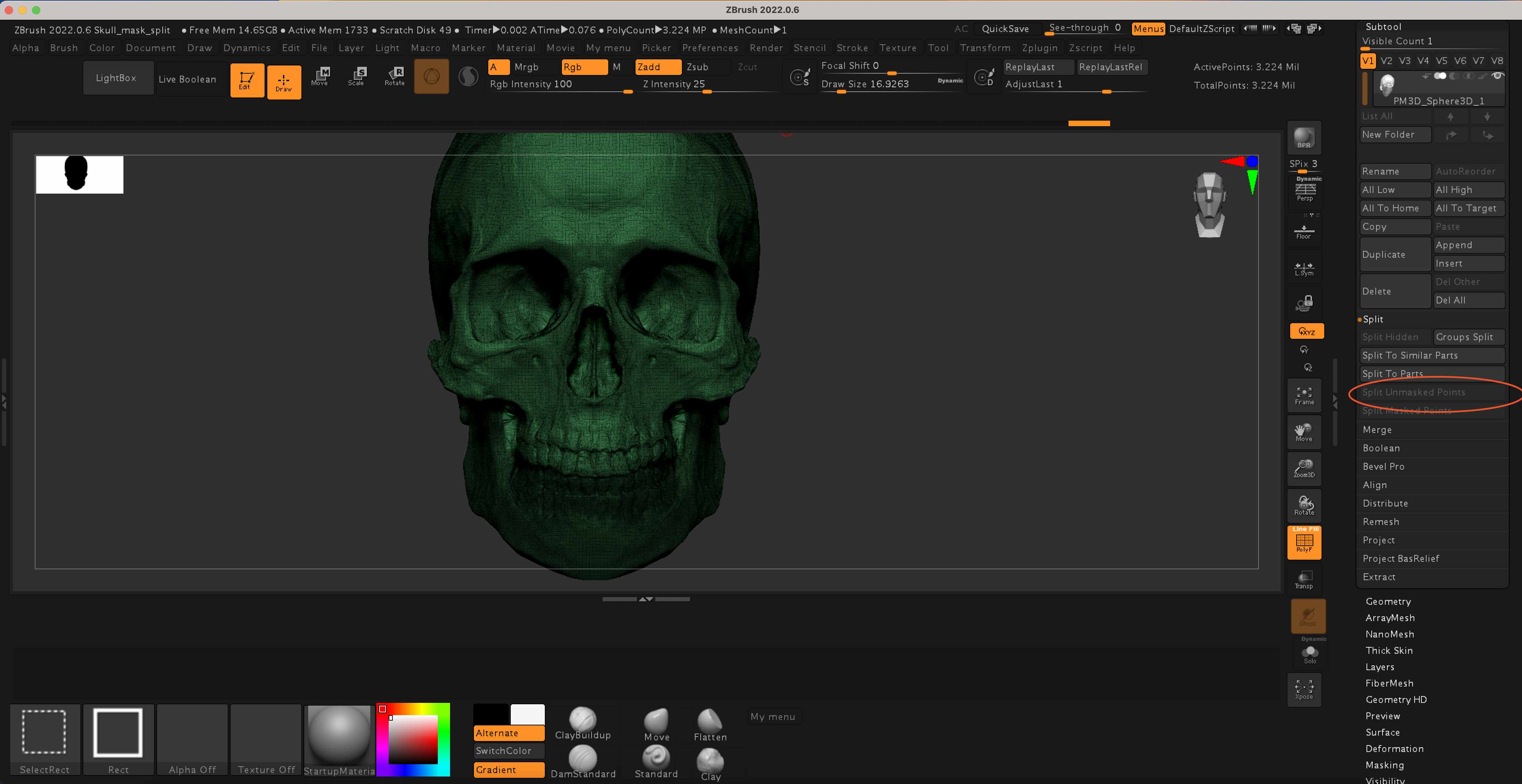

I’m beginner since two weeks and would like to know if in subdivision level 4 I able to separate this two polygroups and after done it, close holes or if I just do it in low resolution ?

This won’t work with subdivision levels. While at the highest level of subdivision go to the Geometry palette and press “Delete Lower Subdivision Levels”. The Split Unmasked option should then be available to you.
Thanks you very much @Spyndel Spyndel. I was so afraid to have worked the details for nothing thinking I had to use Zremesher button to retopologize in low res and thus wasted my time.
