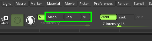

Use Spotlight and turn off MRGB, RGB and M.
2020-01-19%2014_04_18-ZBrush
Turning off material and color projection won’t change how my displacement is projected and this is not what I am asking.
