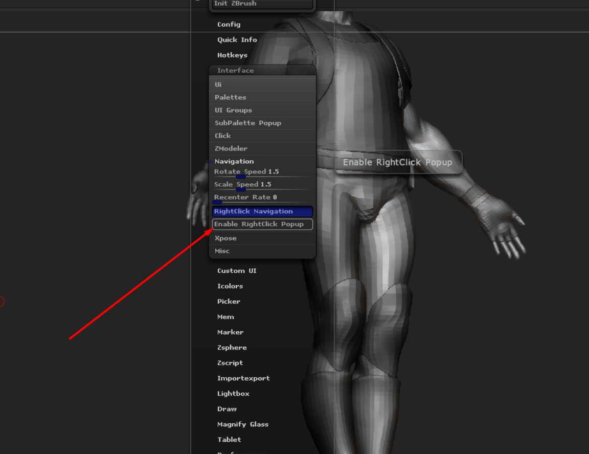

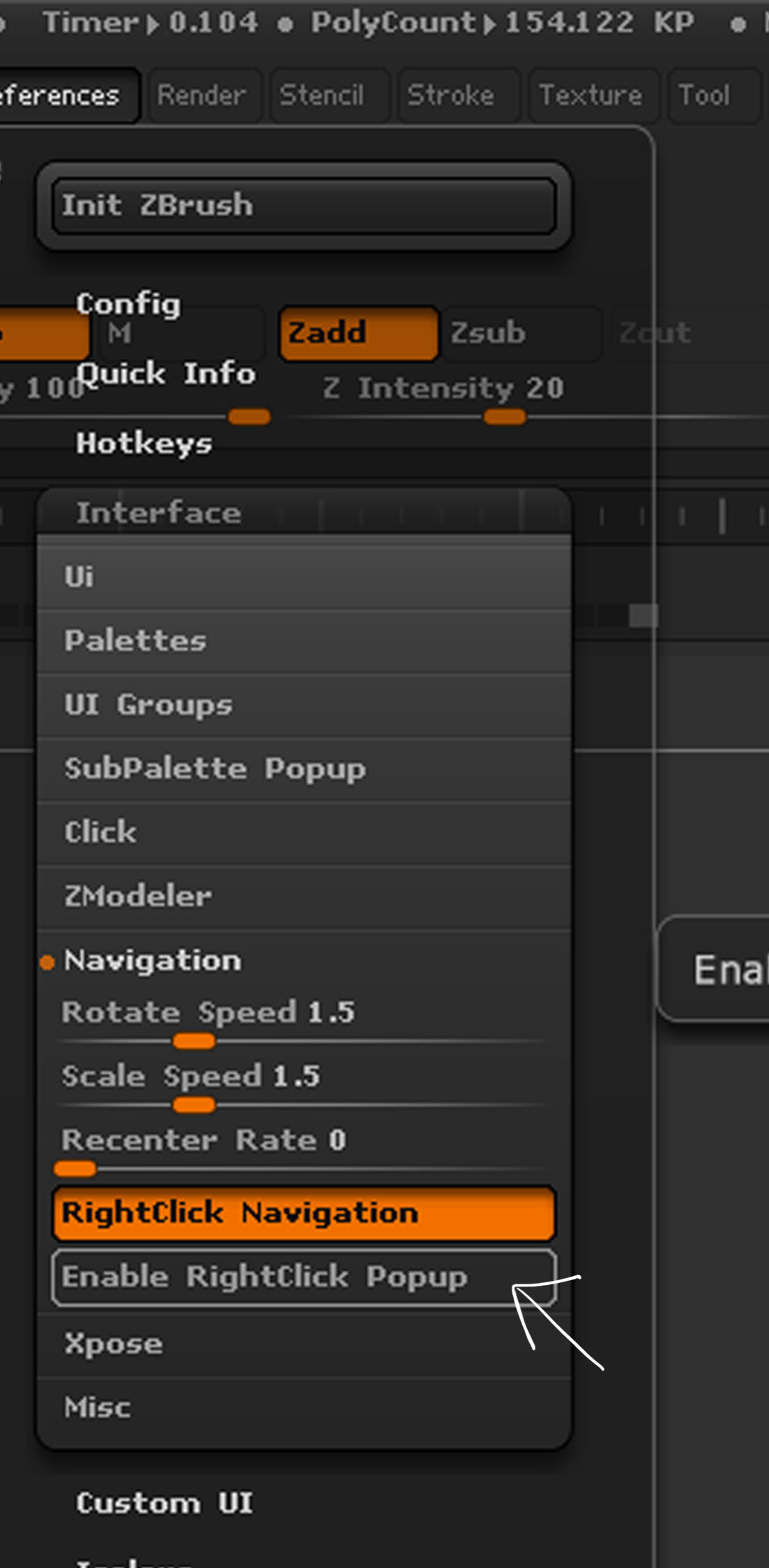

Have you tried this?
Just disable “Enable Rightclick Pop”
when the right click popup is disabled, you no longer have the access to the zmodeler panel you will have to hit the spacebar to show it.
