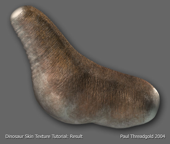

Beginner/Intermediate tutorial demonstrating the method of skin detailing and texture painting that I used for my velociraptor model.
The main areas covered by the zscript are:
  • Form sculpting starting from zspheres
  • Custom alpha creation to quickly detail the model with wrinkles as an alternative to the deco brush
  • Texture and bump painting with projection master
  • Layering colours to create a realistic skin tone
There are some areas where I would have spent a bit longer on or would have erased and redone when I was making the original model. However I was trying to keep it as short as possible and was aware that I couldn't revert to save if things went silly. You will notice that projection master decides to add one of it's 'special effects' right when I have nearly finished!!! In the script i stare at it for a while...supply the swear words yourself to complete the effect ;). Also, when I replayed the zscript I noticed that zbrush had other ideas about how I should set the lights up at the end. So ignore that bit!
I hope this zscript helps people out, particularly those new to ZB. If anybody has any questions I will be happy to answer them.
