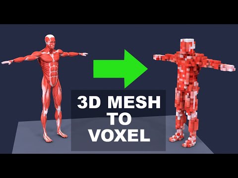

Game Master 770, Good image of voxels.
The ones shown in the dog.png are more like binary voxels than the type of voxels found in MRI scans or the like. When I say binary, I mean they either exist or don’t exist. MRI scans and most voxel data is really a 3D array of density values. Using algorithms such as Marching Cubes a mesh can be extracted from the density values and displayed more effectively with modern hardware. Here is a pic of a voxel engine I wrote myself. It also used binary voxels at one point but applied mesh smoothing to make it less “blocky”.
There is also another varation known as height maps that have great exposure in video games. Instead of a 3D array of density values you have a 2D array of height values. For a given coordinate (x,y) the array defines how high the “terrain” is at that point. This image shows an example of height maps generated using the ROAM algorithm. Height maps are quite popular because they require much less memory than a full 3D voxel representation.
