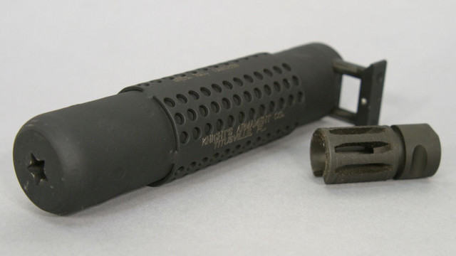

I want to carve the inside of a short tube so it looks like a star-shaped gun-muzzle instead of a plain circle. Kinda like this:
I thought by using an Alpha I could do it, but clearly the polys are being strained when I reach the other side, and what I want to do is to “cut” a shape into the cilinder while preserving a clean topo and a hollow from side to side. I don’t have any idea of how to cut down the shape, hence my question. Sorry if it sounds noobish and hope someone can help me with this :o

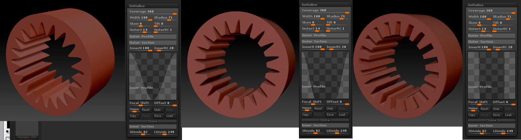

I’d follow Spaceboy’s tip (gives a nice clean lopoly mesh), alternatively, you can also experiment with the Initialize settings of the Gear3D tool. [attach=185508]Gear3d.jpg[/attach]

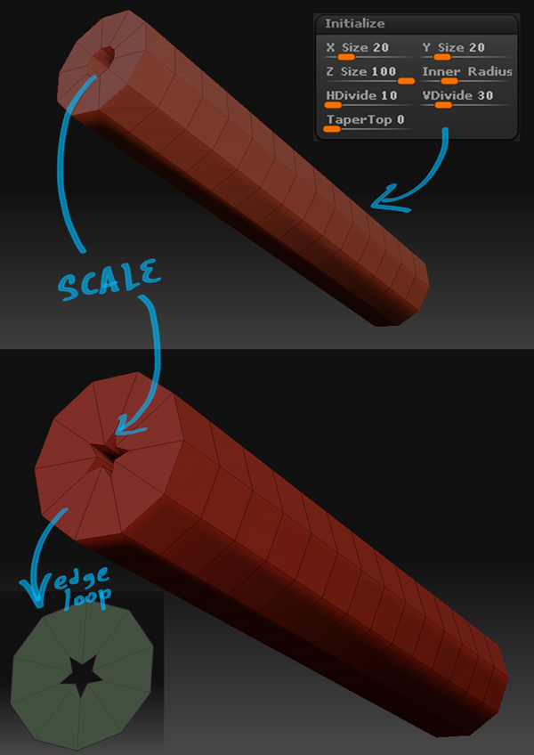

Another solution would be to start with a Cylinder3D. In the below example I gave it an inner radius value of 30. Once you have your cylinder with a hole in the middle, do this:
  • make polymesh 3d
  • make sure perspective is disabled and snap your view so you’re looking down the “barrel” of the gun.
  • mask all
  • use the lasso tool to unmask every OTHER inner point.
  • deformations>scale, disable Z, scale to -60
  • unmask all
That will give you your star. Now hide the polys for the length of the barrel, so only the caps are showing, and use Geometry>Crease so when you subdivide, your cap edges will stay nice and sharp. You could take this a step further if you want and crease the edges for the star going down the length of the barrel. Alternatively, you could use Edge Loop with Crisp enabled. Your choice.
[[attach=185513]boolean.jpg[/attach]]boolean.jpg

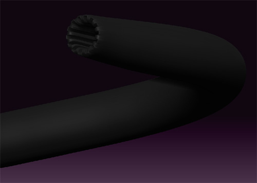

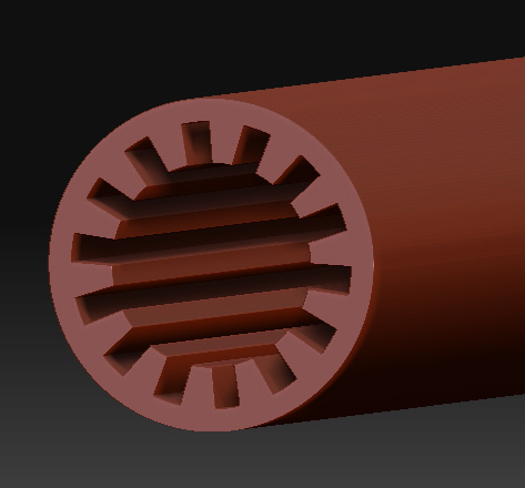

Precisely, I was experimenting with the Gear3D for a long while before posting here, because I couldn’t create the indentations within the Cylinder3D nor into the roundish one, but I never ended up with the square shapes that Etcher made :frowning:

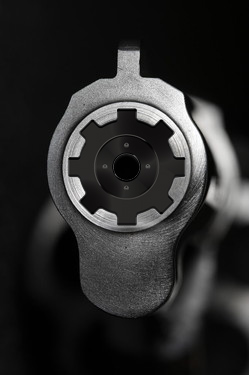

I also applied what dustinbrown and spaceboy advised. I think my question wasn’t enough clear as I wanted to make a “star” shape like down the cilinder like the first gun-muzzle (in reality, a M4QD Knights Can for flash suppressing) but with the shape of a gear, like on the photo below the first one :o Anyhow, thanks because now I have an idea of how to make any kind of shape down a cylinder without making use of complicated alphas to mask and unmask the mesh :slight_smile:
:bulb: Thanks Etcher for posting the settings you used for your gear :smiley: I was like “hell, I want the indentations SQUARE not pointy face desk” but then you shown me that I could modify the shapes by editing the curves (I think I couldn’t see that panel first because I needed to click those narrow buttons with orangey patterns first to make it to pop up).

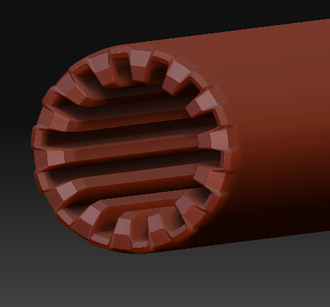

After experimenting, I got what I wanted and used Deformation Size Z to stretch the cannon and get the basic shape to work later with the polymesh.
One thing I couldn’t understand is that after I CTRL+D to give the mesh a little more of res, the sharp borders of the tips collapse inwards and I don’t know how to prevent this :o
you’ll need to do a poly edit, hide all but the end cap faces, then create an extrusion without moving, for a nice crisp edge
if you want to prevent the teeth from doing the same you’ll need to do similar on them as well to create edges that are very close or on top of each other

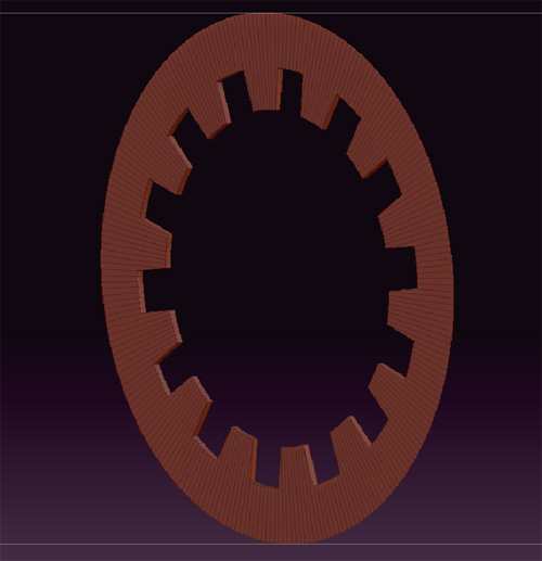

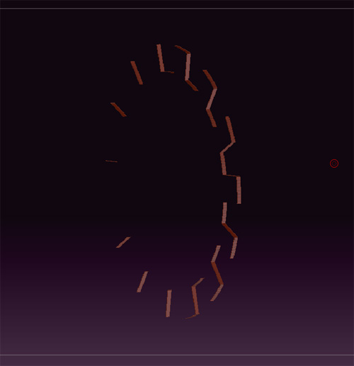

@wasa - As hard as I try to select just the end polys of one side, I always end with this kind of “echelon” just behind the flat vertical polys of the face of the hole, kinda like this:
I rotated the second photo just to show from behind how these extra polys are forcely selected even when I just select the other ones.
Also, talking about how to extrude as you commented… I’m still working with an “initialized” primitive and I don’t know how to add those extra polys to the face by extruding it when I have limited tools at this point.
I know what you mean by extruding it of course. Just… I really don’t know what tool I should use in this situation, since it is a pre-polymesh primitive :o feels more noobish now I’m thinking about adding some sort of Edge-Loop or something like that to add some quads from the outter rim to the inner rim, thus preventing the collapsing by adding new geometry to the face, but… as I said, I don’t know how to translate this thought to Zbrush operations. It is the typical “I know what to do but I don’t know how to do it.” /orz

To avoid the end-cap selection problem, crank down the ‘SDivide’ value
(in the gear tool) to something small before going to polymesh.
Then you should be able to select just the end-cap.
(Also check out the use of the ‘Crease’ and smooth buttons before sdivide?)

Rumi, you can unpress the SMT button in the Geometry tab before you subdivide your model and it will retain crisp edges.
Unpress SMT, divide, maybe divide again, then press SMT and divide again if needed. Should retain the crispness of the shape.
Basically it creates creases for you (from what I gather) automatically using the base geometry. When you have SMT pressed, it applies a smoothing group with or without creases or edge loops depending on how you’ve built your model. If you don’t have any edge loops or indicated any creases, then you’ll get typical smoothing group…smoothing. If you unpress SMT, you get Zbrush happily making some “auto creases” for you and you can keep your nice mechanical hard-edge shapes if you didn’t bother to create edge-loops and creases manually.
Regarding extruding your initialized primitive, just select the faces you want to extrude, hide the rest, then click “Edge Loop” in the geometry palette (to create nice edge loops), then use the deformation palette and inflate in the xyz axes. This extrudes selected faces in the typical fashion you would consider as basic extrusion in any other modelling app.
Oh and last thing, check out the video in post #197 of this thread about 3 minutes in where he talks about selecting the Outer Ring using the visibility palette for that problem you’re having with that little selection issue, that may solve it easily.
