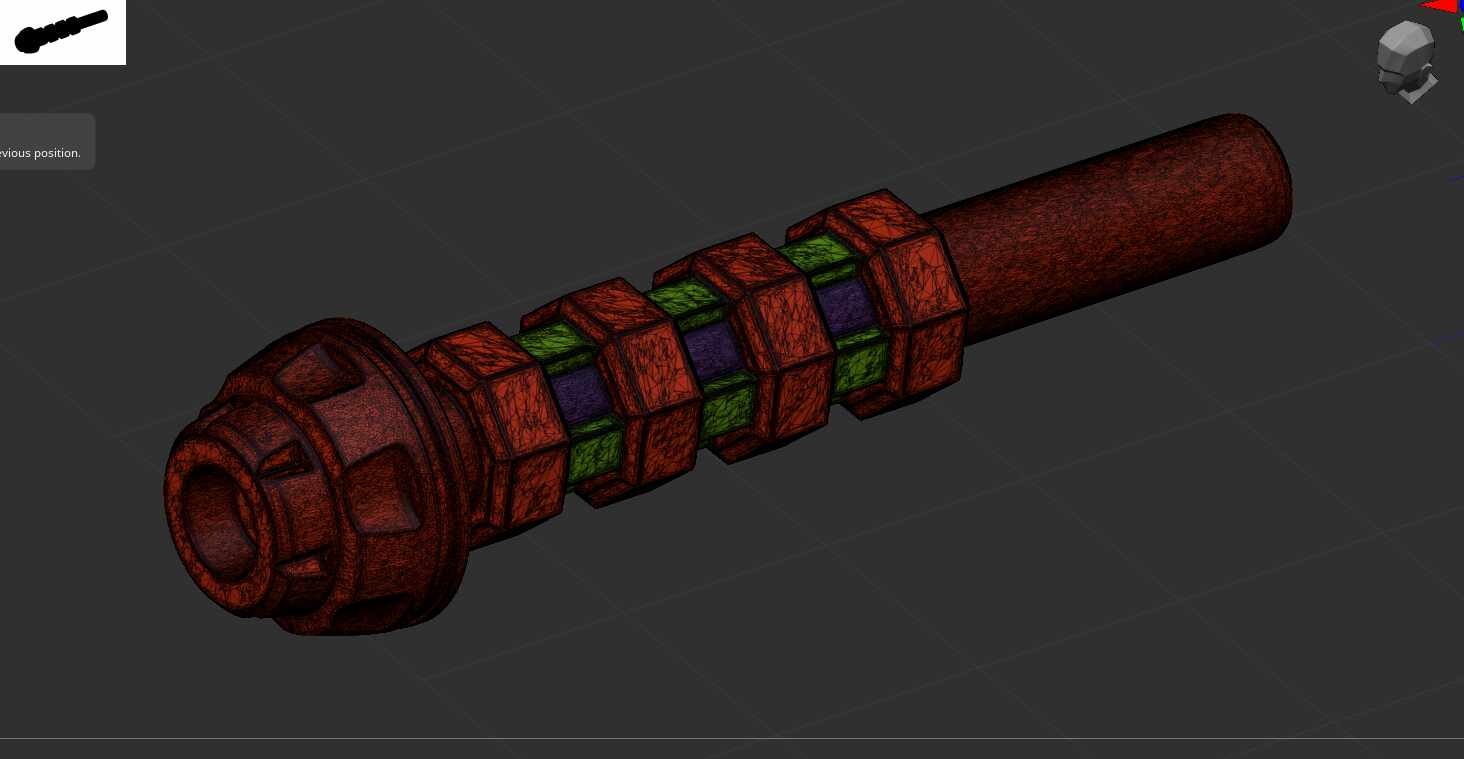

Dynameshed Model:
DynameshedPort

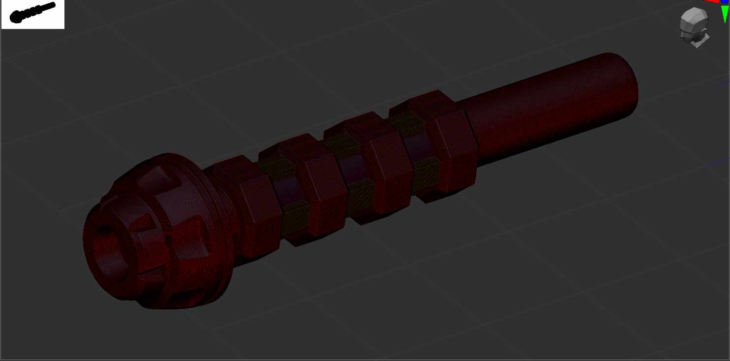

Decimated Model: - everything looks okay, but hitting F removes the tool from the visible document and the tool itself must be redrawn onto the screen. Hitting F at anytime displays an empty document though the tool is still active.
DecimatedPort

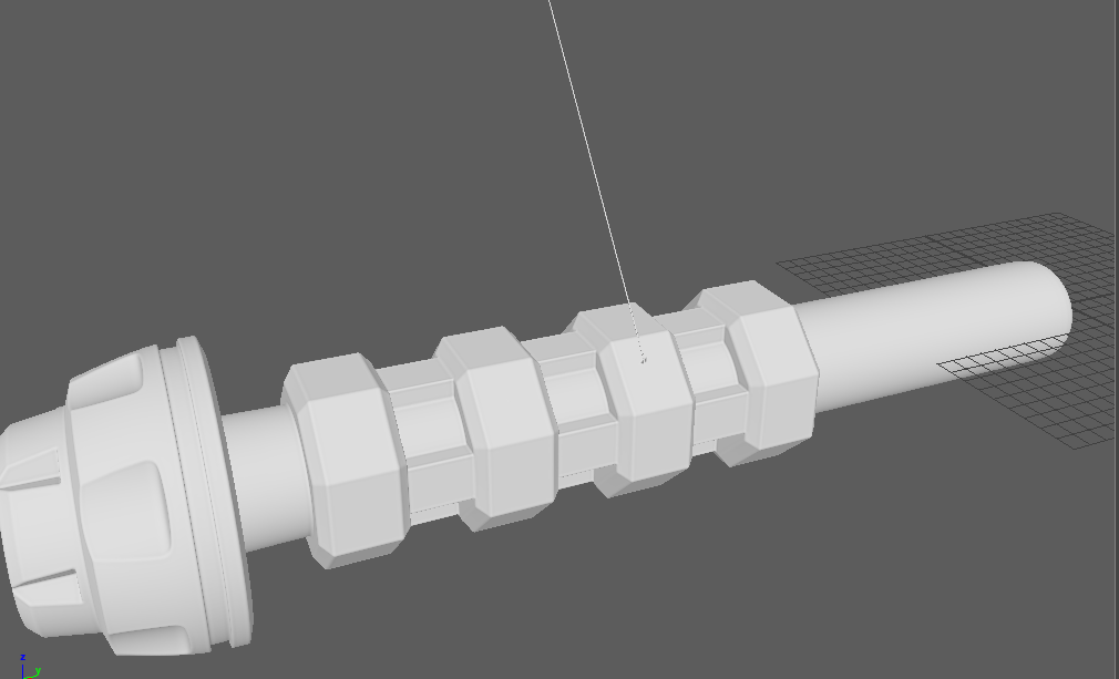

Imported Model: - notice the faces stretched by the exploded vertex
DecimatedPortImported

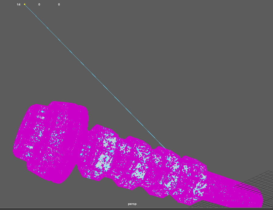

Component mode to find the elusive vertex: - camera clipping had to be set to 100000000.000 just to locate the vertex in the viewport
VertexLocation
