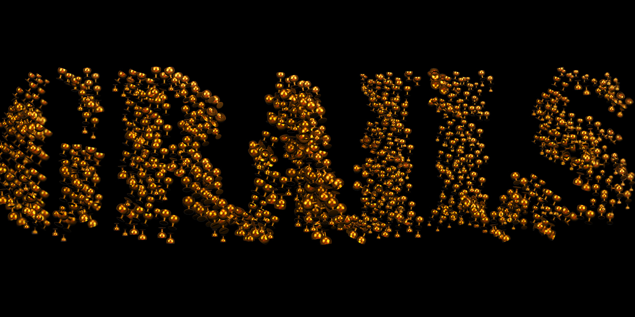

Here’s my first test of this process. the basic idea was i wanted to make the word GRAILS using …well… grails… and i think it came out pretty nice for a first try and shows just how much potential the zsphere mesh insert function has towards outside the box thinking :
