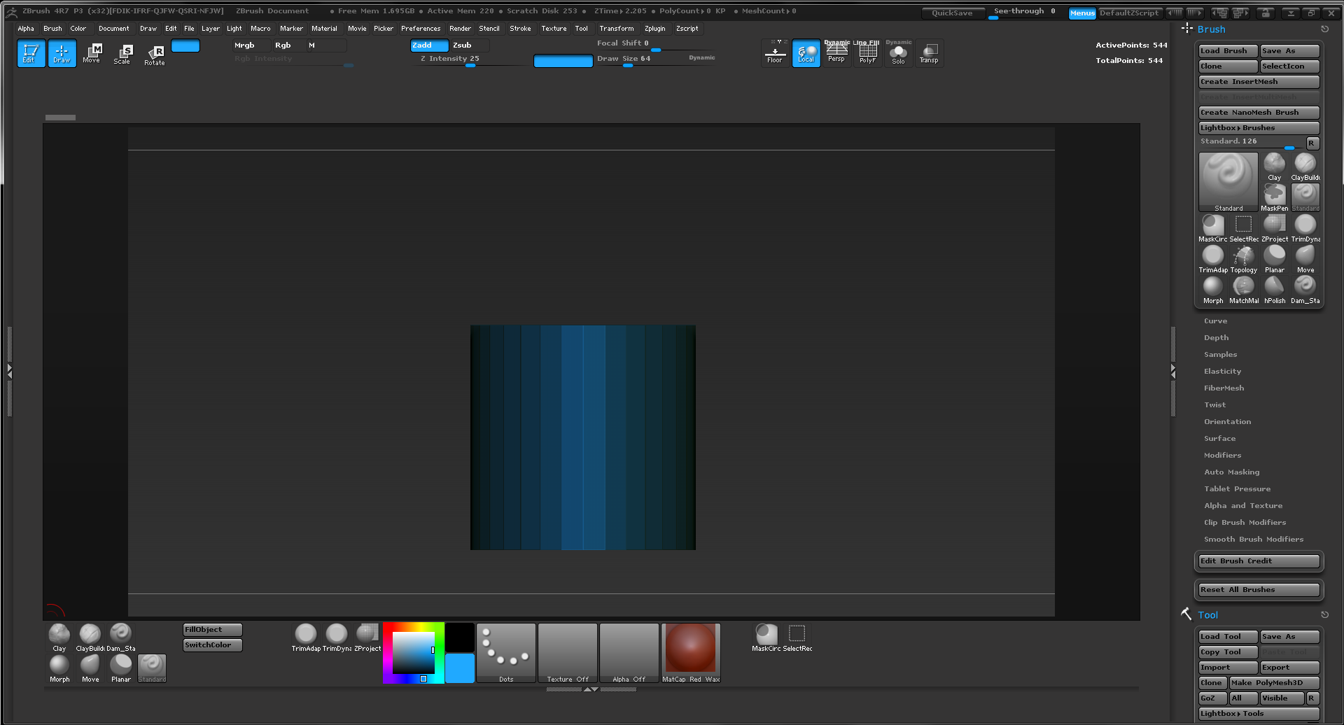

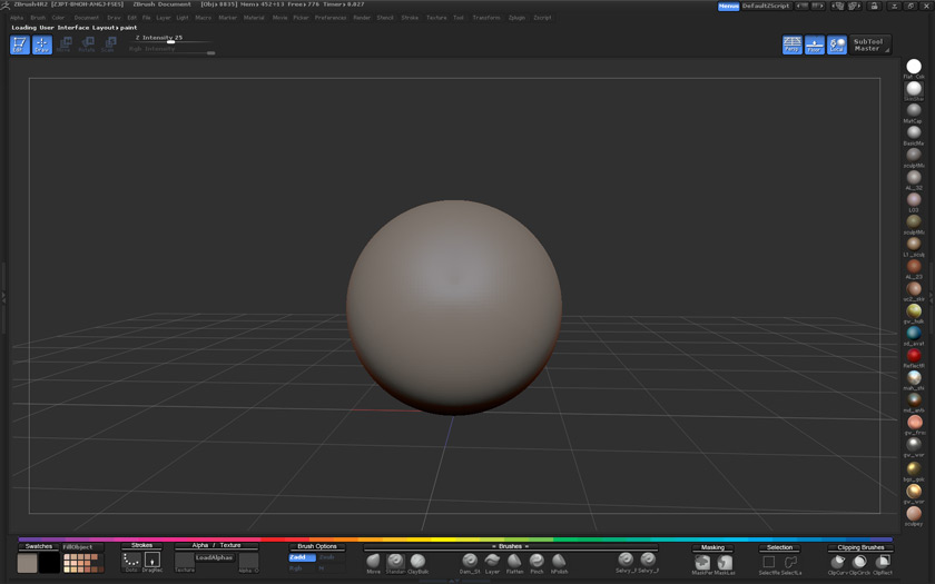

[FONT=arial]What’s the process of adding in custom png’s like this color swatch? I came across Cryrid’s UI a few days ago over on Polycount. He posted the script but I couldn’t get it to load so I figured I’d just try making my own. This is what his looks like.
Thank you for any advice!
Cryrid gives his code in this thread:
http://polycount.com/discussion/90444/zbrush-custom-ui-showcase
