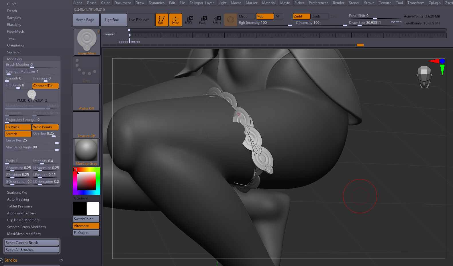

I made the model and created the IMM brush for it. I then went and enabled curve mode and adjusted the settings so it’ll actually wrap around the mesh (rather than just placing iterations tangent to that point). However, no matter what I do the imm mesh does not want to wrap around the mesh how I want it to.
It’s just a fancy leg band. I’ve tried the same mesh from 4k polys to 30k polys and the problem persists. If I increase the max bend angle, it will wrap better around the model, but the tilt will be WAY off. If I turn it down it looks like it would actually conform to the model but for some reason the mesh is WAY transposed. Has anybody experienced this before?
Image attached at max curve. The circles are supposed to lay flat around it but it’s doing… that.
Messed Up Curve
While dragging the curve, hold SHIFT, and drag beyond the mesh. The curve will automagically snap around the limb, completing a loop. Move the pen tip to adjust the position. Then tap on the curve to apply the IMM, or it may appear immediately after placnig the curve. Try it out with the CurveSnapStrap brush. Adjust the Depth that the IMM imbeds by adjusting Brush:Depth:Imbed. (Actually I think curves can be twisted intentionally as well but I can’t recall how).
Another alternative, with perhaps more control, is to create a ZSphere chain and use that as a guide for a curve. ZSpheres are easy to place and can be twisted too if required. Once you have your curve apply your IMM. Check out this video from Michael Pavlovich ZSphere Curves Helper. btw - I’d recommend his Intro to Zbrush playlist if you’re learning Zbrush.
