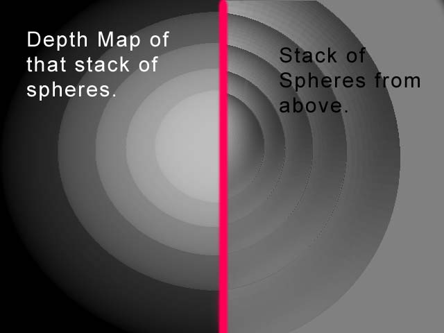

I got one more question though…how did you make the last render pass in the row? (the 4th from the left in the 1st image, 3rd from the left in the 2nd) What material, etc was used?
And, here’s to show i’m a real rendering noob, what is that pass even called? :o
It’s the ‘Depth’ pass. You can do that using the tool ‘MRGBZ Grabber’. When you select that tool you can draw a rectangle on the canvas and all the depth information in that rectangle is converted into gray scale values and is stored as alpha in the list of alpha images.
All rendering systems I had my hands on can generate this path. It’s always useful if you want to create an effect which is distance/depth related. Like fog, haze, depth of field, light intensity, a gradient. OR if you do a composite out of two pictures you can use this information to mask away parts from one picture/render which would be obstructed by elements from the other picture/render.
This map does not require the application of a special material. It’s a byproduct of the render process.
Hope that helps and I hope that’s the map you meant.
Lemo
PS:Black value = as far away as possible , white = as close as it get’s.
[attach=49630]ballstack.jpg[/attach]

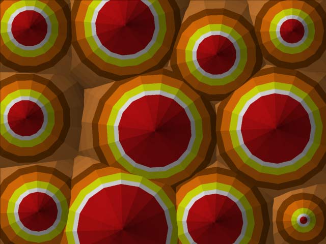

Sample: Every color is on it’s on depth layer using the picker on Z-Once and a Z-Tollerance of 0.3. The brush is a single layer brush, single stroke, and flat alpha. Variations are plentiful and yield very interesting results. I am sure it’s a cool weapon for manual fog with lower color intensity settings.

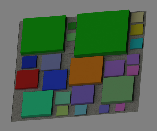

Another great use is to lock the depth to paint a grout into a tile floor and then the tile colors on top without ruining the grout…
Quick and dirty depth limited texturing sample (2 minutes total):

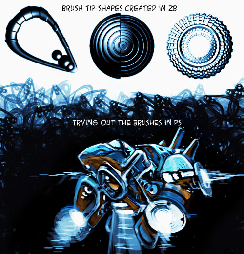

So I decided to try their brush utilization techniques in combination with the magical capabilities of ZB in creating particle forms (base forms from which larger and complicated constracts are composed).
I created a couple of those base particles using masked primitives. I then randomly sprayed them on the canvas, creating chaos, until I shaw a form emerging in my mind’s eye. I painted over that form to bring it out.
This is a super ergonomic way of working concepts. It is fast, fresh, and sponteneously creative. It is a true way of exploring concepts and designs, because the only thing that you begin with is a focused intend in finding the forms you need.
Once the form was out, I took the image to photoshop. I created brushes from the ZB particles, and I finished the painting there.
