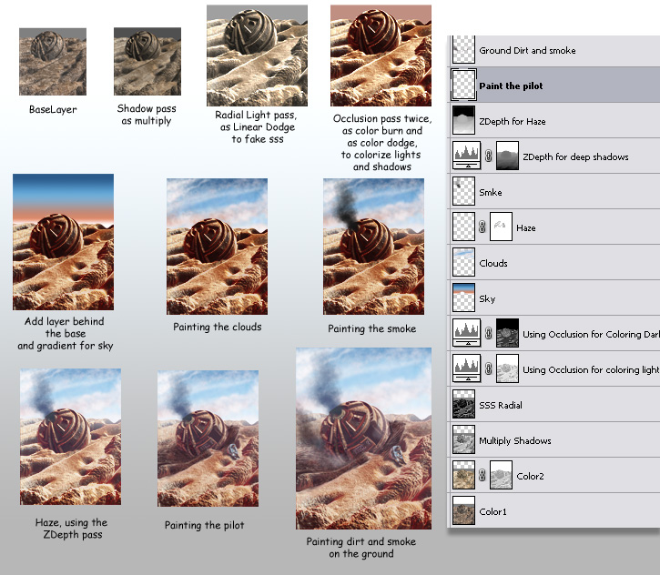

Same technique again, displacing a plane and also a sphere primitive with one of the default tecxtures in ZB. The creation of distant shots with ZB is intriguing. This went faster too. Here is my layer composition too.
Total time: 1 hour (about 15 minutes in ZB and 45 in PS).

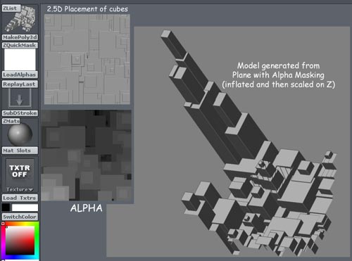

Another experiment. This time, I generated the model from a masked plain which I then converted into a Poly3D.
I also created adaptive UVs in ZB but I rendered it with Modo.
This is an occlusion rendering. Glows, colors, grunge and dirt were added in Photoshop.
Time without rendering: 20 minutes.
I rendered this at about 2500 px wide. So the rendering took another 20 minutes I think.

SCALED ON Z!!! hahaha… Now I feel like such a retard. I always ended up with flat results and could not find a good way with size and inflate, spherical…
LOL… Have to try that today. Thanks fir the hint. It’s so obvious, but I didn’t get it…
