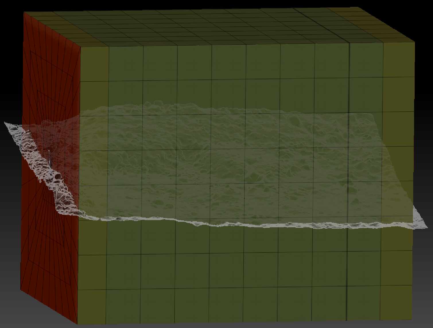

I have a photogrammetry model of a ground surface that I wish to add a base to. I have seen several tutorials for other softwares, but as it is a high poly count model it is dificult to use these (blender etc). I am somewhat familiar with Zbrush, but can’t seem to find the right method for this. I have tried adding a cube subtool and using boolean functions, but nothing seems to be happening. Are there any tutorials for this kind of operation?
To be clear; my mesh has 0 thicknes to begin with, i.e a single sided plane.

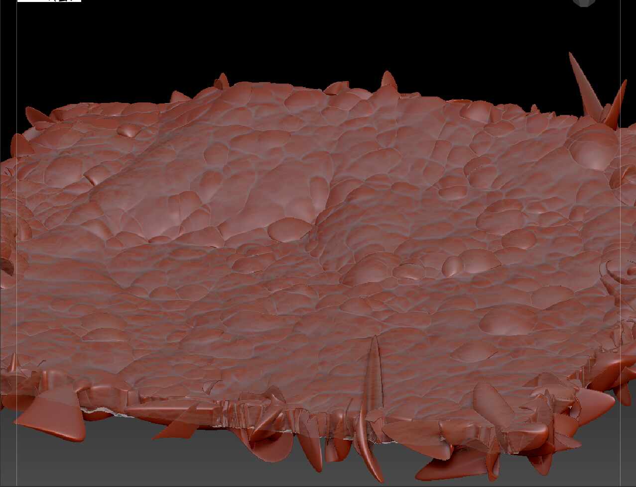

Thank you for the suggestion but it did not work for me.
Before:
Untitled
After:
image_2021-09-03_083557

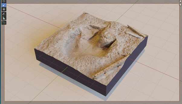

What I want it to look like is this:
image_2021-09-03_083713
The last image is taken from a tutorial for blender, but my high poly count made it impossible, and although it work when reducing poly count, the end result mesh had strange artefacts on the edges which made the model unusable.
“After” is when, after projection (step 4)? If so the projection looks weird. Can’t see how your before would not project.
