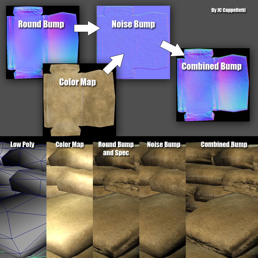

If you’ve ever wanted to combine a noisy bump based on the texture you painted with a smooth round bump that you generated from Zbrush, this is the sollution for you.
I finally figured out how to do this and I put it in an action. This will seriously speed up some of your texturing work. I’m sure I’m not the first to do this, but I’ve been looking for a while and never found anything this easy to use.
The picture below explains why this is useful. The example is of a sandbag. I sculpted the wrinkles and stitches in Zbrush. I painted the texture in Zbrush. I generated the smooth Normal Map. Then I used xNormal to generate a noise Normal Map to match the color map. (You can use the Nvidia filter in Photoshop also) Then I used my photoshop action to combine the two bumps.

[attach=82558]NormalMapCombiningDemo2.jpg[/attach]

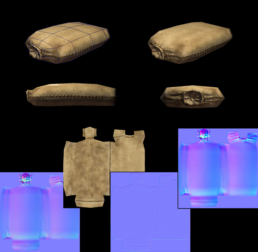

I’m trying to get all the kinks out of this action, but it seems to be just a little off every time I try it on a new model. Here is a picture of my latest test that I got to work. I added a STOP at the end of the action explaining the final tweak and how to make it work consistantly.
Basically, the flat blue color of the normal map has to be RGB 127,127,255. If it is even off by one number, you will see problems at your UV seams. This has always been the problem and the reason why you can’t just blend two normal maps with a simple blending mode in Photoshop.
