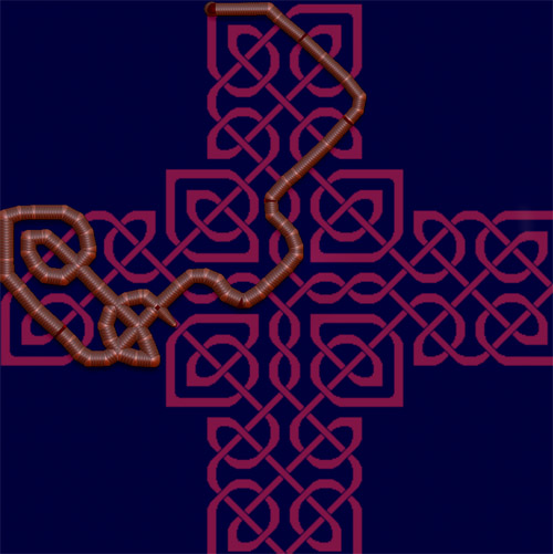

  6. Select the zsphere tool from the tool palette and draw a small zsphere at your desired starting point. (Now is a good time to go into Document>Zapplink properties and press FRONT to keep the position of your design in memory in case you accidently rotate it out of position. Press this key to restore it the saved positon.)
  7. Press the Edit button and with LMB held down draw another zsphere to the side and connected to the first one. As you continue to hold down the LMB and are drawing out from that second zsphere tap the CTL key twice quickly. If you do it correctly you will see a bunch of connected zspheres being drawn out in an even diameter. This zsphere “string” follows your drawing stroke (how long is this string? Hmmm, I’m not sure…let’s torment Marcus with this question!:laughing: ).
You may have to practice this technique bit to get the diameter you want. It’s a bit tricky, but not too difficult. Keep practicing. Even I can do this.
  1. Follow your design along “drawing” with this string of Zspheres. If you hit a sharp angle be sure to hit Ctl to tack down another Zsphere to help form the angle. This method creates a lot of zspheres all by itself, but be sure add spheres at sharp angle points and at all the MANY intersections. Also its easier to just complete the design in one go, but if you need to stop and start, you can. It’s just a bit tricky to restart the string and maintain the same diameter. It may take a few tries. CTL Z is your friend here.

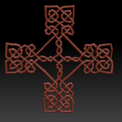

  2. When you’ve completed your design the next step is pushing in and pulling out your intersections to create the lovely woven effect. Over under over under, etc. This is why you need zspheres at the intersections. If you’ve forgotten a few, no worries. In draw mode you can click anywhere along the “string” to add a zsphere, it’s just an easier workflow to add them while drawing out the design in the first place. Mostly you want to be in “move” at this point and returning to “draw” gets confusing.
  3. If you like you can now remove your reference photo by pressing CTL N. You are going to be tilting the design a bit to work on both sides of it when pushing and pulling the zspheres so you don’t need the reference anymore.
  4. You must be in Move (transpose>move shortcut key W) to manipulate the zspheres. Its critical that you lower your brush size to the smallest size so you will just influence the selected zsphere and not the surrounding area. Also take care to click RIGHT IN THE MIDDLE CIRCLE of the selected Zsphere. Otherwise you will rotate the whole design and go insane. I’m making it sound scarier than it really is, but trust me…you just want to take care and only move the zsphere. Remember CTL Z to undo is you friend…you will need it.
  5. As you go along save frequently. If you need to reload your tool, don’t panic if you don’t see the zspheres. Just hit Edit and then the A key to get back to the zsphere mode.

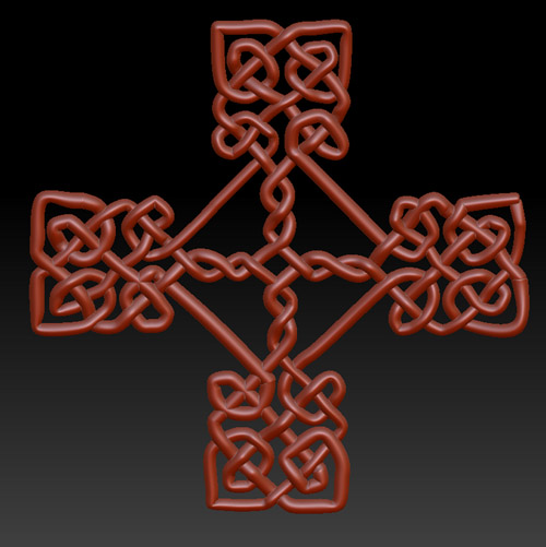

  6. At any point you can toggle the A key to see what your design will look like with Adaptive skin.
  7. That’s pretty much it. I don’t think it’s more mind-numbing then retopology…actually it’s kind of fun. Like knitting or darning a fishing net. Put on some music and weave away.
  8. When you are done and you have tweaked your design to your satisfaction go to Tool Palette>Adaptive Skin> press Make Adaptive Skin, but first adjust your density slider to how finely divided you want your mesh. You can play around and go back and forth hitting the A key and sliding the slider to figure out what you like and you can make as many copies as you want with different settings. Your adaptive skin model(s) will be in the tool palette and will have the word SKIN in the name so you can find it.

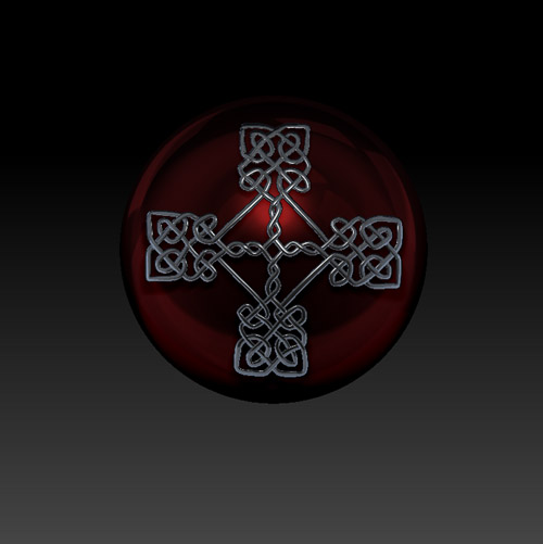

With this technique you won’t get the really beautiful and “perfect” results that JMeyer achieves by modeling his knotwork in Wings3D, but for those who don’t have modeling skills, this is a decent option. Note: I used the fantastic “Matchmaker” tool to conform the design to a sphere . I just LOVE that tool!
