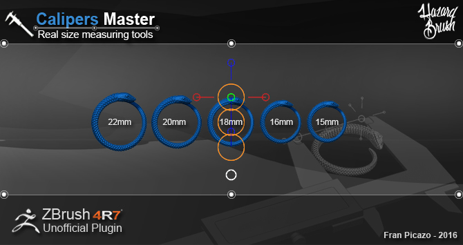

Calipers Master v2. Real size measuring tools. Unnoficial Plugin
Hi ZBrushers,
I´m very happy to announce thatCalipers Master v2 unofficial plugin has been released!
The main purpose of this plugin is to boost Zbrush artists productivity when designing any kind of project for 3D printing or prototyping. In this version I´ve added many new tools and features I hope you will find usefull.
With this version of Calipers Master you can:
  • Set any size and unit while working on zbrush friendly sizes (e.g. Unify or imported meshes).
  • Set Caliper with two clicks (Set start point, set end point) to increase your precision when measuring wall thickness etc..
  • Bounding Box Utilities
  • [LIST]
  • Bounding Calipers. Easily depict the bounding box size on any axis. (Visible or All options available)
  • Calibrated XYZ Size. Update and Resize your subtools with real size measurements and units
  • Constrained Modes
    • X Y Z constrain modes will force your calipers to follow the X, Y or Z axis
    • Distance Mode. Next Calipers will start from the last ending point. Ideal to measure curved surfaces
    • Bone Caliper. Set a caliper using the last two calipers center points. Ideal to find pivot centers for non symetrical objects
  • Real Size Brush. Set your brush size based on real units. ideal for IMM brushes
  • Calibrated Extraction / Create Shell. Extract and Shell objects in real size thickness measurements
  • Duplicate and Resize. Easily create iterations on different sizes. Also special Copy and Paste functions to bring objects to your scene from other available tools in the right size.
  • Caliper to Mesh function to replace a Caliper for a QMesh or IMM object right in size and place.
  • Subtool Repositioning to easily repose any subtool with Initial and Final Calipers. Object will "follow" the Calipers.
  • Display Measurements. New display that also converts your measurements into other units
  • Export with shrinkage factor. No more surprises after mould casting sizes!
  • Calibrated DynaMesh. Depict with a caliper the polygon size you want the DynaMesh to have insted of trial with the resolution slider
  • [/LIST]
