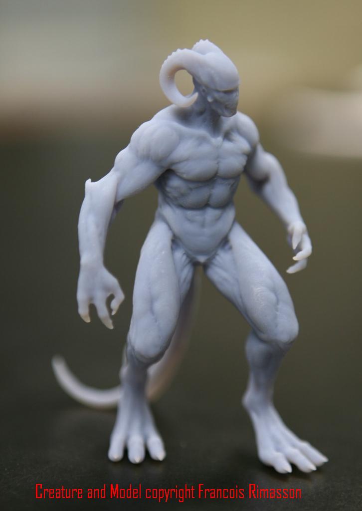

Another source for Printing out your 3D Models if you are in Southern California is:
<b>Here's an example of their work:</b>
<b>I've had a few pieces created there and was Amazed with the results!</b>

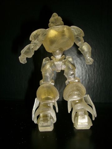

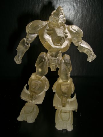

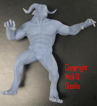

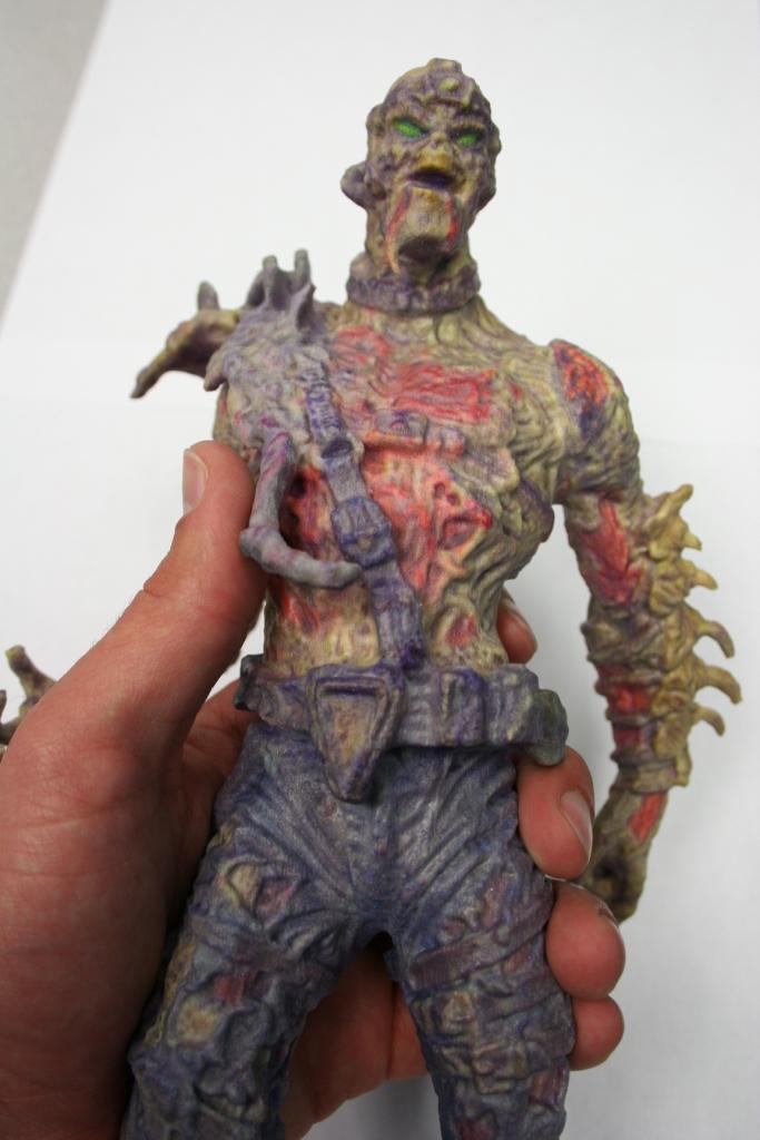

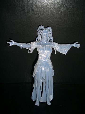

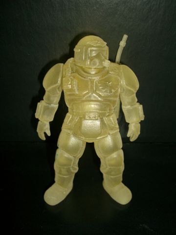

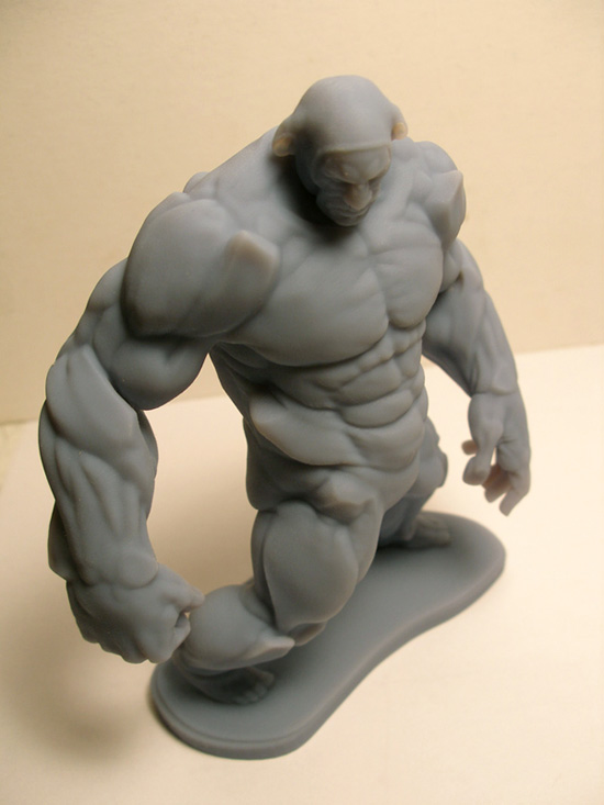

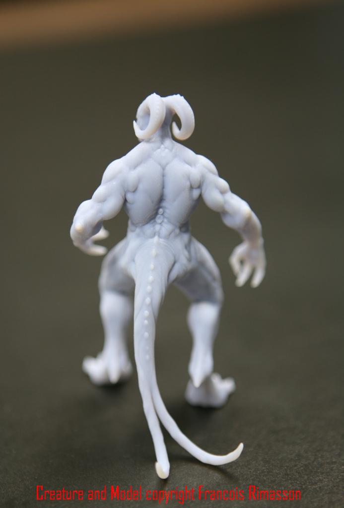

GROWit is a rapid prototyping, now better known as Additive Technologies Company in Southern California. We have been working on new ways of creating less expensive, more accurate, custom avatars and models for people all over the world and have come up with some great solutions. We primarily use Polyjet and Z-corp for avatars for many of the same reasons that have been mentioned, but we also offer SLS, FDM, SLA, and a new great metals process called Direct Metal Laser Sintering (DMLS).
Here is a bit of the work that we have done.
Attached is the document “The Basics of Growing 3D Models”. We have been continuously modifying it to help with preparing files for additive technologies.

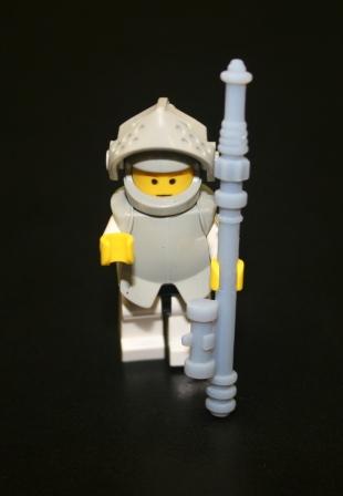

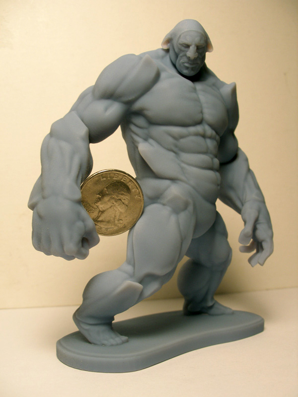

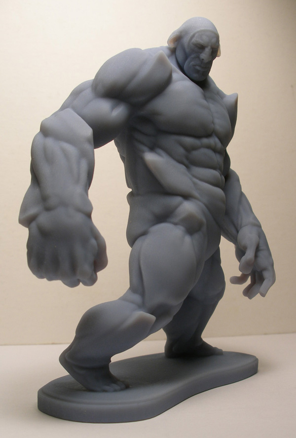

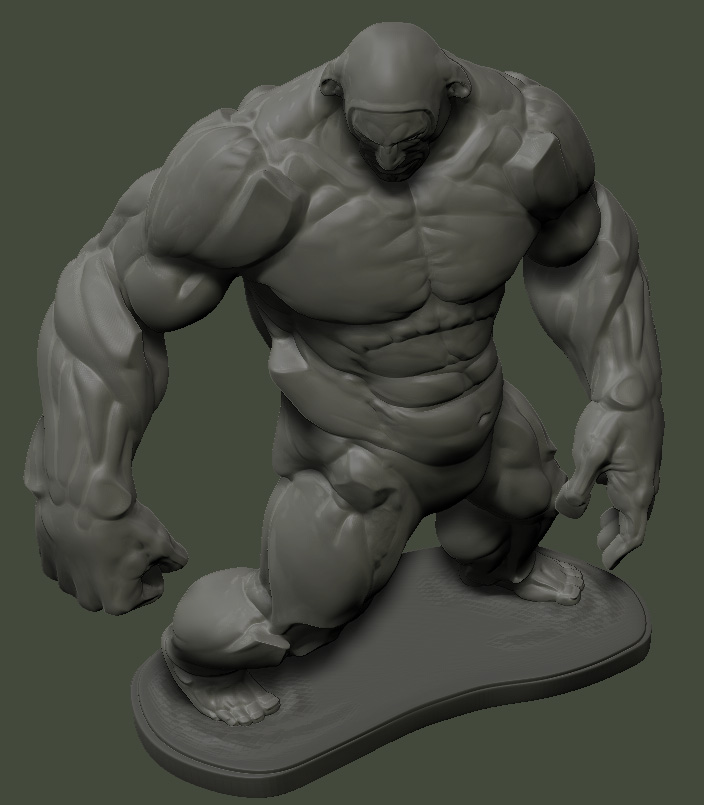

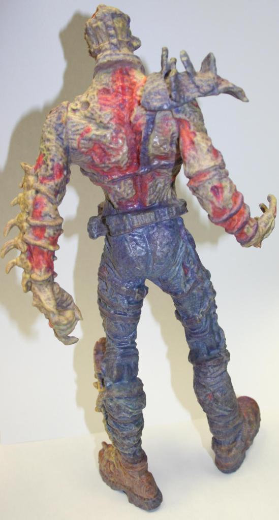

I had my zbrush model sent out to be made into a physical piece.
The images here are of a 5 inch tall prototype. This print was made by the guys at Growit3D.
http://www.growit3d.com/
Contact: David Gurrola
Let me know what you think. I am more than satisfied with this piece!
-Jeff
The Print:
This is the link to my sketchbook thread with all associated pics.
http://www.zbrushcentral.com/zbc/showthread.php?p=466039#post466039
I hope you like the work. Growit3D did a great job. I had the print in my hands in one week after I sent out the approved obj file. Super clean print!
Have you cleaned the model by yourself?
If I can ask you: how much does it cost?
There is some mistakes with the base of the model, near the feet, the corrispondence with the Zbrush Model is missing, isn’t it? But it’s s a small detail…
Anyway did you think to paint it?
Bye
