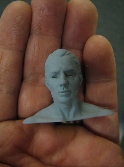

Objet Polyjet 3D Printer
Resolution/Accuracy: 600x600 dpi (.0015”) X&Y, 1600dpi (.0006”) Z layers (.0012” on High Speed setting) per inch
Max Single Build Size: 19.3"x 15.4"x 7.9" (larger models can be built in pieces & reassembled
Pros: Highest resolution & accuracy available. Variety of materials & color options.
Cons: Consumable support material adds considerably to cost. On smaller models it is not an issue but become prohibitive as the parts get larger. Solutions are: to cut the model into pieces to help facilitate laying them flatter against the tray for building which requires less support material, Shelling the models so they are hollow (.030”-.100” wall thickness appropriate to model size) then splitting them into halves so the can be built open saving material consumption. These operations generally need to be executed in another program as ZB does not have the tool set.

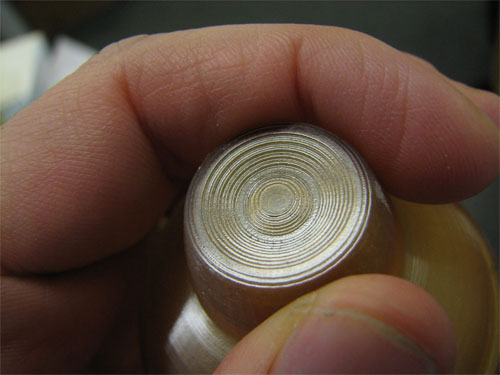

SLA (stereolithography)
Resolution/Accuracy: +/- .006” in X&Y, .004” Z layers per inch
Max Single Build Size: 25"x 29"x 25" (larger models can be built in pieces & reassembled)
Pros: Economical larger models.
Cons: Much lower resolution than Objet Polyjet, “stair stepped” build lines, rigid supports that mar & chip the surface when removed. Limited material choices.

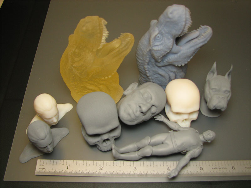

RP Process Approximate Cost Comparisons:
  • Prices in the industry can vary wildly depending on process, who’s trying to undercut whom, if the industry is busy or in a downturn, individual workloads at different service bureaus, quality of customer service, quality of product, delivery time requirements, etc.
  • Each model will vary in price considerably depending upon dimensional extents, volume, quantity of parts ordered, complexity of cleanup, if it’s to be built solid or hollow, material choices, print quality settings, etc.
  • Quantity can effect price significantly. The more parts you order at one time typically the lower the price per part.
  • Hollow parts are cheaper than solid parts obviously because of material consumption. Beware when comparing Objet quotes with SLA quotes that they are both quoted for either solid or hollow. You need to compare apples to apples so to speak. Hollow parts could be as much as 50% less on larger models
-These prices do not include CAD time for repairing, converting, combining subtools, shelling, cutting, etc.

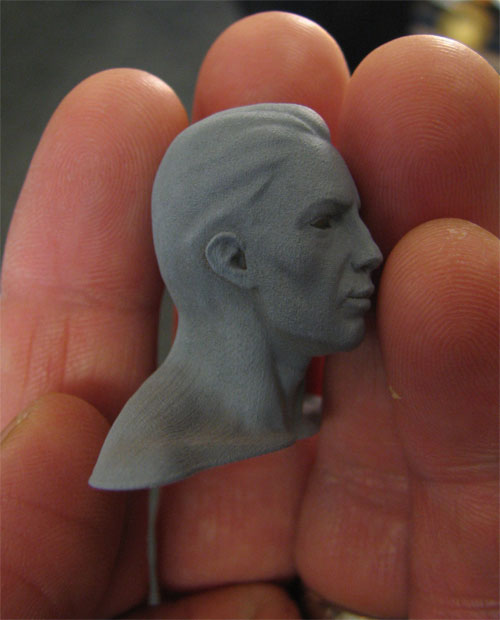

The approx. cost for the “Demo Head” Zbrush tool file @ approx 1mil polygons is as follows:
1.3" tall (approx. 1” from tip of nose to back of head)
Objet Polyjet 3D printed model “High Quality” (.0006" layers): $100 (solid)
SLA Model (.004”-.006” layers): $130 (solid)
CNC Machining/Renshape Urethane Board (+/- .002” or better in X,Y,Z): $425 (solid)

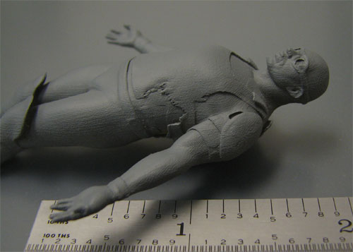

3.1" tall
Objet Polyjet 3D printed model “High Quality” (.0006" layers): $135 (solid)
CNC Machining/Renshape Urethane Board (+/- .002” or better in X,Y,Z): $450 (solid)
