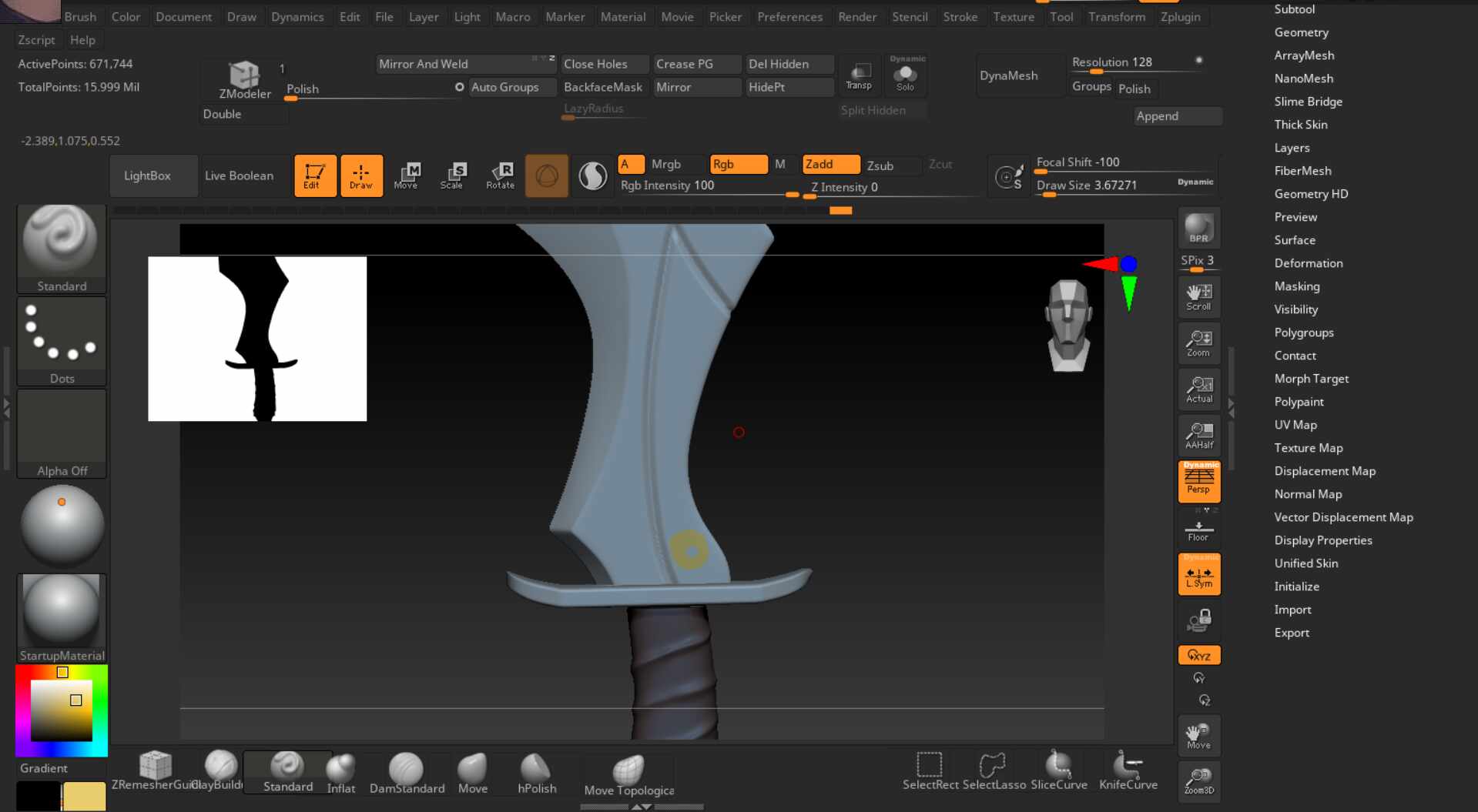

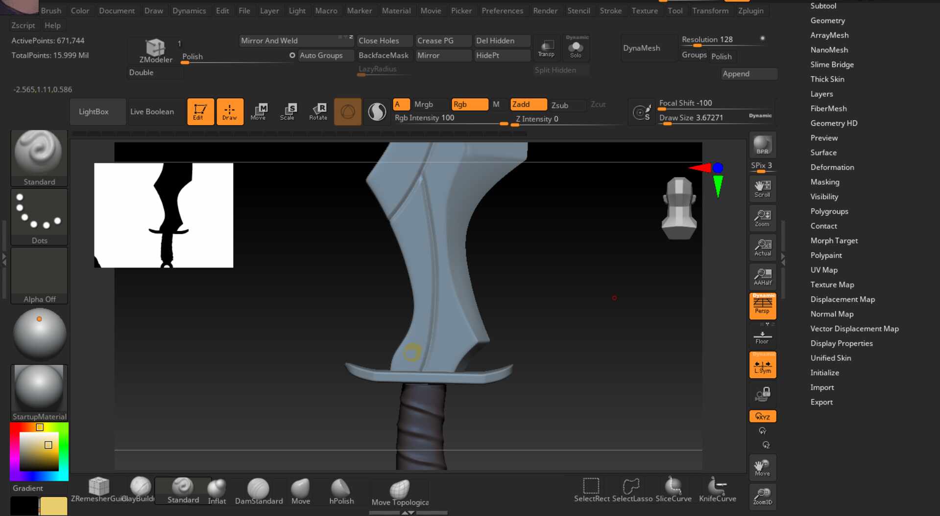

I think when I was rotating the mesh at some point I rotated it to a not perfect angle, now the symmetry is a bit off. Not critical, but in some places it is noticeable that the symmetry is not perfect. I tried variations with local symmetry, set pivot, didn’t work. How can I get the symmetry back?
