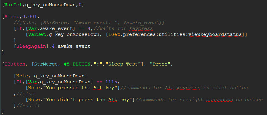

Branch Execution Code based on Mouse Button
Is it possible to run one of set of commands when a user presses a button with the RMB, and run another set of commands with a LMB click?
Or maybe a CTRL or ALT click, like ZRemesher?
You can do it with Modifier keys. See this (rather old) thread:
http://www.zbrushcentral.com/showthread.php?22826-Code-Sample-Suggested-Zscript-Functionalities&p=189801&viewfull=1#post189801

Marcus,
Interesting, I had to modify your code a bit in order to get to it work for me.

Anyway… Here’s what I got working. I really like this method, because in theory I could have multiple branches (none, alt, ctrl, etc)
Well this keyboard status parameter is interesting. The IDs are different today, even within the same ZBrush session! :confused:
My ALT is no longer 1115, it seems to change (I saw 1024, 1037), and I’m not entirely sure when or why it changes. But it definitely is not consistent.
Marcus, what is this syntax that you used? I couldn’t seem to get it to run on my end:
((KeyOnMouseDown)&1024)==1024
1024 is the ASCII code for Alt, although as the keyboard status slider combines it with whatever was pressed beforehand you need to do a comparison using bitwise AND - the result of (KeyOnMouseDown)&1024) will be 1024 if keyOnMouseDown contains 1024.
