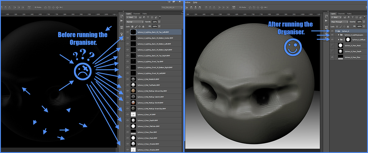

This is a Photoshop script that Organize all different layers coming from “BPRBatch” (Polydrawer).
!Read/look the Manual before using (HowToUse_BPR_CS_Organiser.jpg)! (Should work from CS3/newer versions)

Also thanks to TreeSnake for sharing the PS organizer. That is a must have with this plugin. :smiley:
