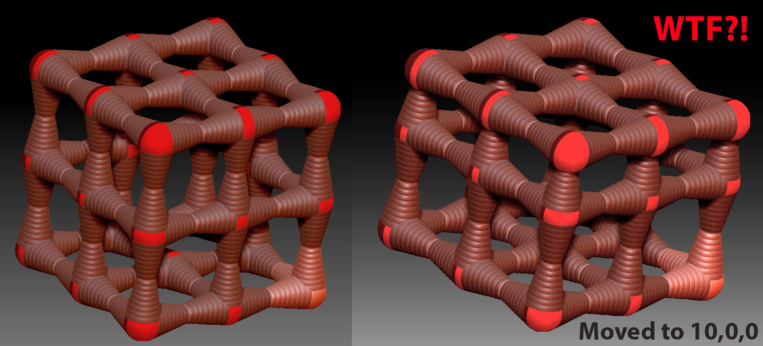

I tested ZSpheres too though, which Zscript allows you to move around and add child spheres to after you script interface actions to create a a fresh ZSphere in a subtool. However, coordinates from Rhino, normal XYZ coordinates for as simple cube mesh turned into wires that I make each vertex become a separate ZSpheres tree reaching out to the middle of each line, depending on where I move my 20x20x20 unit cube in space, even +10 in X, the side of the cube comes quashed down like it’s hitting a wall and maxing out.
Do I need to scale down to 1/10th or stick within +/- 1 units from 0,0,0?
Indeed if I scale down from a 20x20x20 cube to 1/10 that, I can then safely move it +3 in X, the equivalent of +30 before. So I guess this is workable, to just stay small in Rhino.
Moving +30 in X:

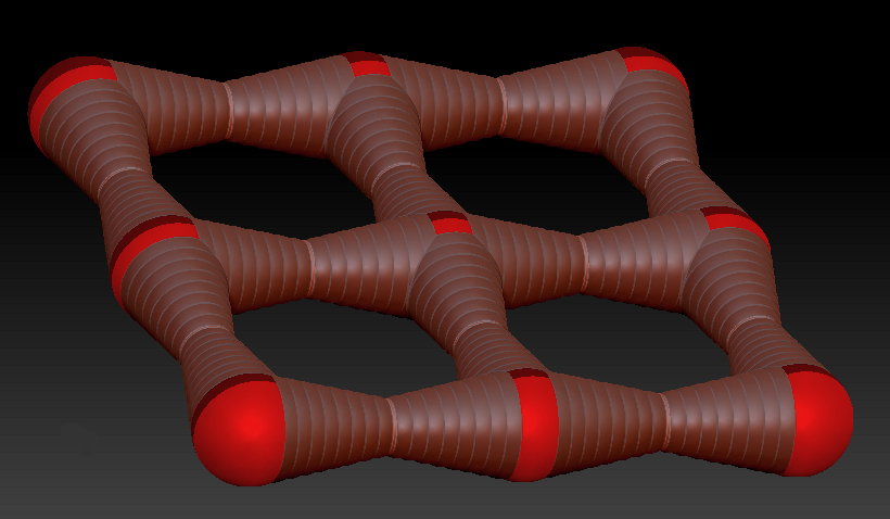

OK, staying within one or two units of the origin works:
