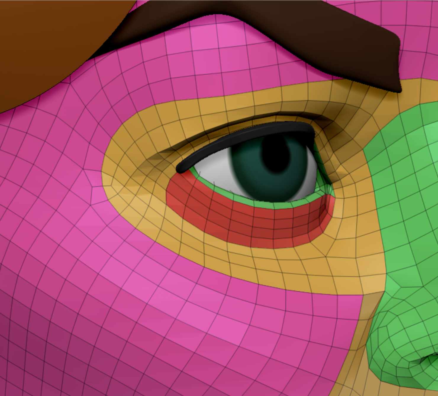

I always find it hard to put into words the issues I have. I should have mentioned that the style in question is a stylised face (images attached).
I guess what im ‘ideally’ wanting to achieve, is a mesh of the lower subdivision level shown here but when dynamically subdivided doesn’t totally smooth out. In a hardsurface world I guess you’d use supporting edges etc. to hold the edges. But failing adding the supporting edges by hand Im not sure of any way to do this. (in Maya I would use creases, I could do this in zbrush however the crease strength is uniform across the whole tool so it wouldn’t work :frowning: ).
Failing the above, im trying to find the best workflow to allow me to make sure I can get all the detail at the higher subdiv level, but without all the nasty bumps and lumps that arise when sculpting at that higher subdive (as seen in this higher sdiv image)
The only way Ive currently found is to jump up and down the sdiv levels and smooth, nudge everything into place on each . But this doesn’t feel very efficient (or effective) and I was wondering if there was a better way?

Dynamic Subdivision is intended as a low poly modeling aid, and will negatively affect performance if enabled for a high resolution mesh. I do not recommend this.
Subdivision levels are the traditional solution to this. As I have described above, if you have a multi resolution mesh you can instantly drop to the level of subdivision that is ideal for the frequency of detail you are trying to create. If you have a multi res mesh with 6 subD levels and sculpt the detail at about level 3, this would create coarser detail that will look smoother at higher subdivision level, without introducing any of the marks that would be picked up if you had sculpted it on subdivision level 6. Whereas subdivision level 6 would be appropriate for the finest surface detail.
So you might sculpt smoother, medium frequency details like cloth wrinkles on subdivision level 3, and the finest surface details like skin wrinkles and pores on subD level 6.
:slight_smile:
oh - I wasn’t suggesting having the dynamic subdive on the higher level, rather - on the lower level with some kind of supporting edges/creasing to hold detail with dsubdiv.
Your suggestion around what sdiv level to sculpt at is very interesting and makes me thing that ive probably often been doing things at a too higher subdiv level!
