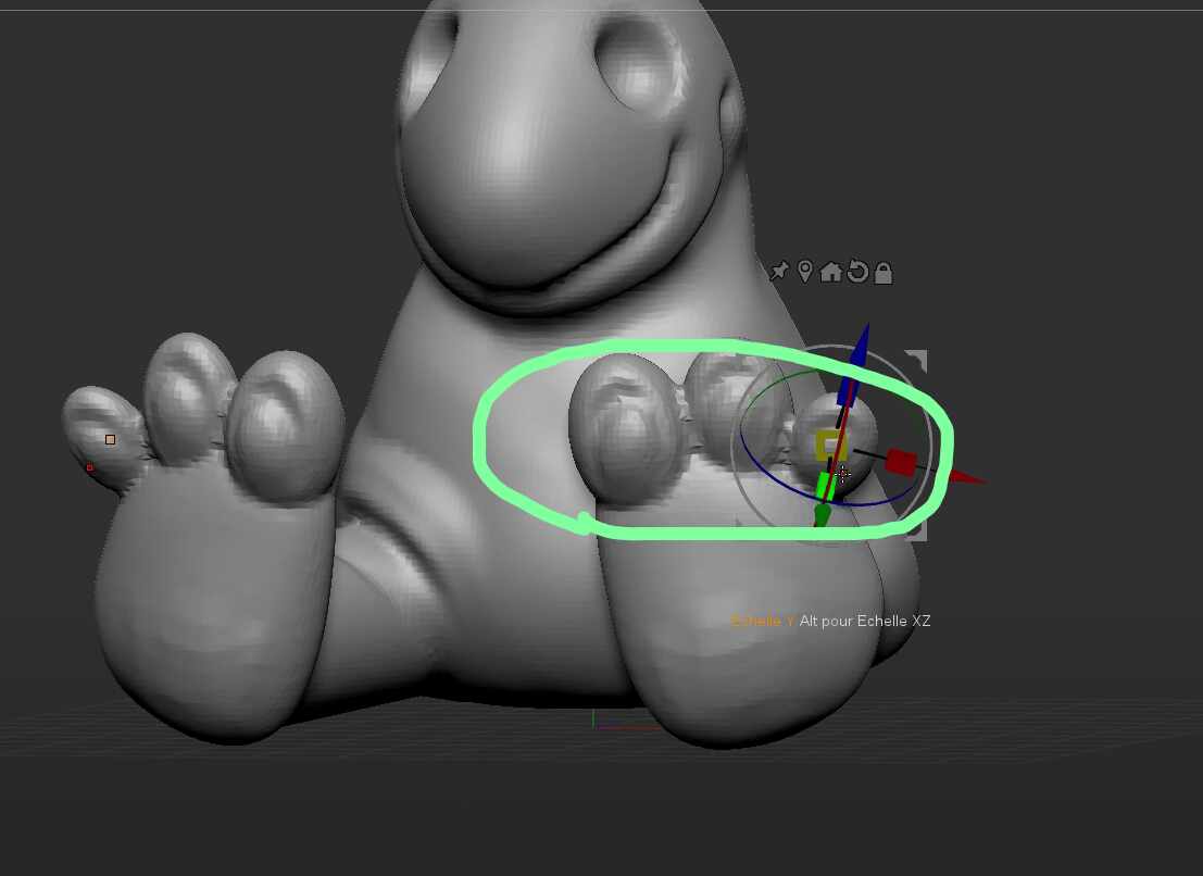

Hello, i am new on zbrush and actually watching a tutorial to learn the basic on zbrush. But i have a problem, at a moment, in the tutorial, the youtuber fusion fingers to a feet.
But on my side i only can turn off the mask.
This is actually what i got on my side.

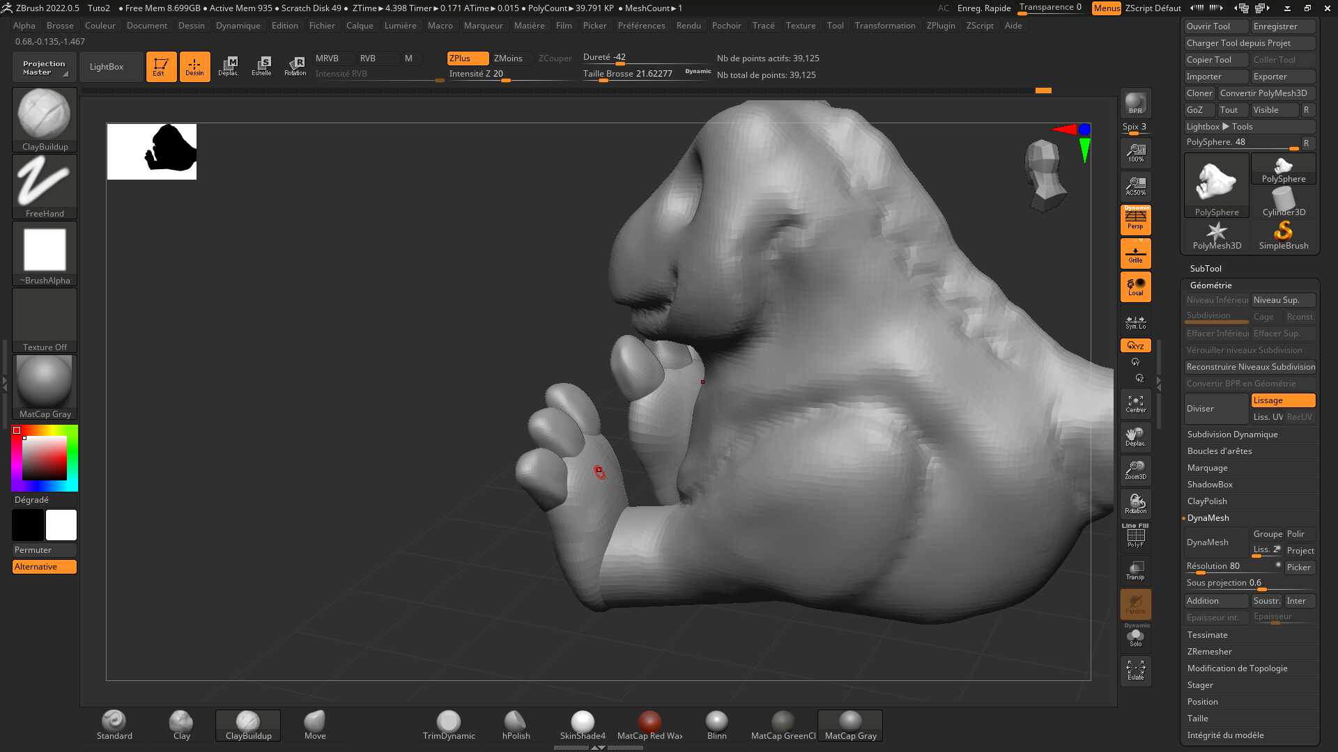

This is what i see on the tutorial on YouTube. He just refresh the Dynamesh
I did the exact same command, i also tried to manually do it but it does not work.
I have Zbrush2022
Hello @vGenede
Your DynaMesh is turned off. You need to turn it on.
