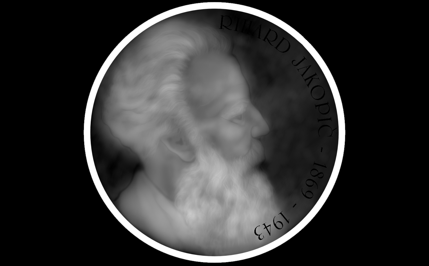

Please take these 2 examples:
This portrait of Richard Jacopic is 40mm in diameter. The model has a minimum sculpture height of 0.05mm, and a maximum of 0.25mm, so ALL the detail of the portrait, AND the sense of depth/ form have to be achieved within a ‘window’ of only 0.2mm. I have included the depth map, so you can see the relationships of each element.
If you were to make this model by slicing a 3D model, the ear, beard, and cheek would be much deeper than the nose, and front of the forehead. This would cause problems when scaled down.

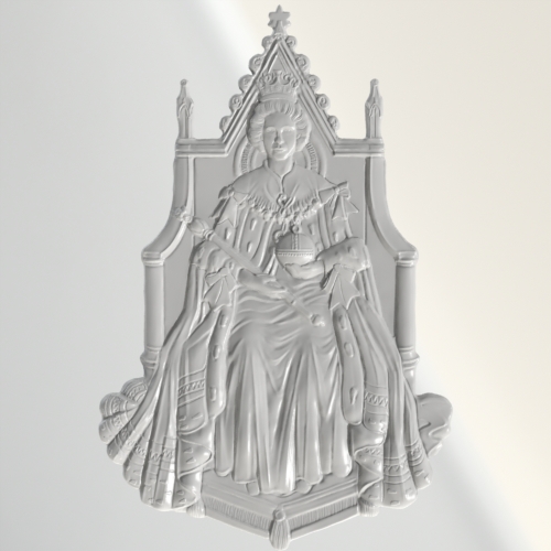

The same is true for this example. The depth of this model is much greater (1mm depth at the same diameter of 40mm), but the principle is still the same.
If this was a slice of a 3D model, the orb. knees and front of the throne would be much deeper than the rest of the model. In this instance, they are all approximately the same depth.

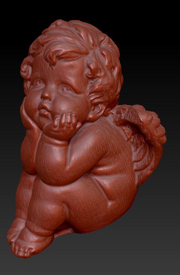

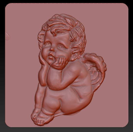

I want to contribute with respect to this topic, I have used the bas-relief method of a Russian that now I do not remember the name, it was necessary to use the blender program, then edit the image, the truth is a bit difficult, but I think it is harder to do the relief from scratch, see this photo of the 3D object:

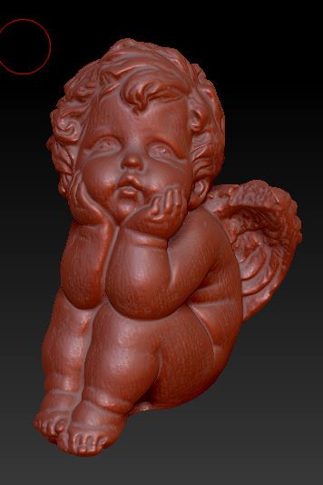

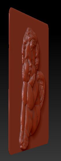

using the option “create mesh from alpha” the result is not good, you can see in the following picture:

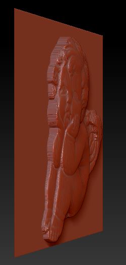

Using this other method the result is better but it is more difficult to do it:
