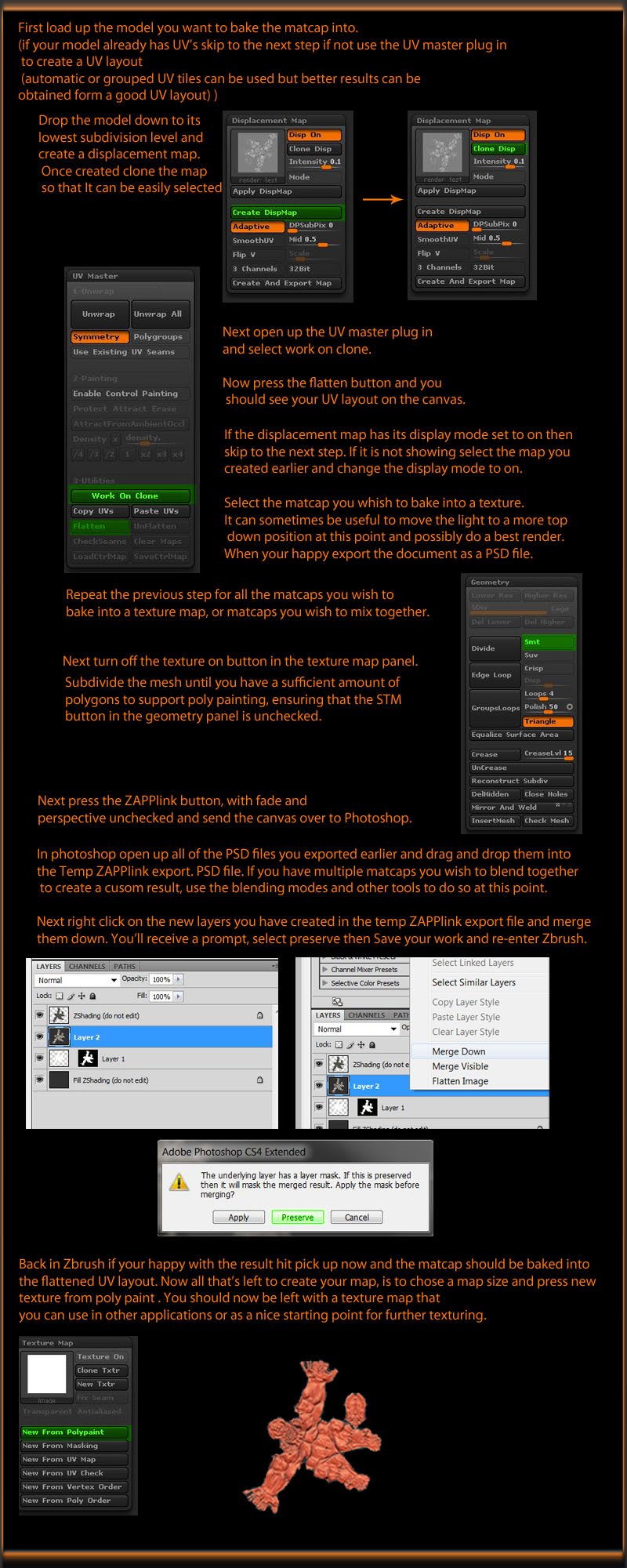

I love Zbursh’s matcaps but trying to bake them into a uv map for use in other applications or games can be quite a tricky thing. I’ve tried using the old ZApplink technique of sending different views back and forth to bake the shader info down into poly paint but to be honest I’ve always found this to be more work than its worth.
However I stumbled across a rather quick solution a few weeks ago whilst using the UV master plug in.
Ive not seen anyone else using this method so I thought id share it with you guys.
[attach=230765]matcap_bake.jpg[/attach]
I hope this proves useful for some of you.

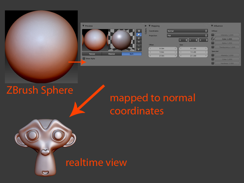

There’s a much better way to export matcaps to an external renderer and bake textures there.
see this from my thread, this is rendered in blender using the default copper like matcap.
http://www.zbrushcentral.com/showpost.php?p=702508&postcount=77
Just grab the matcap, export it. Then use it as texture (in blender in my case). Use the “normals projection” method for mapping!. Thats all. I can also bake it in blender and export a perfect map in zb for more painting if I like.

HD CG ADDICT, soulty666, these are great and useful methods with lot of possibilities. It depends on what we’re after. “My” method is simpler for exporting and rendering a matcap and maybe the “right” way. One disadvantage though. Cavity color can’t be exported like this, I have to either bake and export a cavity mask-map to use it as second tex of material or paint cavity in blender (just a click but with different look this time)

Im not 100% if this is the way Michalis method works so please forgive me if I’m wrong. But from his description it sounds like a sphere projection method.
You basically take a sphere inside Zbrush with the desired matcap applied to it. Drop it to the canvas and export the document as a psd file. Crop the image so that the edges of the sphere match up to the edges of the image. After this you simply apply the texture map to an object in your 3d application, setting the mapping coordinates to Normal.
This is a good way to recreate simple matcaps in other applications and can of course be baked into a texture map, by using blenders full render settings or similar baking options in other apps.
There is a bit of a down side to this however, with some matcaps its almost impossible to recreate an accurate representation of the original zbrush matcap with out a lot of tweaking of other material settings with in the external application.

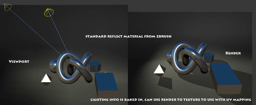

Quick screen grab of the standard reflected map material from zbrush.
[attach=231504]matcap-to-material-render-3d-max.jpg[/attach]

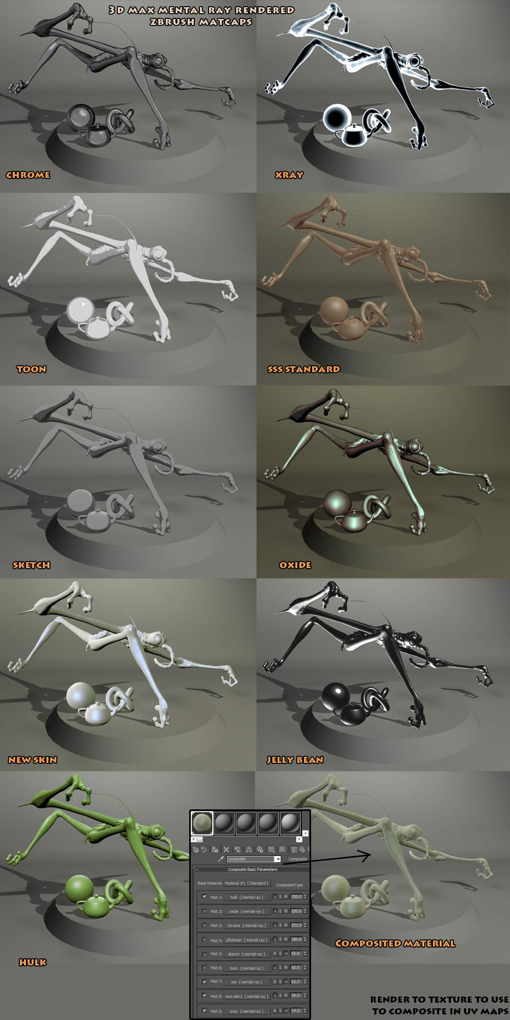

These are some renders from 3ds max of zbrush matcaps.

the directx method of max is similar to the ‘normal’ method of blender? It looks like.
@HD CG ADDICT
Yes, cavity is a problem when different color is used. But blender supports cavity painting also, or just export the UV cavity mask from zbrush and use it as masking texture. Easy to do it in tex editor of blender but even better with the use of nodes system.
A bit of downside to the zbrush baking method too. Having cavity and spec effects everywhere.
