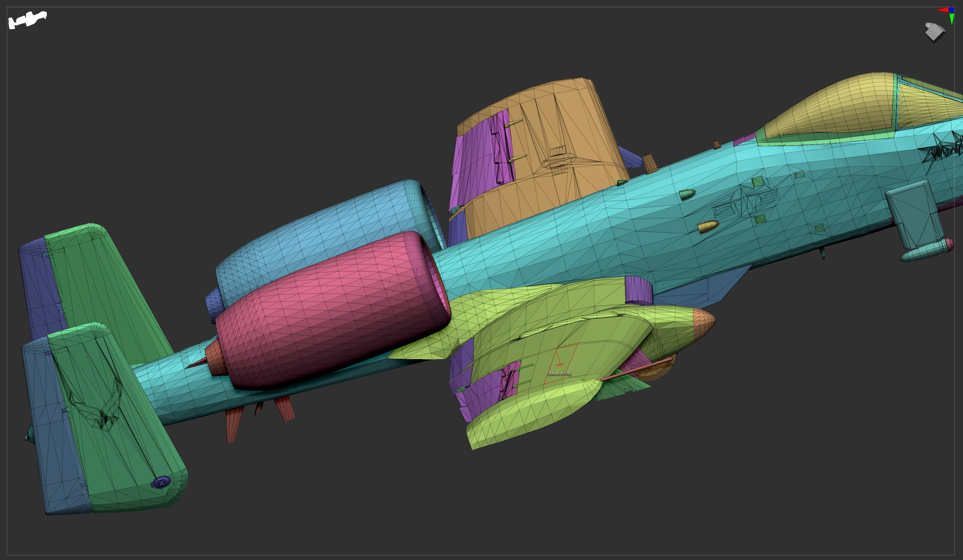

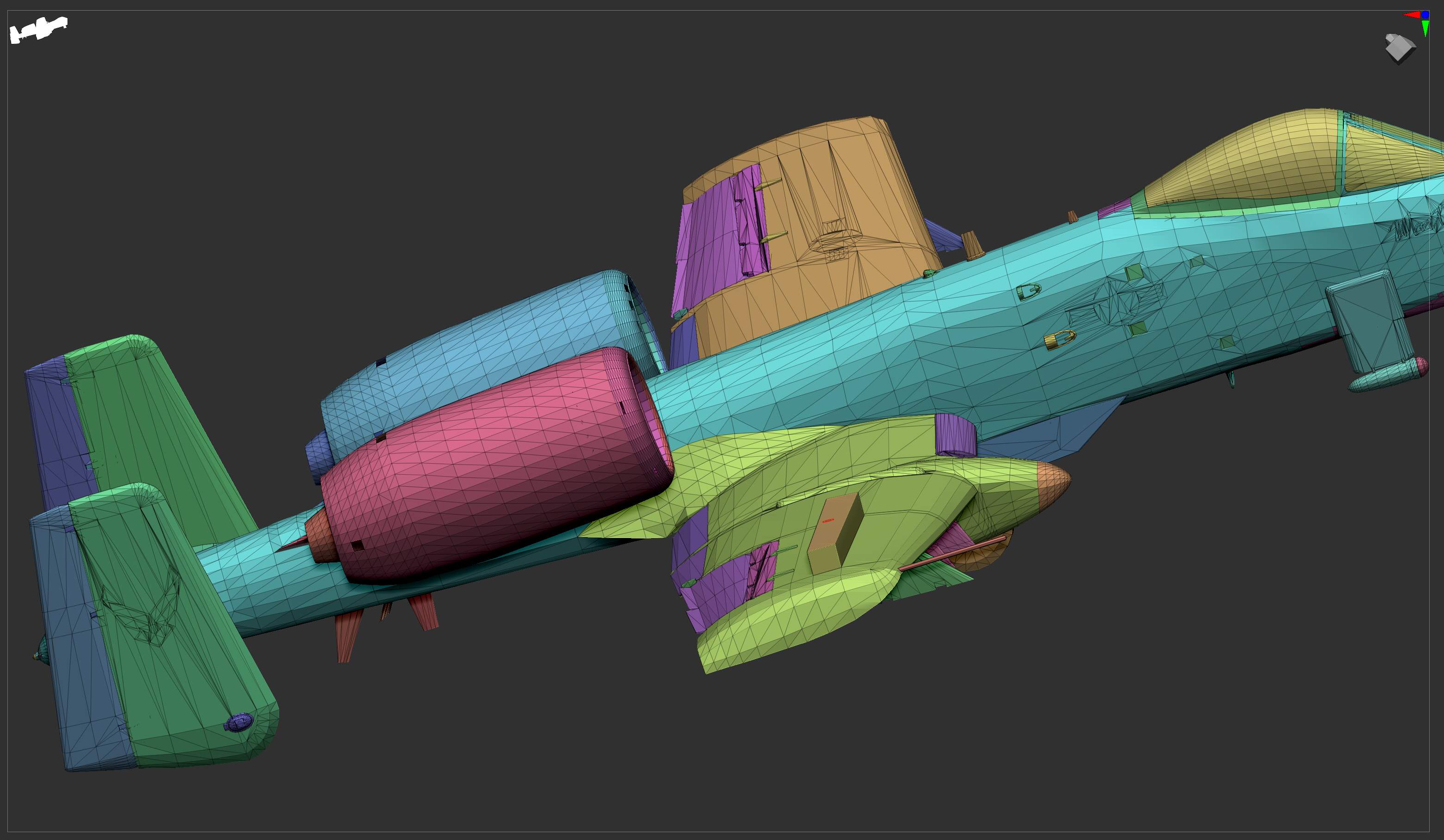

I’m having this problem in ZB2021.1.1 - attempting to extrude an edge or face polyloop, trying to Qmesh, stitching 2 points, bridge edges: 2 holes - details will disappear all over the mesh from vertices merging. I’ve tried unifying and T-posing using transpose master to achieve the optimal size, I’ve tried masking, and mask by polygroups at 100 & topological on, & changing draw preferences dynamic size to make the influence smaller (I’ve returned everything to normal settings since nothing has worked) and I have always used a mouse in Zbrush because a medical condition that precludes using a tablet, so it isn’t a stylus pressure issue.
Do I just scale it up to avoid this? It feels like WeldPoints is permanently on.
MergeProblemBefore
MergeProblemAfter
A real problem being that I am zoomed in so close for this detail work and points could be be merging elsewhere on the model outside my zone of attention, and I don’t realize until hours of work later that the entire mesh is plugged up.

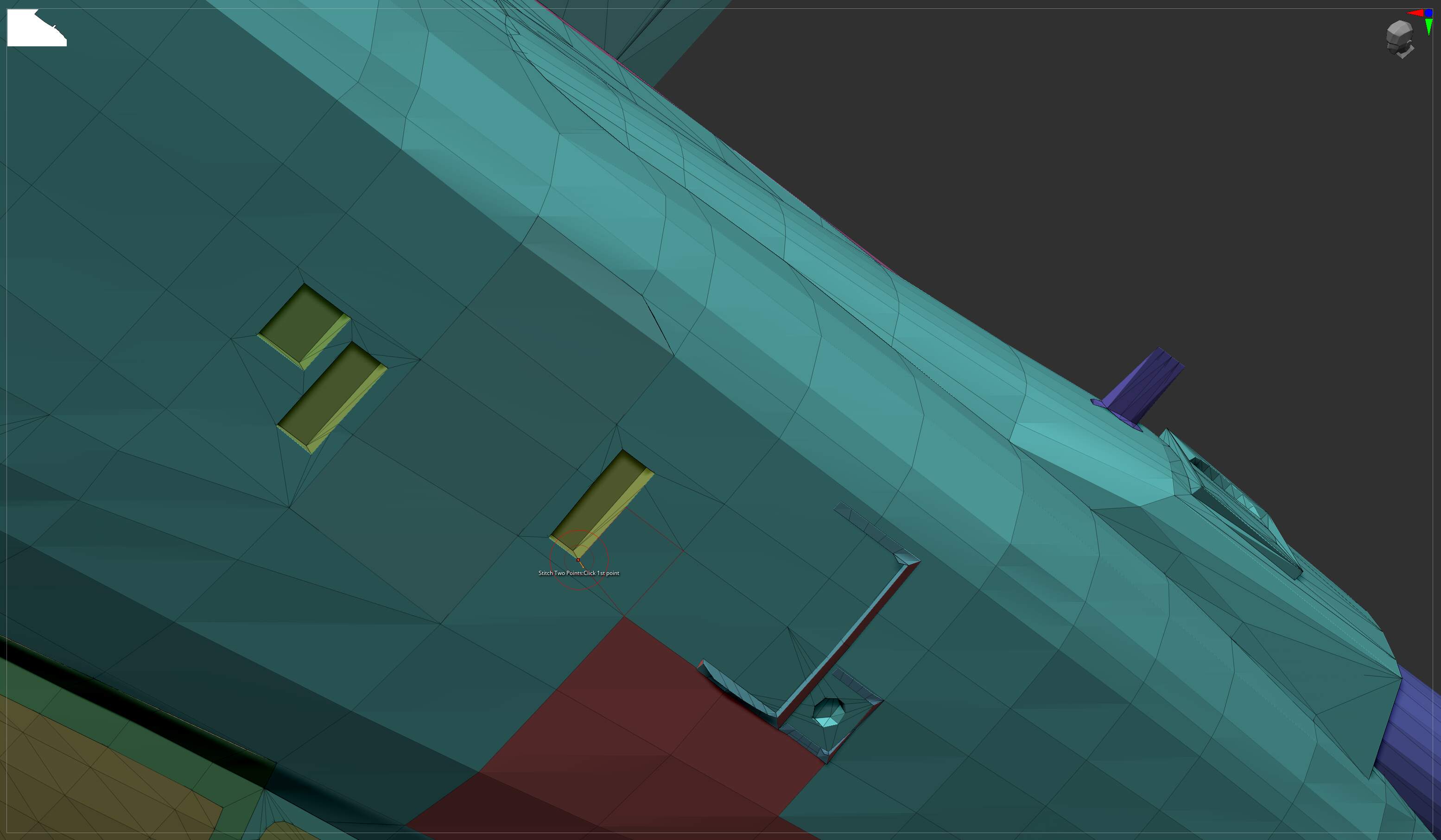

It was actually much smaller, at .21 - unfortunately after unify the results for point stitching were the same as before, even though it is now XYZ Size 2. I will test the other functions in Zmodeler that are giving me problems - on a previous project where I first encountered this, neither bridge edges nor bridge 2 holes worked, on this one bridge edges does work but bridge 2 holes still does not, irrespective of whether edges are creased or not. Here is Qmesh before:
QmeshB4
and after:
QmeshAfta
Extrude edges looks fine this time, but extrude faces looks exactly like Qmesh does down to the same faces disappearing (not flipping, turned display double faces off and on to be certain).
