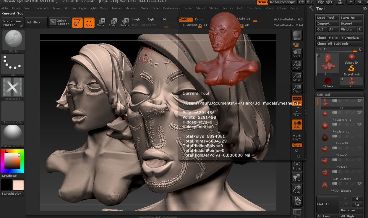

this is one of the best zbrush tools i have ever come across,I am not usually a fan-boy of products but this thing rocks, I can easily sculpt with over a million polys.What I have been using it for is to get the basic idea of the sculpt down, all the forms and relationships,
Performance
here is a quick snapshot, I have been working on it with nearly 2 million polys with no slowdown at all can work with all the sub tools visible. In the snapshot I divided the head again and did some detailing to show that it can run with a lot more polys, when I put the scales and the stitch marks there was still very little slow down. didn’t like undo very much but that was still only a couple of seconds lag.
