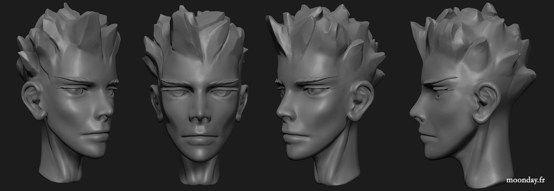

(Original poly modelled head)

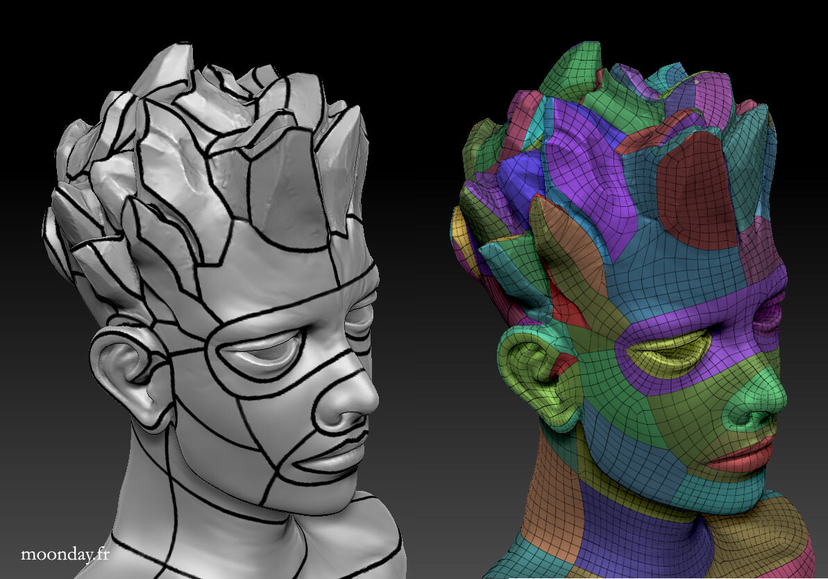

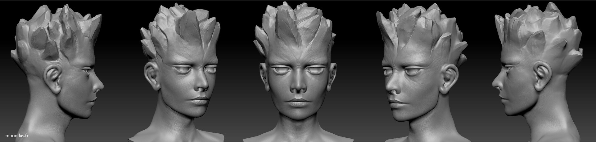

For the male character, I decided to have a 20/80% Max/Zbrush workflow to avoid headaches on retopology and unwrapping:

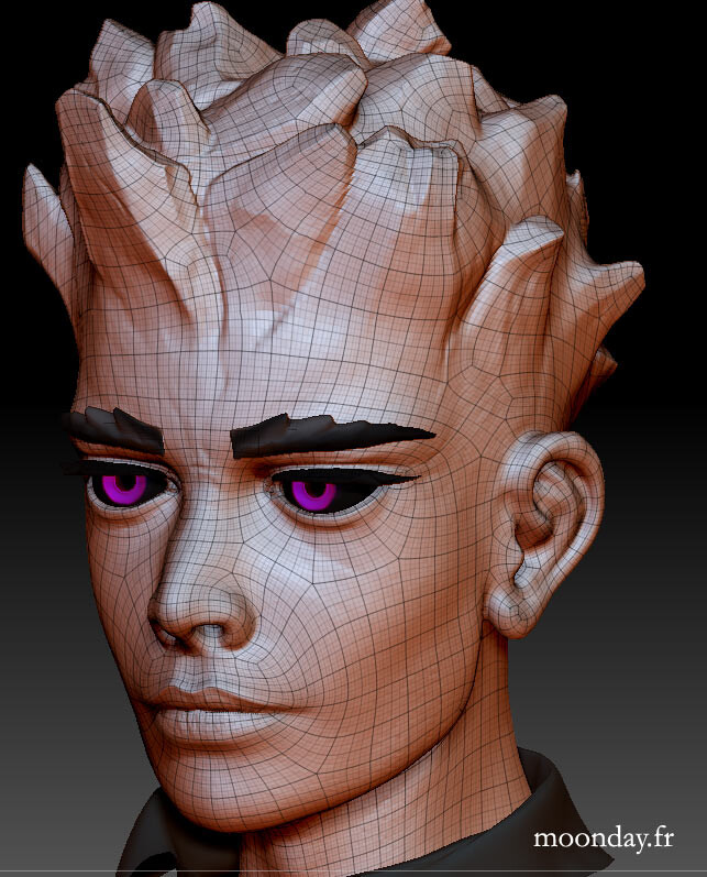

Before adding details sculpt to the head I decided to move from the dynamesh to clean topology version. At first the Zremesher from polygroups (using polygroups from paint option) result were kind of good but it lacked some real edge loops around the eye areas therefore 3ds max helped to draw a clean topology for the lower part of the head that needed to keep its symmetry. However Zremesher gave a good result on the top part of the mesh, it only needed a few poly bridge and adjustment in max to stick the two meshes together.

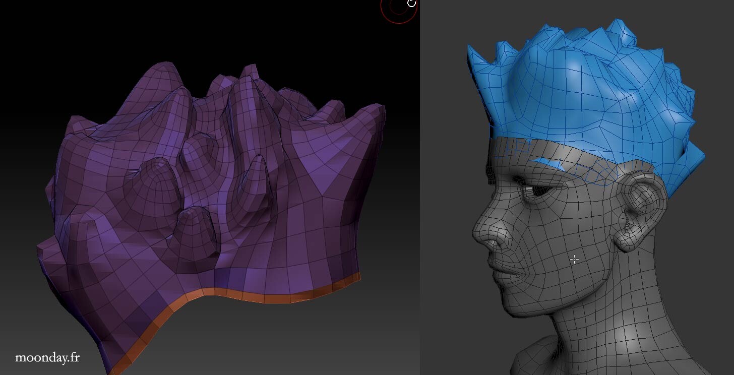

Original Zbrush Re topology attempt
Zbrush + 3ds Max topology before being merged forever
With a good topology it was time to finally start some adjustment way easier to manage a subD 1 like on the eyelids, no more wobbly skin there! Then I could add details with alphas on the skin part.
Topology talking, this is a non animated project however I created a “good” topology for the faces of my characters anyway. It helps in many process coming after the modelling step: easier unwrapping, easier expression editing, good flow of polygons for the displacement in rendered images.
The back of the neck needs to be refined

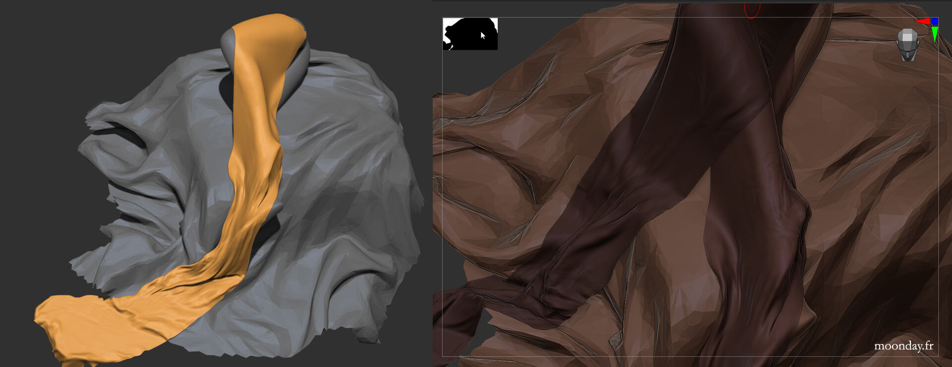

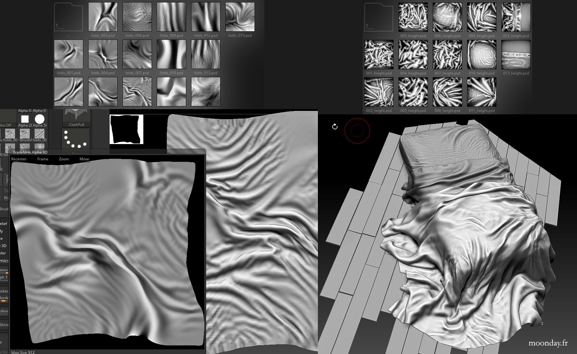

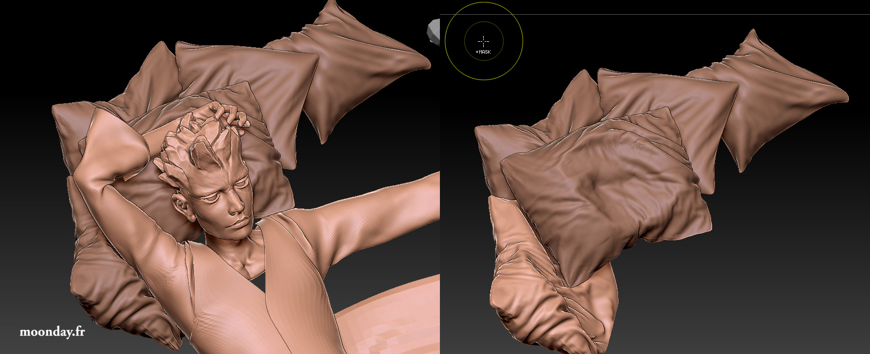

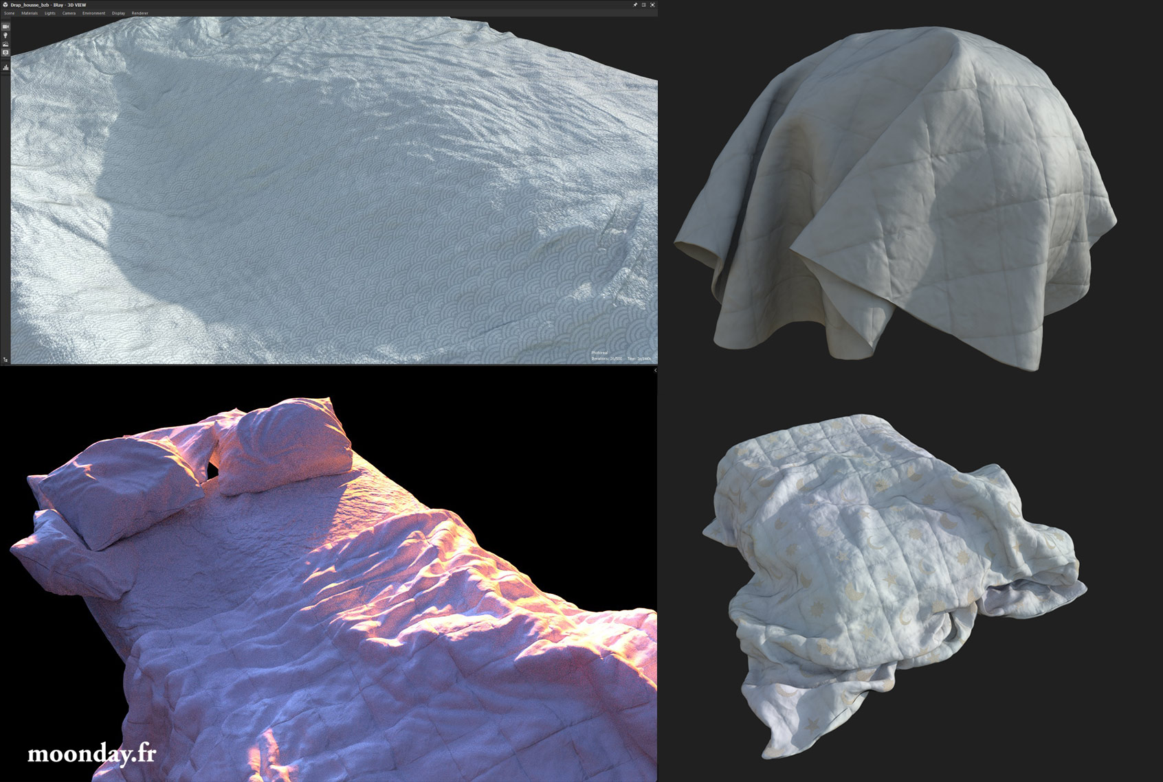

These cloth brushes are awesome, no more waiting for max cloth modifier to painfully move faces in real-time. The hands comes from the model created a few months ago, less scary though.

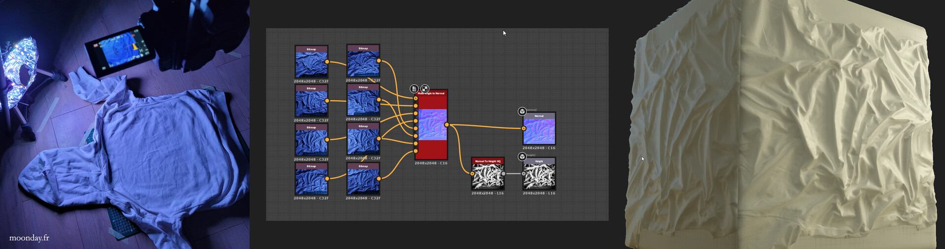

Ah, the geek part… You may remember the method I used a while ago to create cloth wrinkles in the earlier versions of the clothes for that character. Time changes, workflows evolve! Still using Substance software, this time with Designer, I created a new cloth wrinkles collection with multi angle lighted pictures of some fabric, trying light and heavy fabrics to get more variations in the results. It works pretty good and can be easily used in Substance suite or directly in Zbrush as Alphas!
As Zbrush can now deform surfaces with cloth brushes easily, why not use this process to also create Alphas? I may create vector brushes as well for full 3D distortion.
Left: alphas from Zbrush cloth on a plane / Top right : Height maps from texture scanning / Right : Zbrush simulated cloth + cloth brushes strokes + details from generated alphas

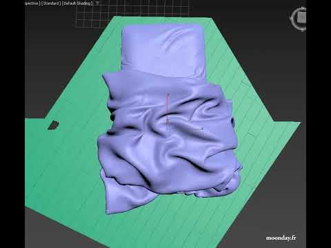

One month ago I worked on some problematic elements of the scene. Firstly I tried to find a way to easily model the very soft and light fabric that covers the female character, trying to mimic the cloth you can see on marble statues. This was achieved in Zbrush with the dynamic menu, the cloth hook brush and by adding/exaggerating details with the standard brush using the basic brush or pre-made alphas. The test looks conclusive and will be applied to the final scene.
In the mean time I adjusted characters poses and camera angle, once this step will be validated I’ll be able to play with all the characters and bed clothes. Fun ahead.
Basically using firmness at 1 and added a lot of simulation steps in Zbrush
Then the mistakes are corrected with brushes

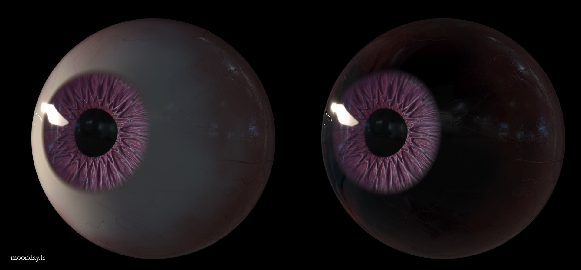

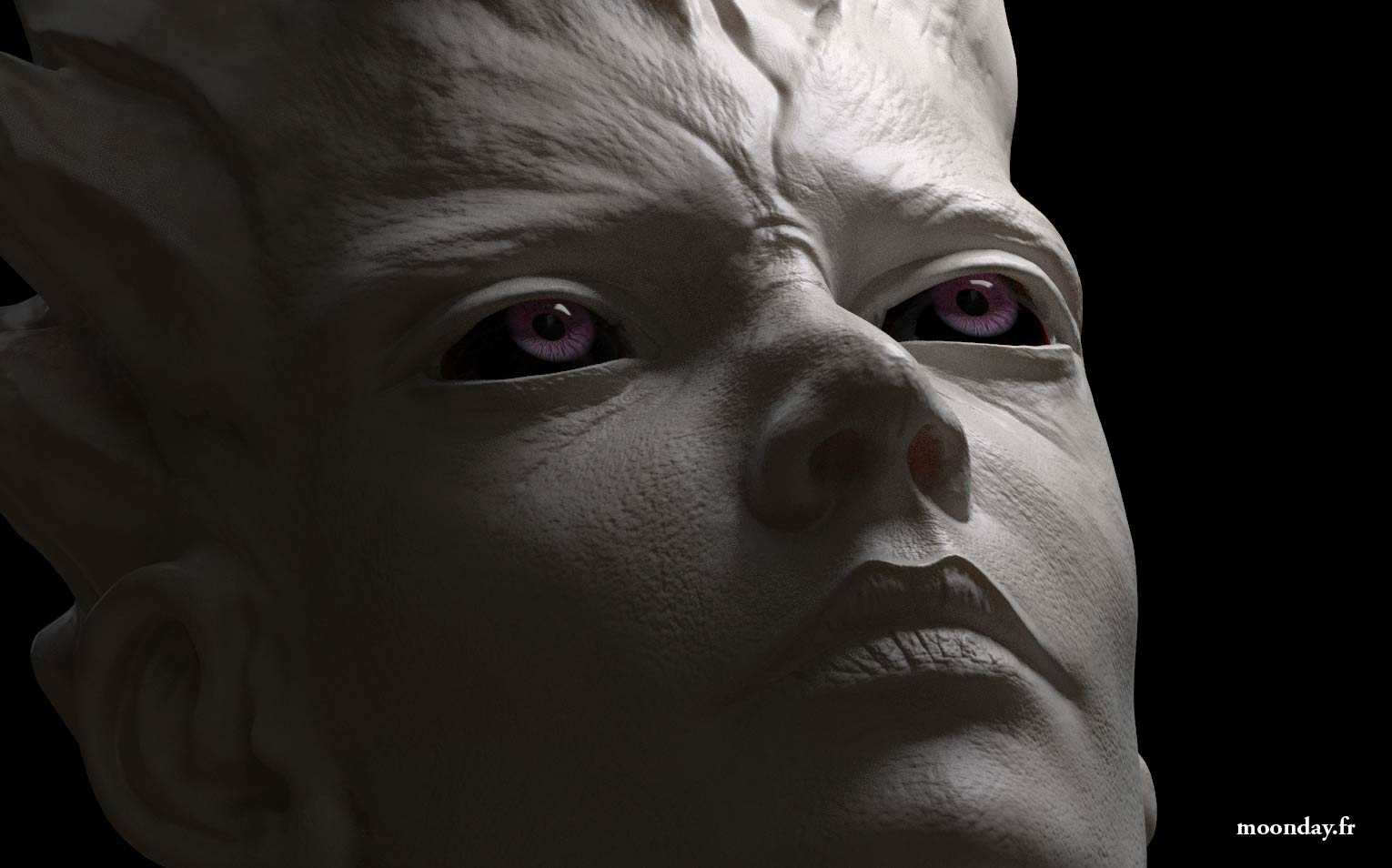

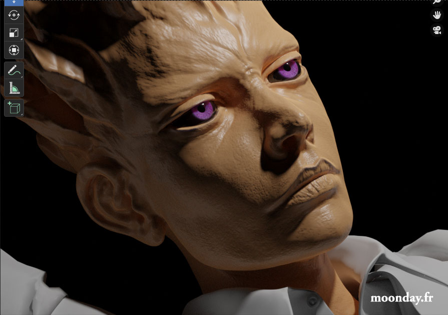

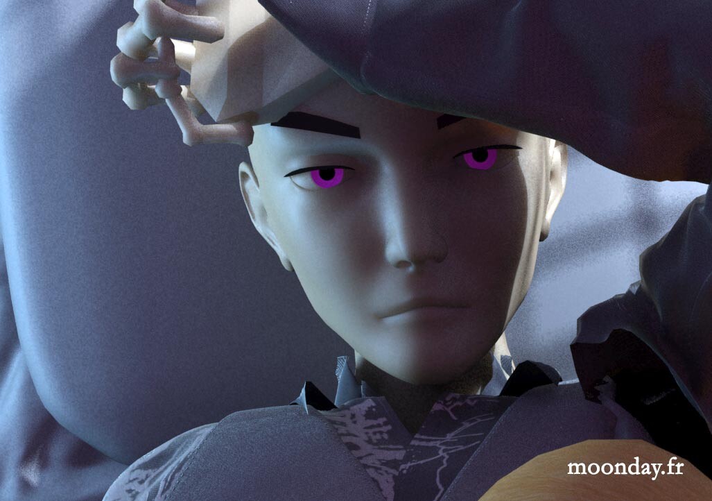

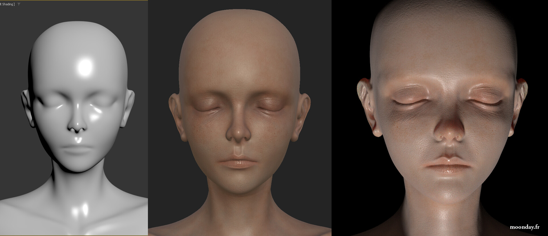

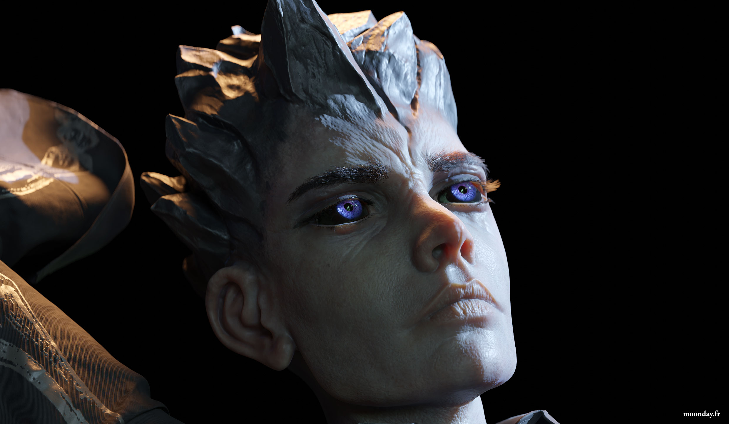

Then I moved on the eye shader. It’s been years I used the same method to create eyes, I thought it was time to learn new things!
The model is half Zbrush sculpted, half substance designer textured then it’s only Standard surface shaders magic occurring in 3ds Max.

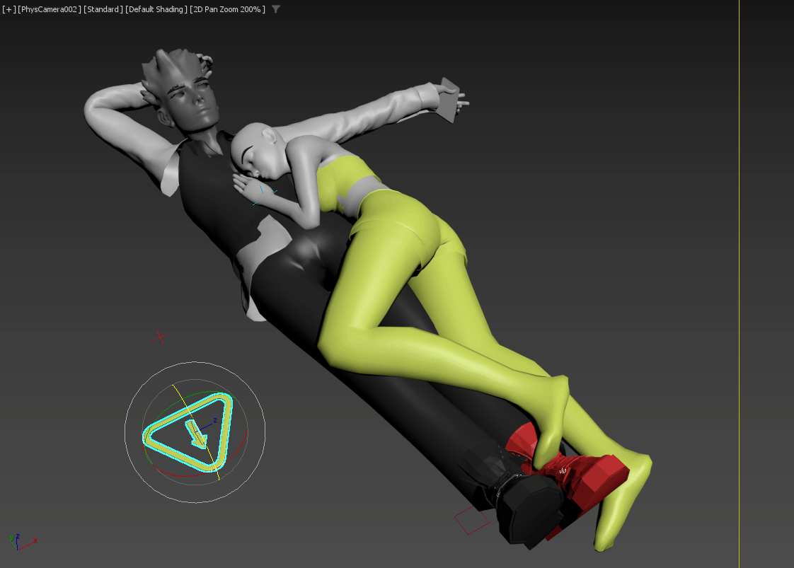

The characters will be posed with the help of simple rig in Max then adjusted in sculpt here and there when placed in the environment.

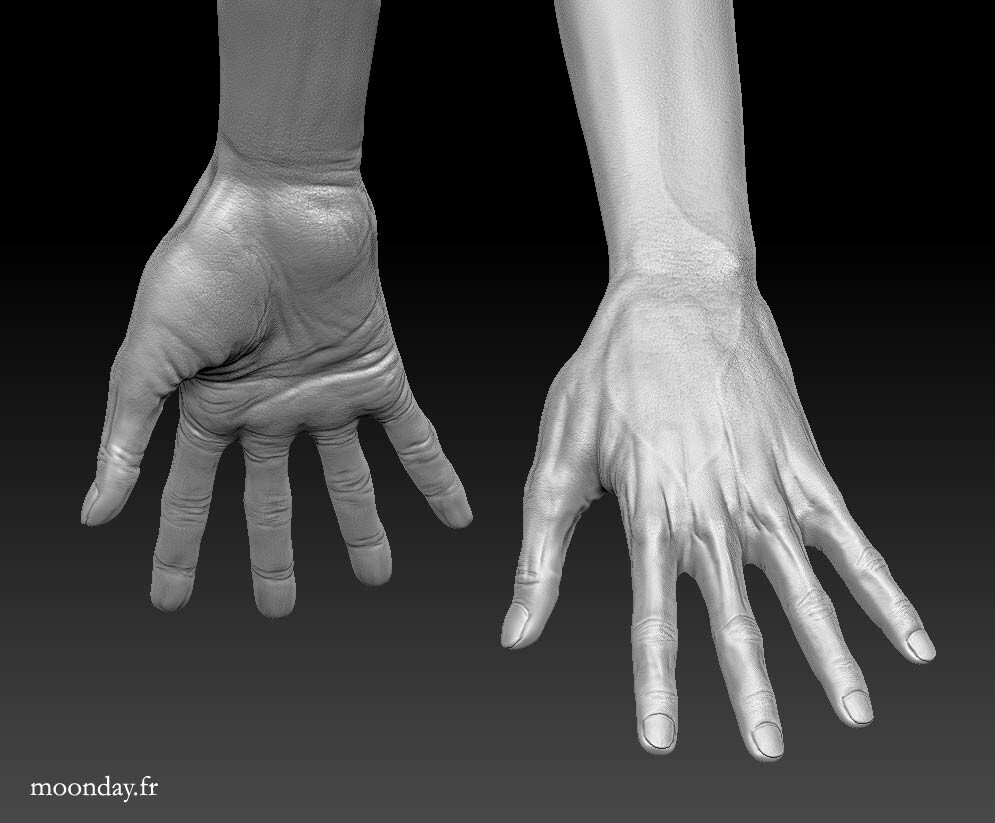

I finally found some spare time to work on this project! Many adjustments have been done on the environment, some props were added, other found a new location and the light scenario evolved once again.

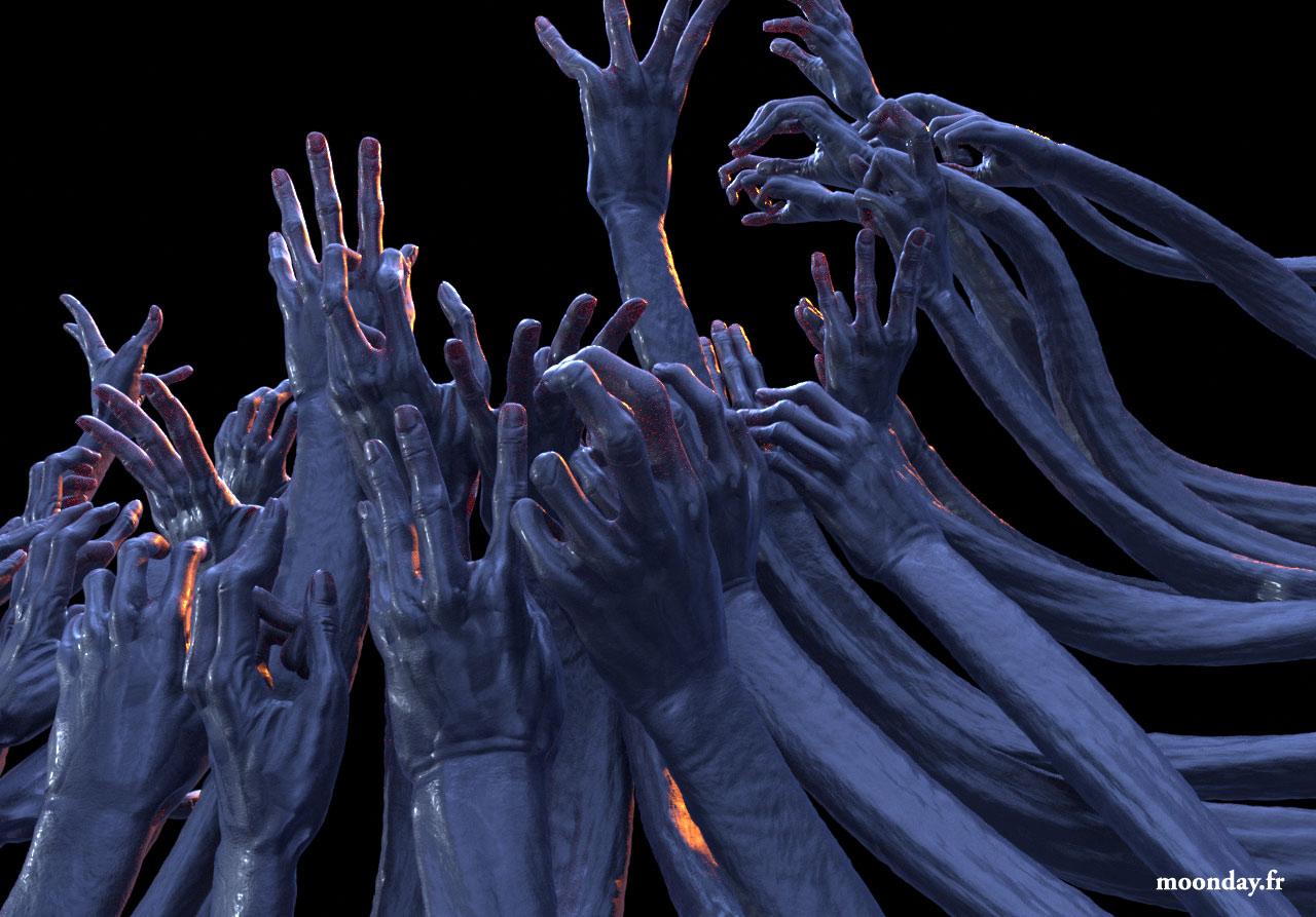

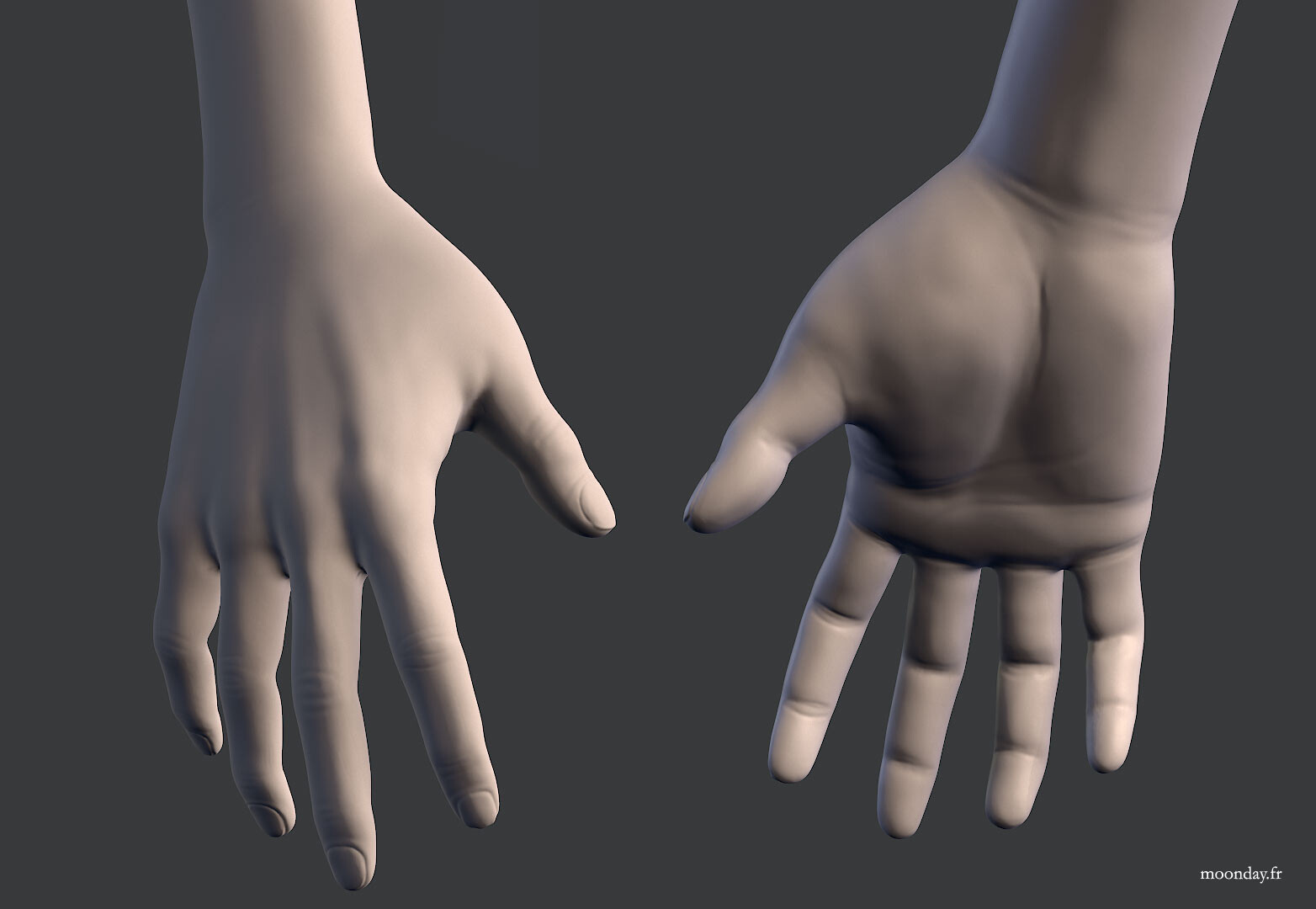

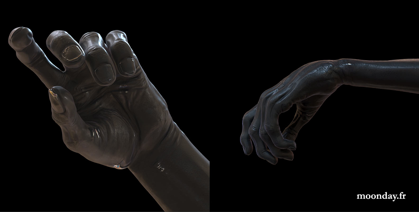

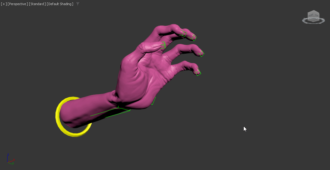

One the main goal I had was to finally get the multi 3D hands to be converted as an IMM Curve brush inside Zbrush. after some trials and error I finally got the basic setup and I could even get the original hand UVs and textures created in Substance a few weeks ago! The not really issue I have now is to find a way to texture these longs arms coming from the curves, I’m pretty confident about finding a way to fix this in the coming days.
Next step: create many poses from the original hand model in 3ds Max to convert all of those as IMM meshes.
First steps – Almost there – There
Palm proportions has been adjusted
A few of the many poses that will be needed to complete the set

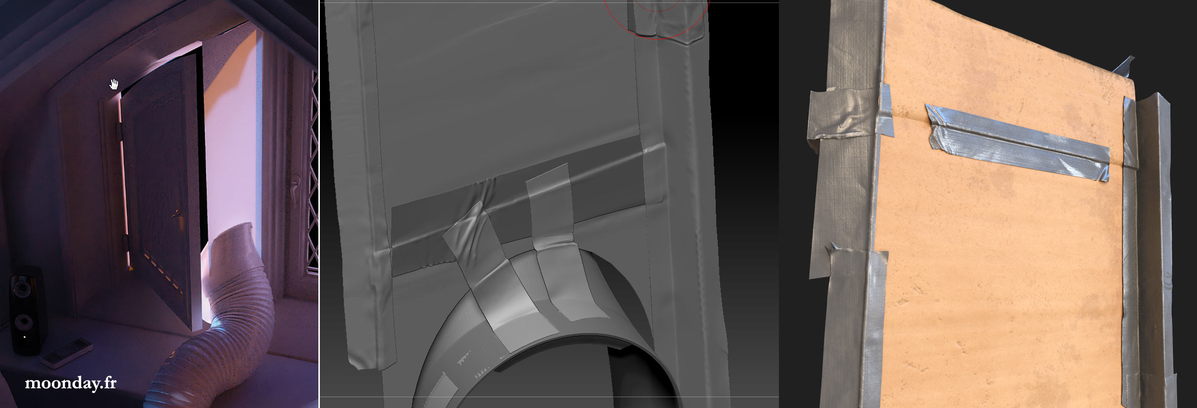

After some lighting tests I noticed the tissue that makes the link between the window and the air conditioner attracted too much light as its material is translucent, therefore I thought about creating another object: a cardboard with many duct tape stripes. This one was fully modelled in Zbrush with the Zmodeler brush and many Zproject on the different subtools. It will need a few more stripes and the model will be ready: no more attraction for the eye of the viewer!
Placeholder – Zbrush model – Substance designer

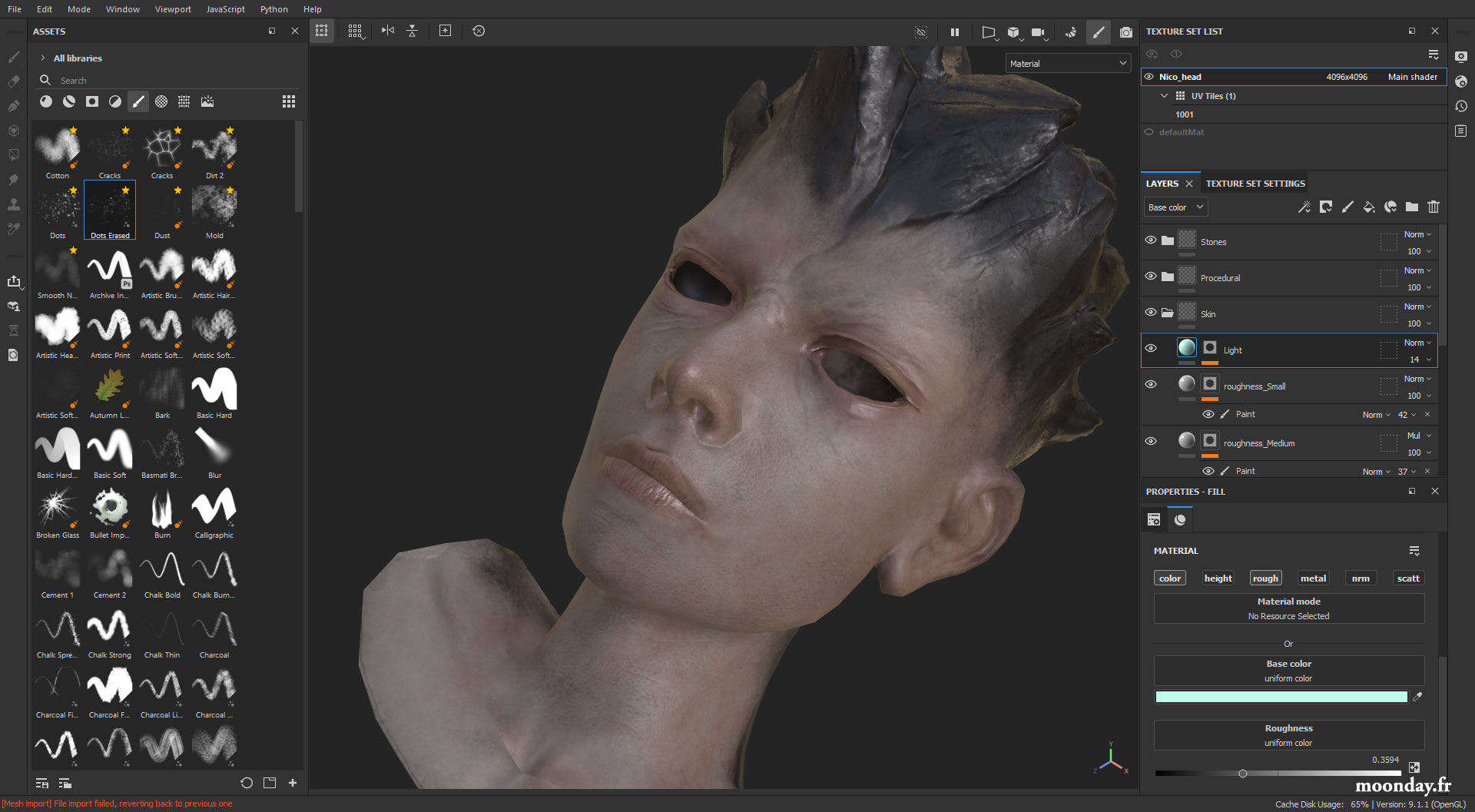

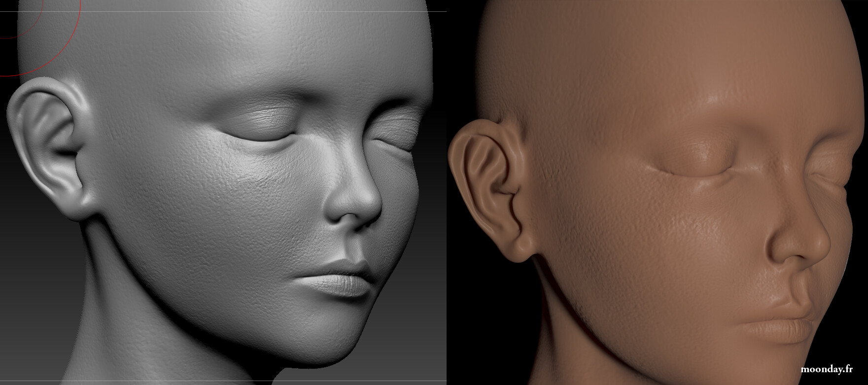

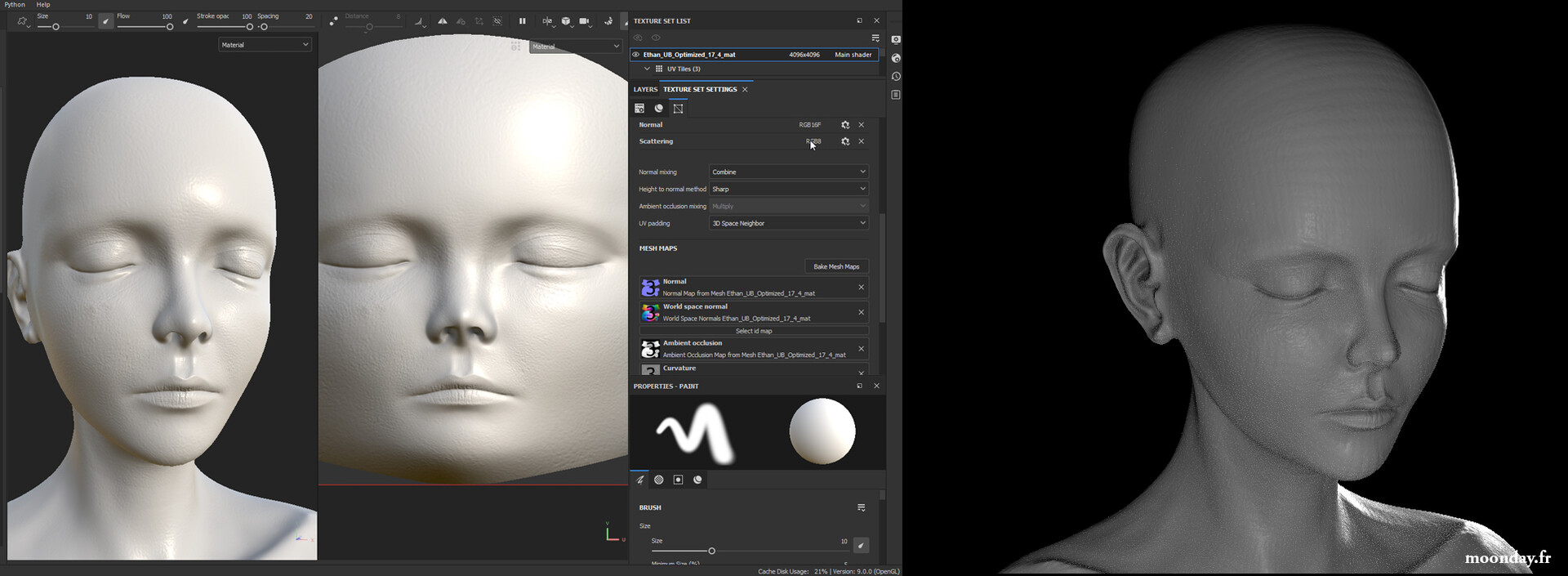

I had some hard times trying to get a correct displacement and normal maps from Zbrush using the re projection method. The details looked good inside Zbrush, however the face had a lack of details once in 3ds Max. As I want to optimize the scene, there is now way I’ll use 8K texture or some render crash will happen with the rest of the models, indeed, many of the furnitures use subdivision and displacement at render time. However I already started to optimize the Ram usage by using 8 bits Jpeg files instead of PNG/EXR but at the price of bad quality on some areas on some models.
My solution to get fine details was to simply bake the HD sculpt of the low poly face in Substande Designer, it was fast and effective! Now the main details are here, I’ll be able to add some on the rock area while also painting the colors in Substance Painter.

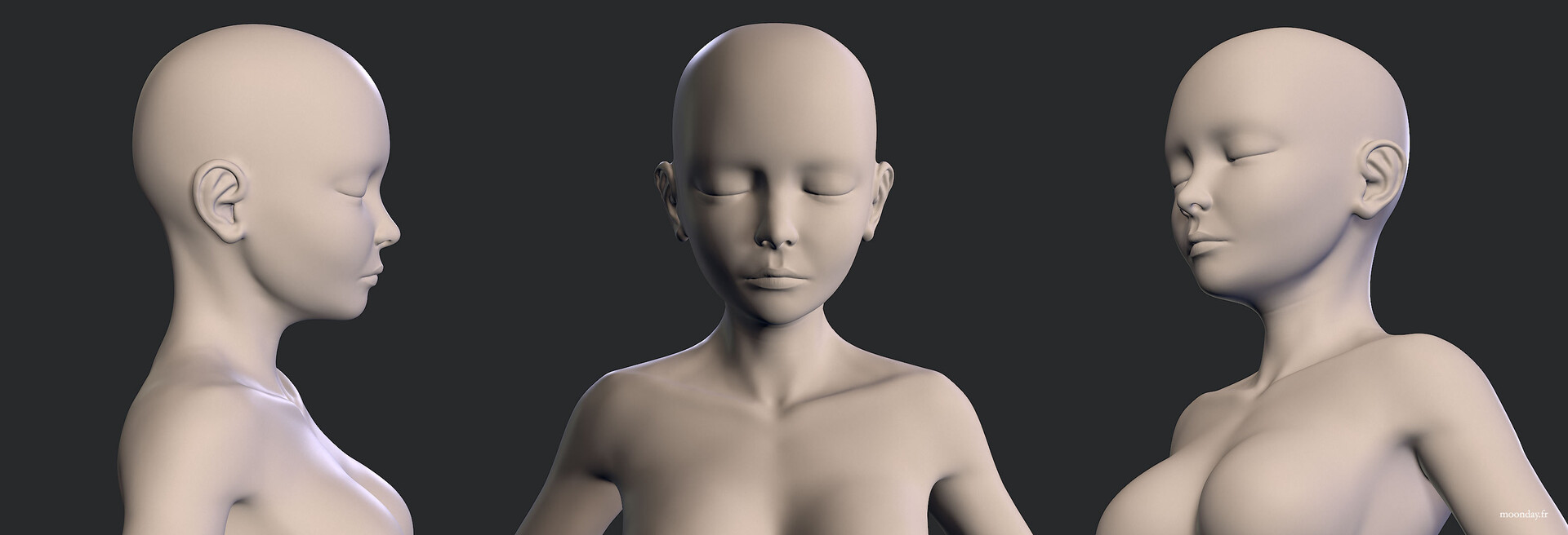

I pushed away this next big step for too long, now it the time to dive in sculpting bodies and make them come to life with textures!The work started by adjusting the bodies poses, once again and also by adjusting some proportions on the female character. Then I finally jumped on the multi UDIM tiles process. I initially thought that 1 UV tile for the the upper body would be enough for this character but after some poor resolution baking results and mostly after seeing the high details results I could get on the male character: The female upper body was split in 3 UV spaces with a large one for the face. This means the baking had to be done in Painter.
The face proportions were adjusted:

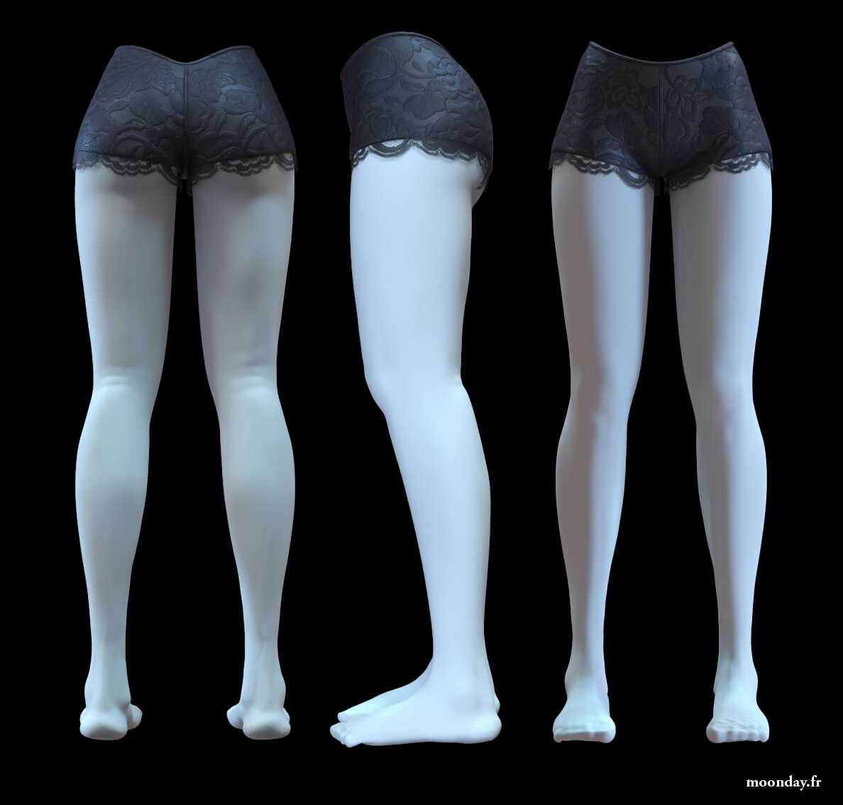

Legs proportions adjusted:
At first, the Zbrush baked displacement map looked good inside 3ds Max (minus the resolution) but when I imported the baked results from Painter or Designer, the faceted look knocked on my door. It certainly comes from the way the different softwares internally manage the subdivision. The solution I found was to avoid using the subdivisions option in the Arnold properties modifier, only use the Displacement options and add an Opensubdiv/Turbosmooth modifier below the Arnorld properties modifier. The old way. Indeed, Arnold uses Catmull–Clark subdivision model that is not compatible with baked displacement map generated from Substance.
Zbrush details VS 3ds max 1 UV tile details:
Height map used as “displacement” in Painter VS Displacement inside 3ds Max and Arnold:
Needless to tell the multi UDIM workflow gives great details on the character’s face and the diffuse/roughness/additionnal bump painting works like a charm.
Original low poly mesh – Painter – Arnold:
The skin shading looks great, the details are good enough for the scale the character will have in the frame for the final render:

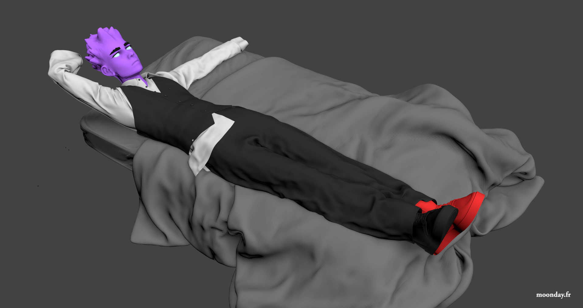

Top: Placeholder / Bottom: a very tired duvet
High frequency details blend map – Medium frequency details blend map – Medium with a higher blend map value

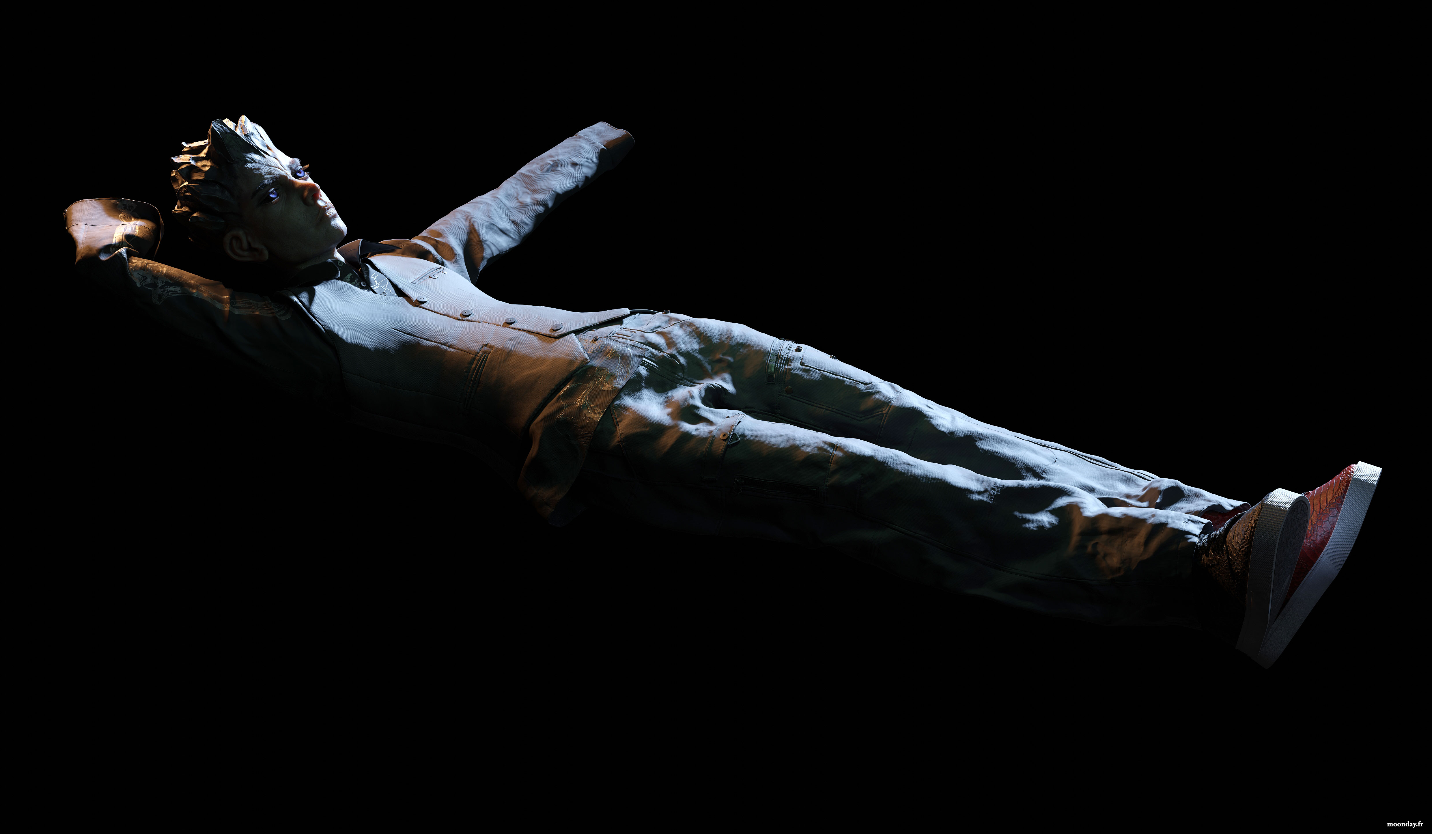

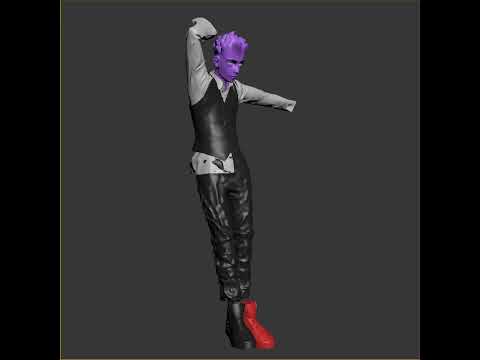

Here I tried a lot of ideas to get really close to a real fabric behaviour. For the trousers, I used a vertex group around the hips area, with a surface property to stick to the character body, that is only activated a couple of frame after the start of the animation, this way the bottom part of the cloth cover the feet area.
Here again, I used an animated blend map to shrink the surface, resulting in medium wrinkles creation. About the simulation steps: the character go into his final pose, then the bed goes in its final pose to lift the clothes under the body and finally the second character cover the first one with her leg to slide the fabrics. Same process for the shirt.
T pose to Final pose
The vest used a similar workflow but instead of running the simulation on a high density mesh, it was run on a low poly version. The result could be used as a target mesh for the real vest through a Skinwrap modifier. Controlling a high poly mesh this way ease the process to adjust problematic areas.

All the cloth elements after adjustments

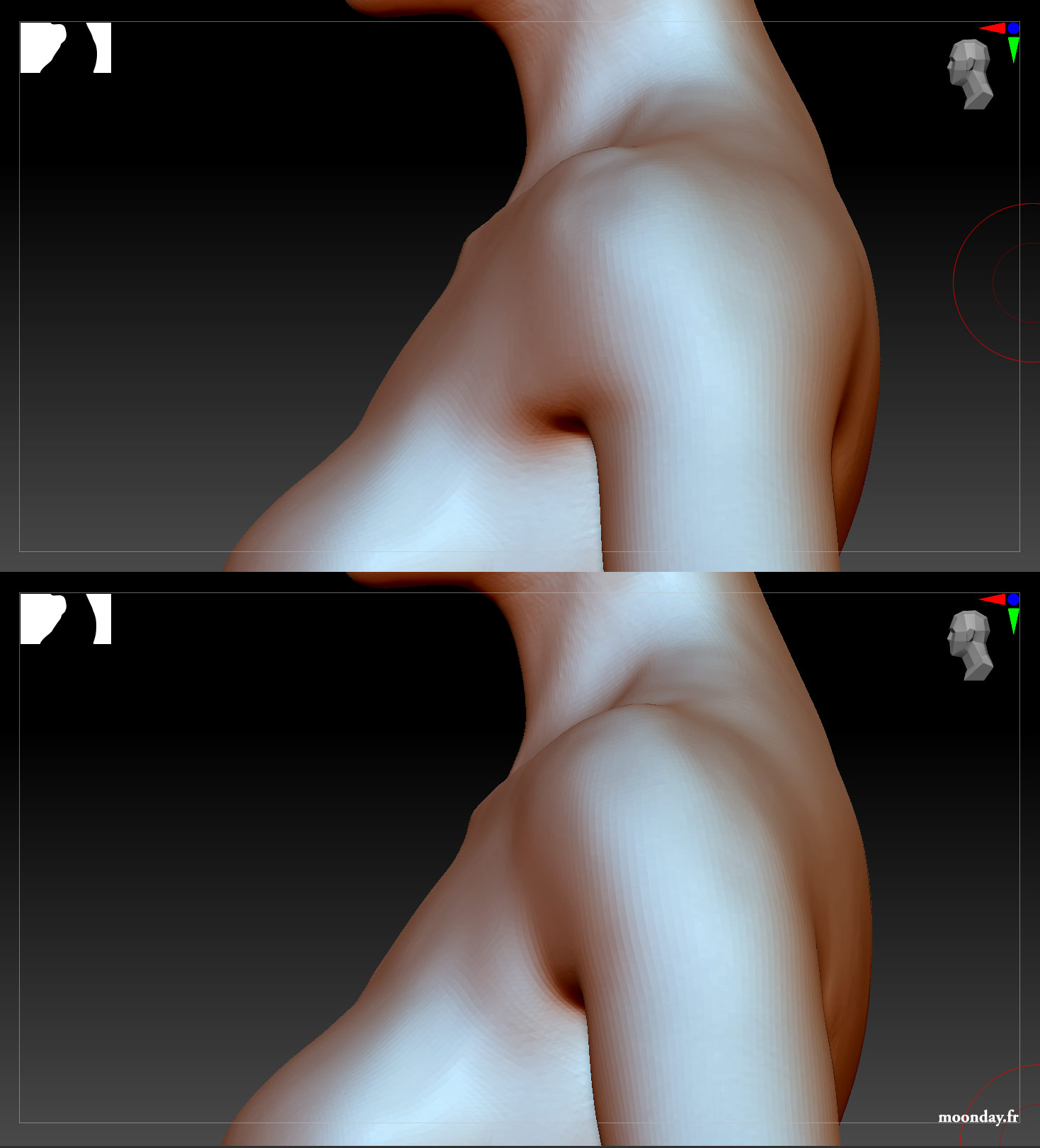

Top: before / Bottom: After. And I wondered why my characters shoulders looked wrong all these years

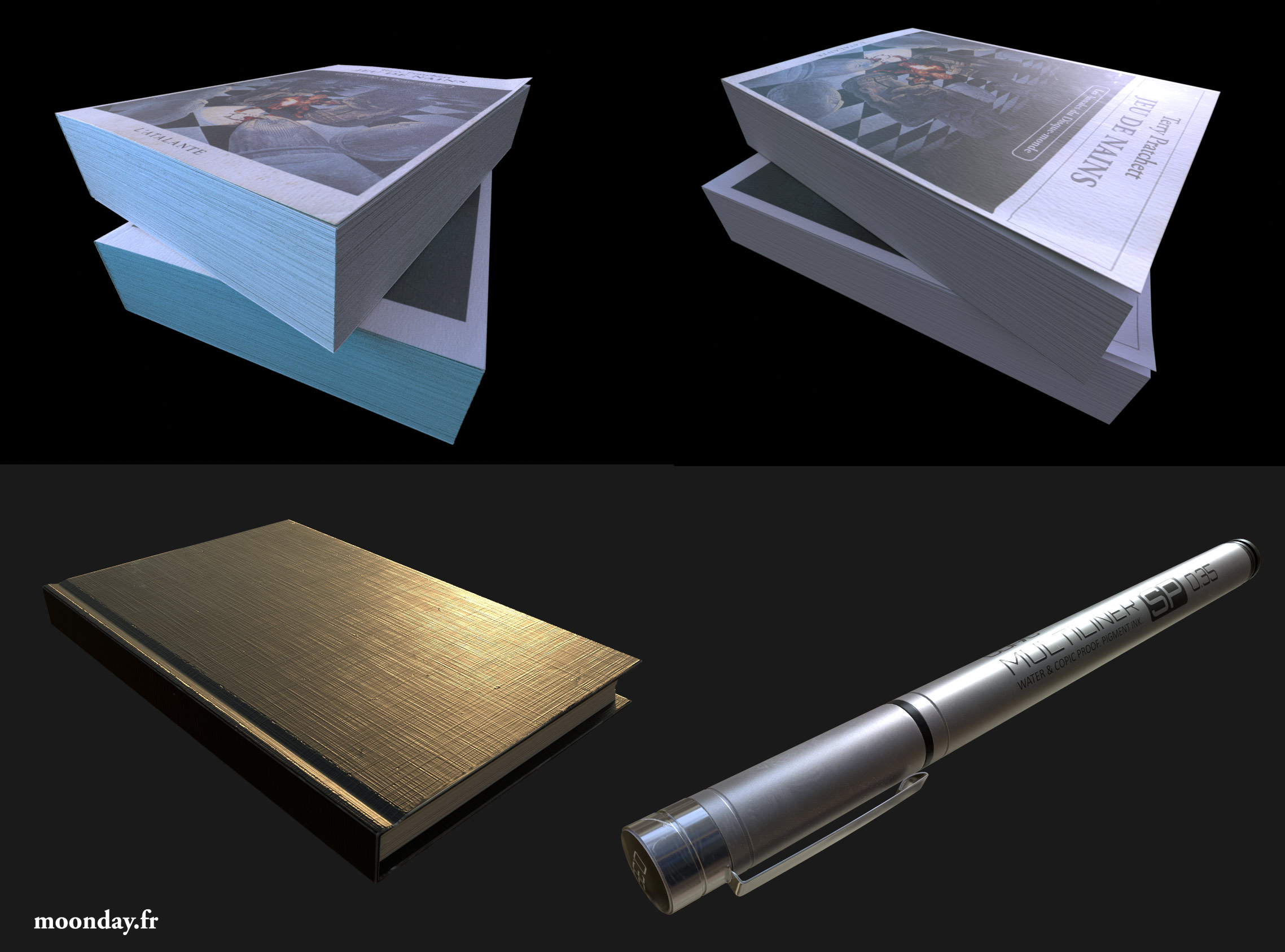

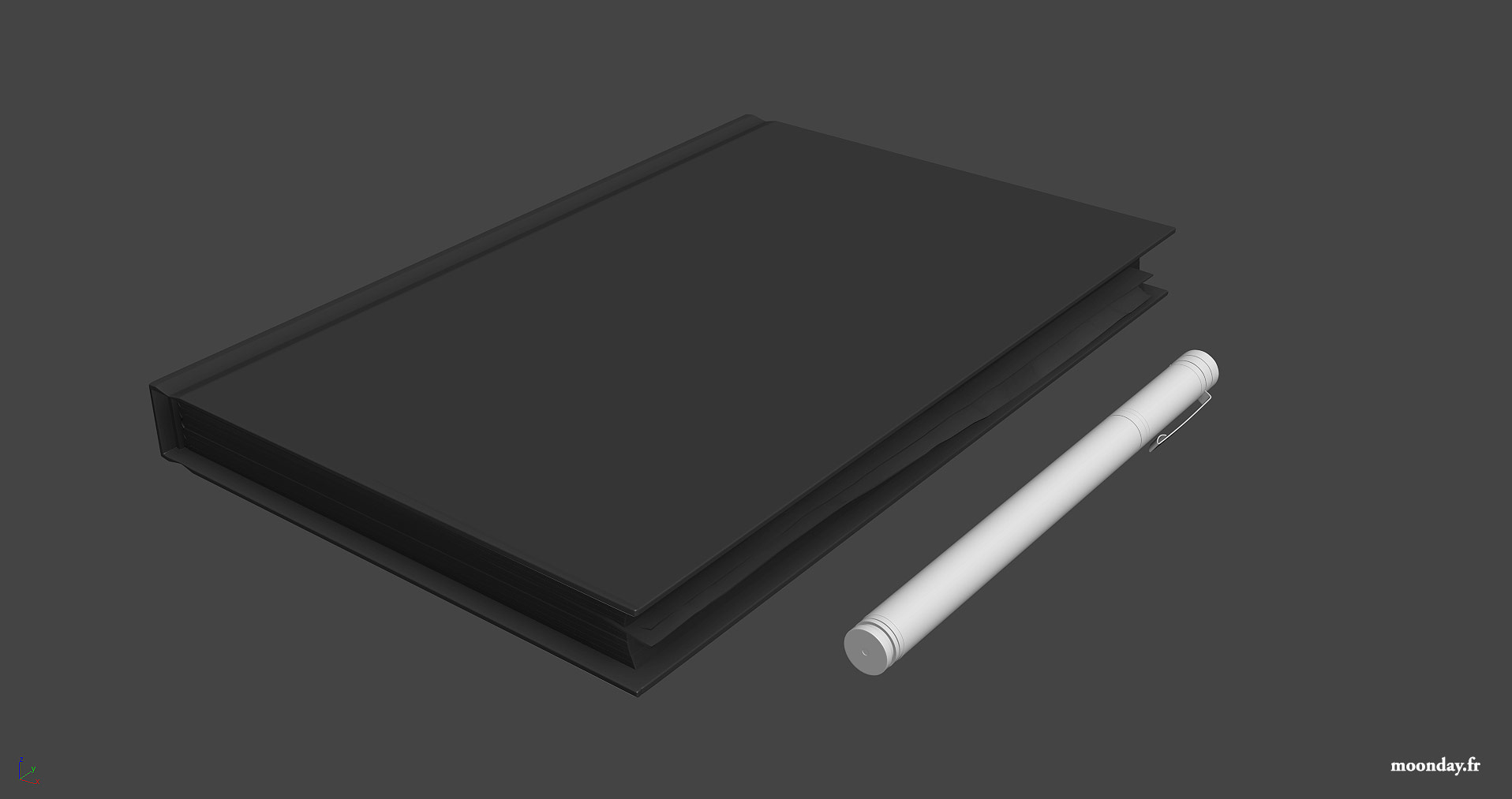

You know me now, when I don’t have enough time to work on my artwork, I model quick props here and there. The constraint I’m applying now, is to be the most efficient possible, this is an aspect of 3D creation I’m trying to give to my students: don’t waste time on details and work faster.

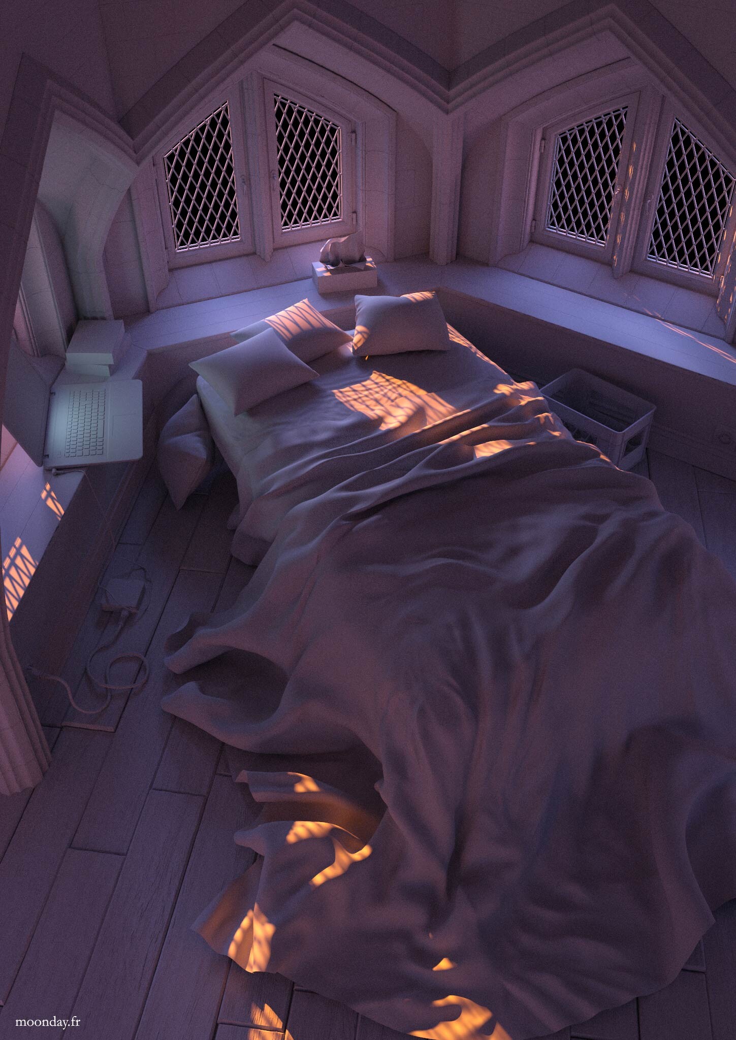

A new light source has been added, the scenery was to dark to my eyes, and this is still a work in progress! After watching last Hayao Miyazaki movie, the environment got me inspired to enhance my scene.
TT-WIP_18_02

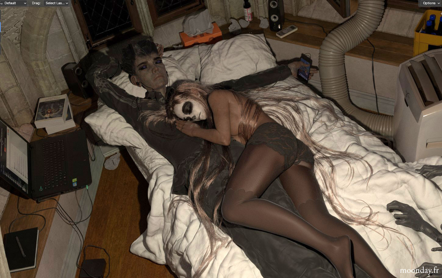

So far I tried to optimize the final scene to test render passes at full resolution, 3512 x 4961, it won’t be an easy task but the CPU workflow seems to hold the whole universe on its shoulders and can render passes between crashes. More Ram will surely be needed soon.

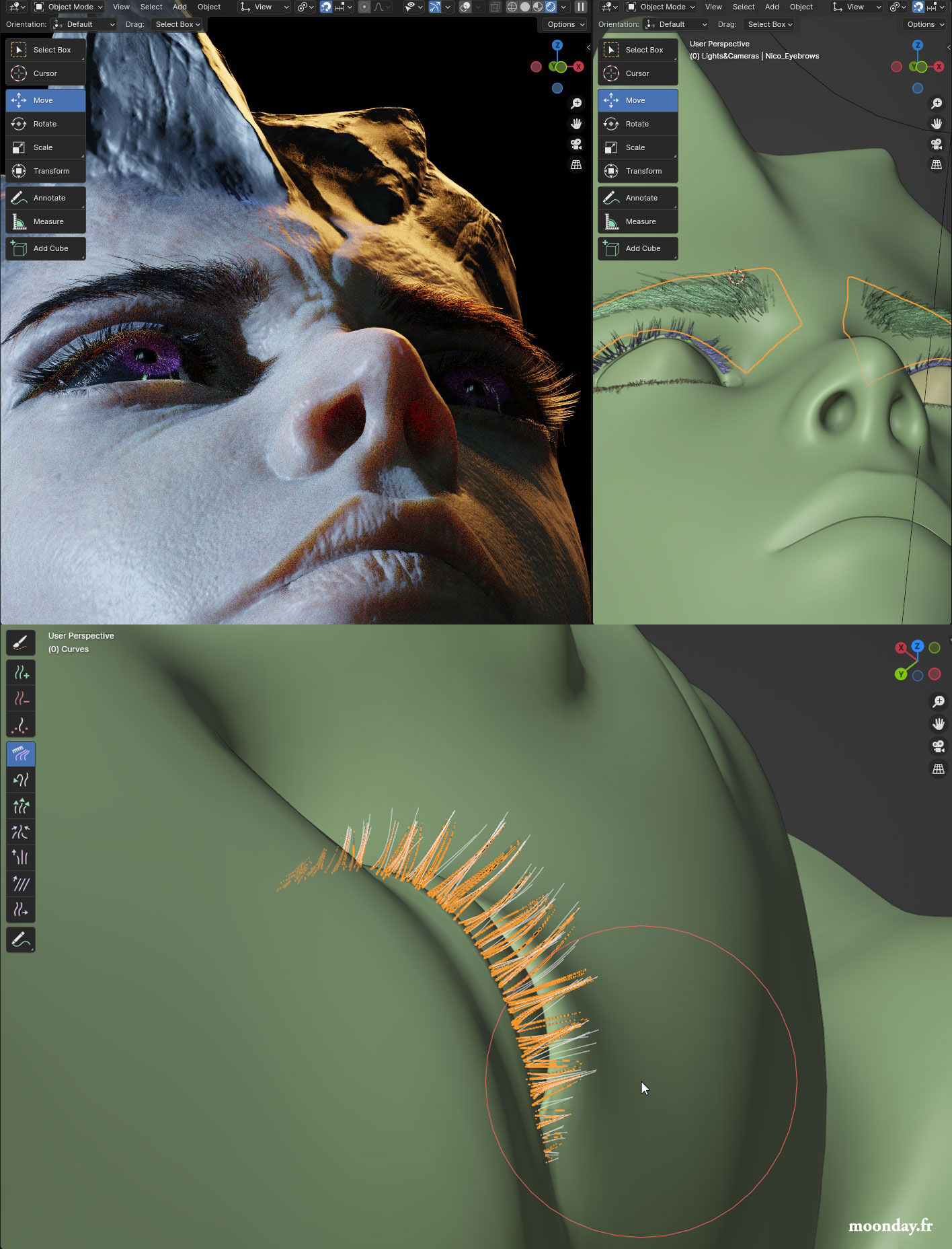

For now I’m only using a couples of modifiers like Solidify, subdivision or Displacement, Curves made in Blender will come on the next project

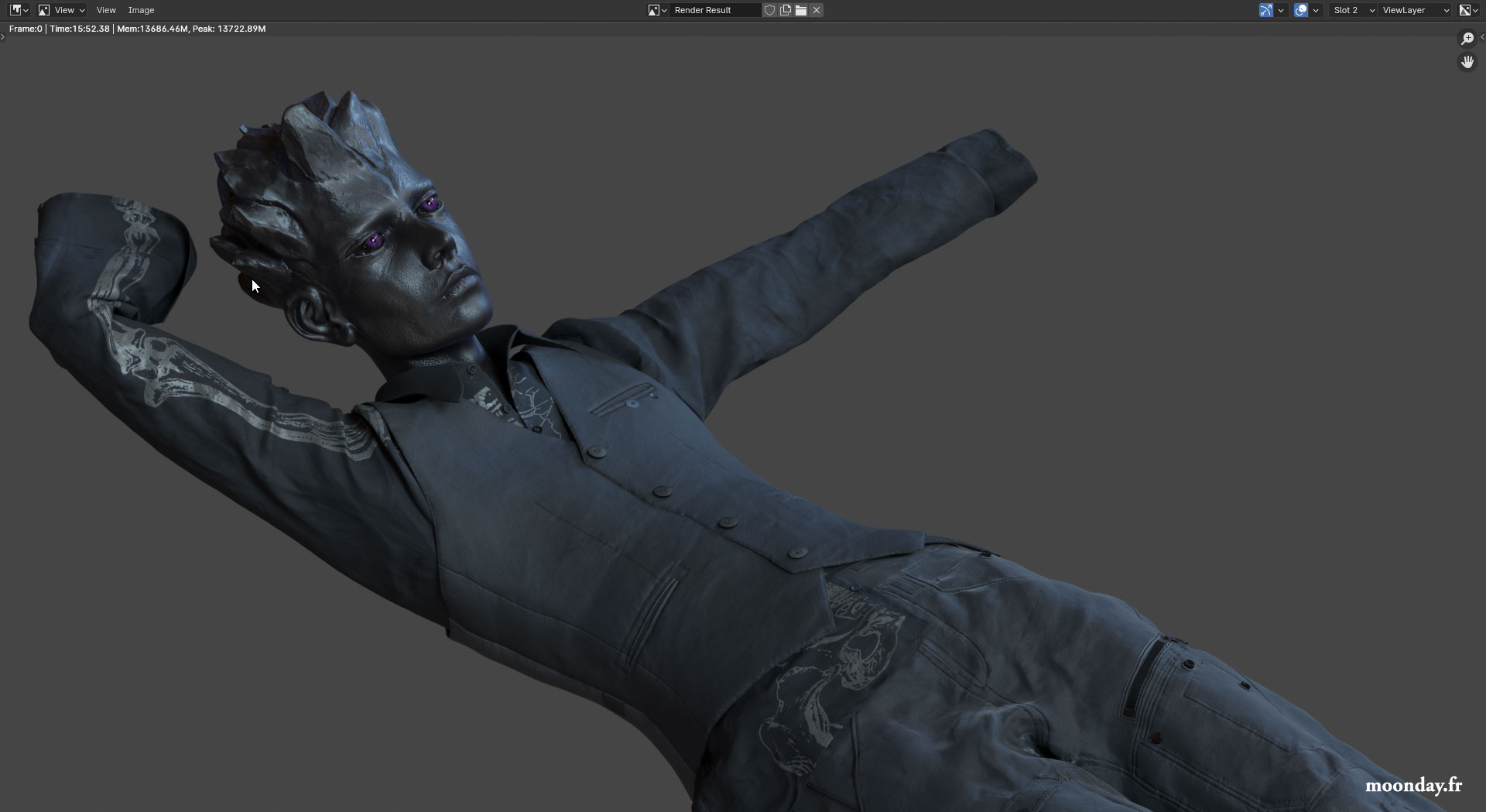

As far as the transfert goes, I could replicate many of the 3ds Max + Arnold scene to the Blender + Cycles scene. The Light scenario is similar from the Arnold lights as we can also use temperatures to set up the light color with nodes in Blender. The overall render looks different from Arnold but I’ll have to deal with it.
The complexe Hand + Arms material from Max could be created in Blender Shader editor with a mix of nodes. I could test the Drivers to control similar value between the two shaders.

The tri planar option directly available in the image texture node is pretty smart but it misses a few options available in Arnold

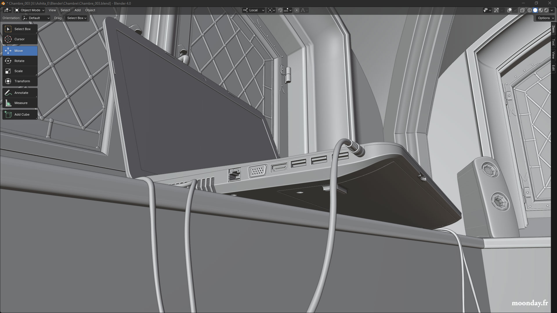

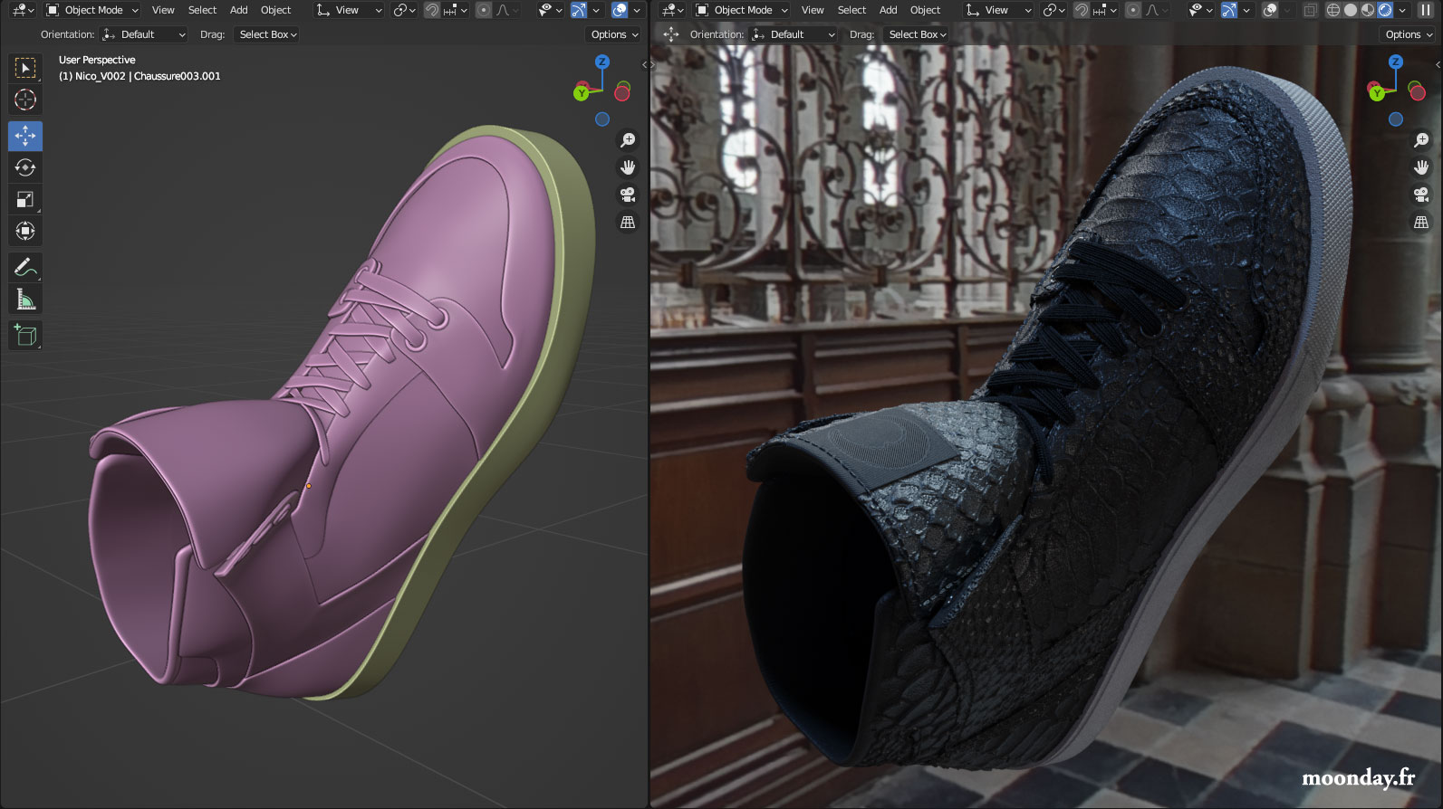

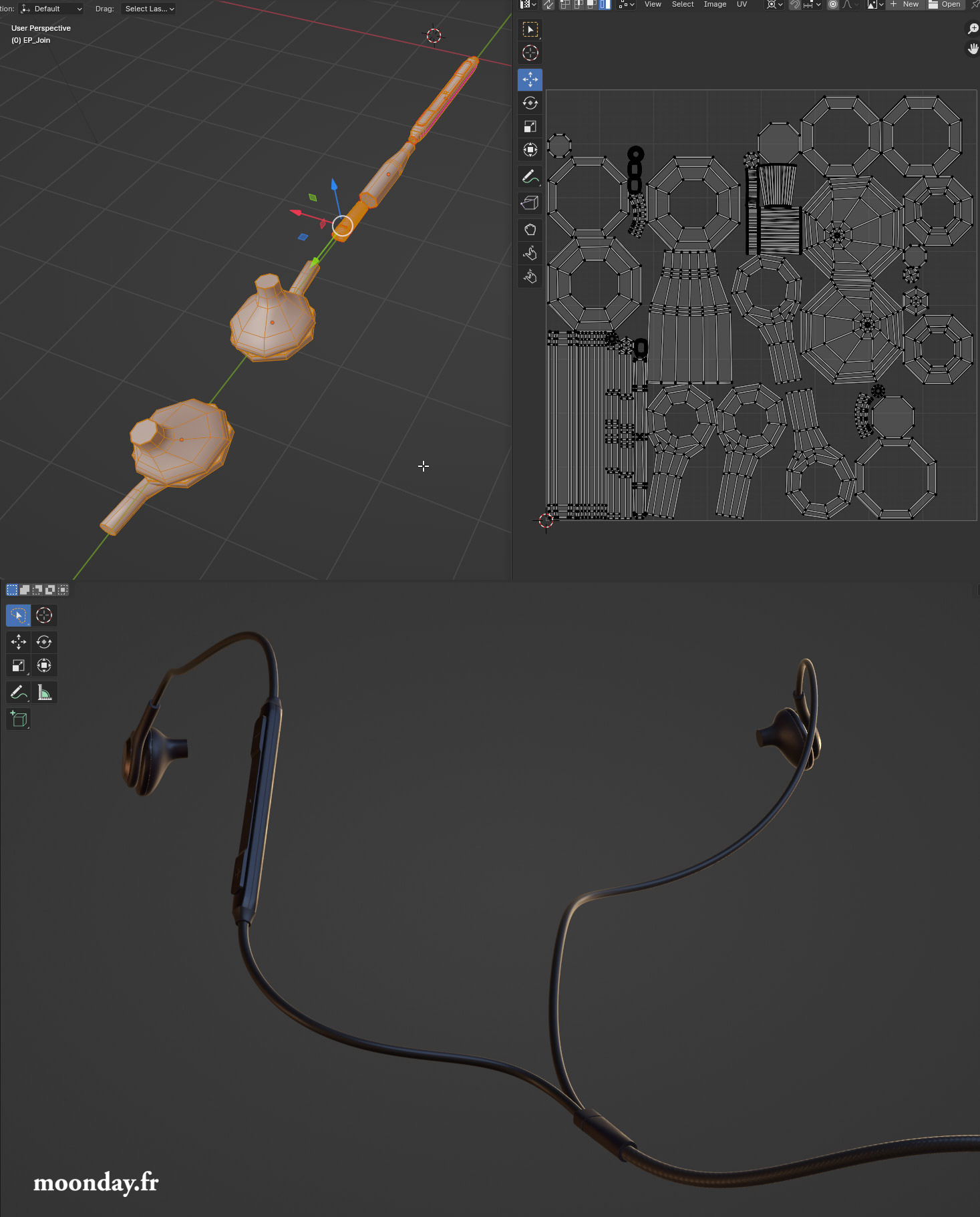

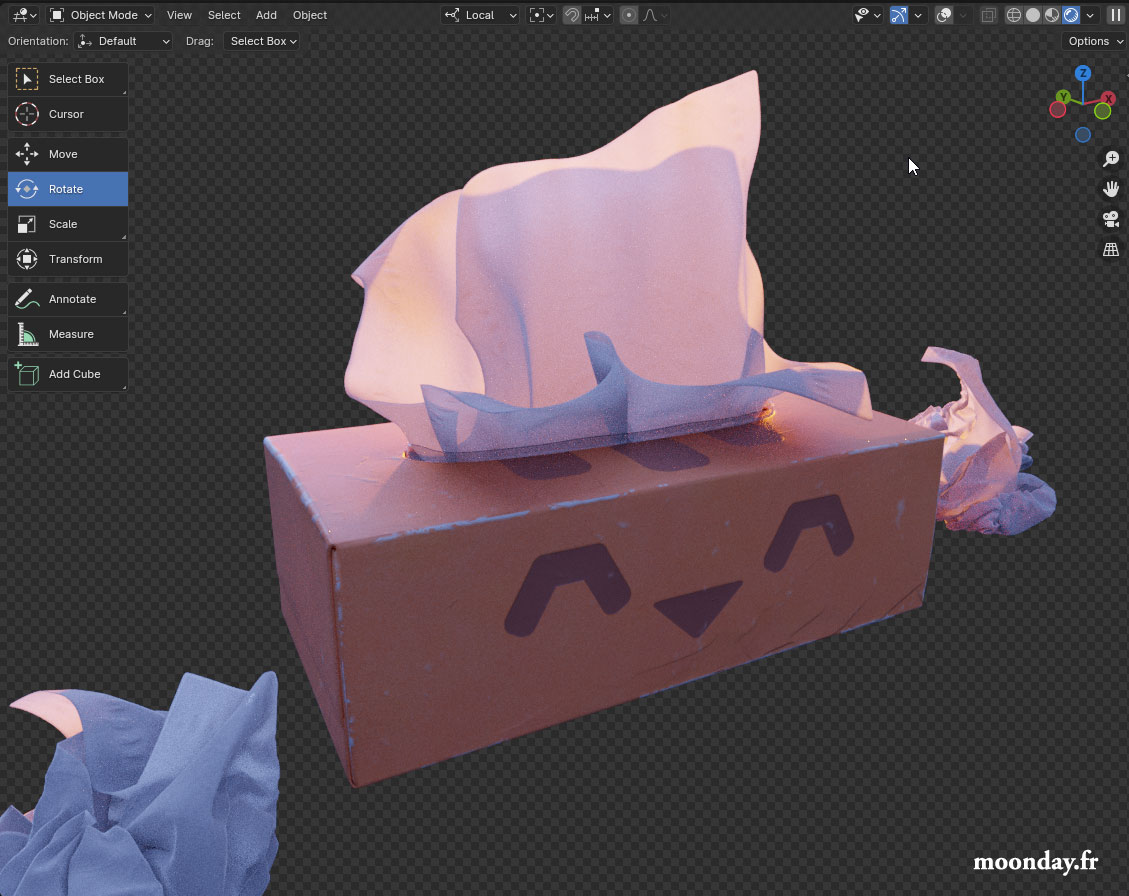

New models have been created: headphones, fully modeled and unwrapped in Blender to push myself to learn the software a bit more. Everything was quickly textured along with other props. Other models have also been adjusted, like all the bedding, including the duvet, on which I spent a lot of time working on the base material to achieve a tangible fabric.

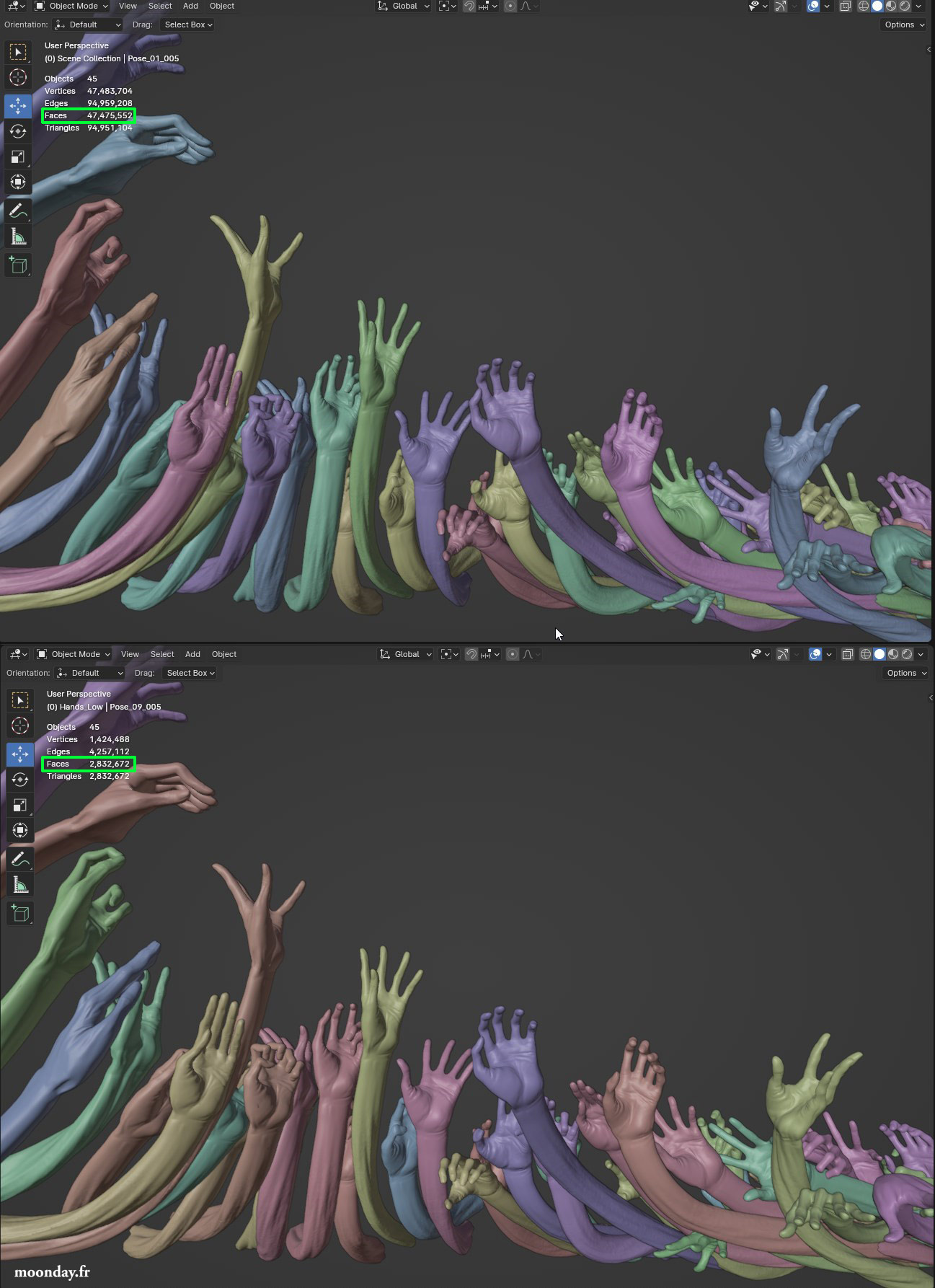

As mentioned in the optimization section of this article, the hands were optimized through a process in Zbrush to obtain a lighter model that takes less time to load during rendering. The same applies to the hands of the main character.
TT_WIP_20_01
47.5 Million polygons to 2.8 Million polygons

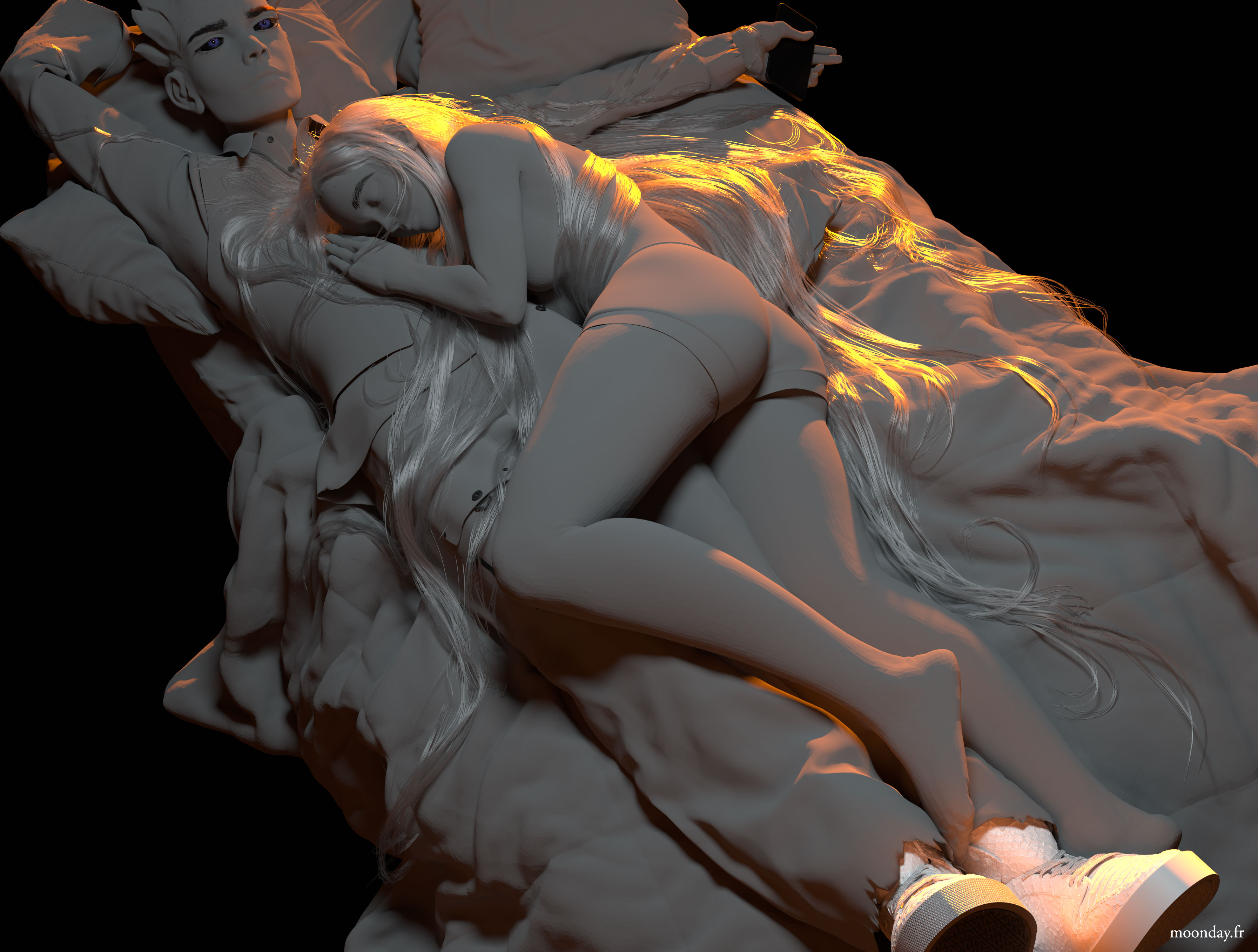

Lot of months without any updates! A lot of things have been going on in the artwork.
The most important news: I’ve upgraded my machine and I’m now able to fix many performance and rendering issues. More at the end of this post.

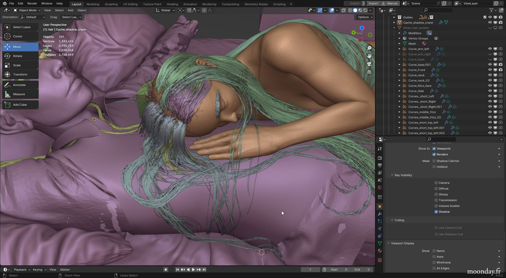

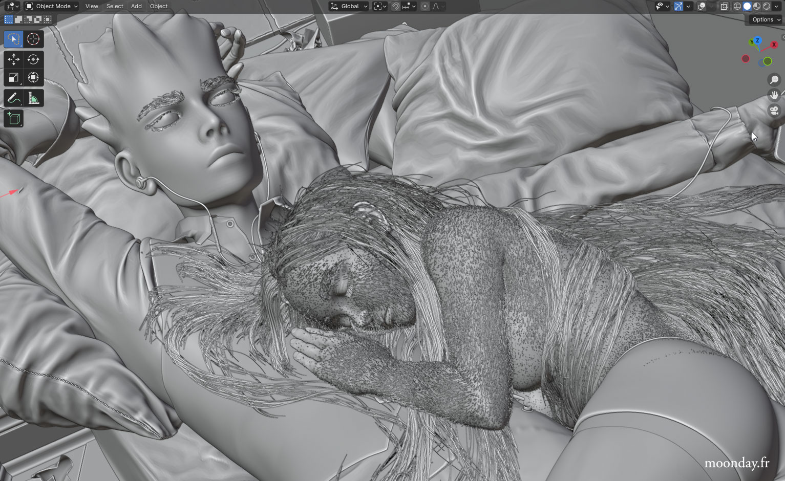

Hair & fur

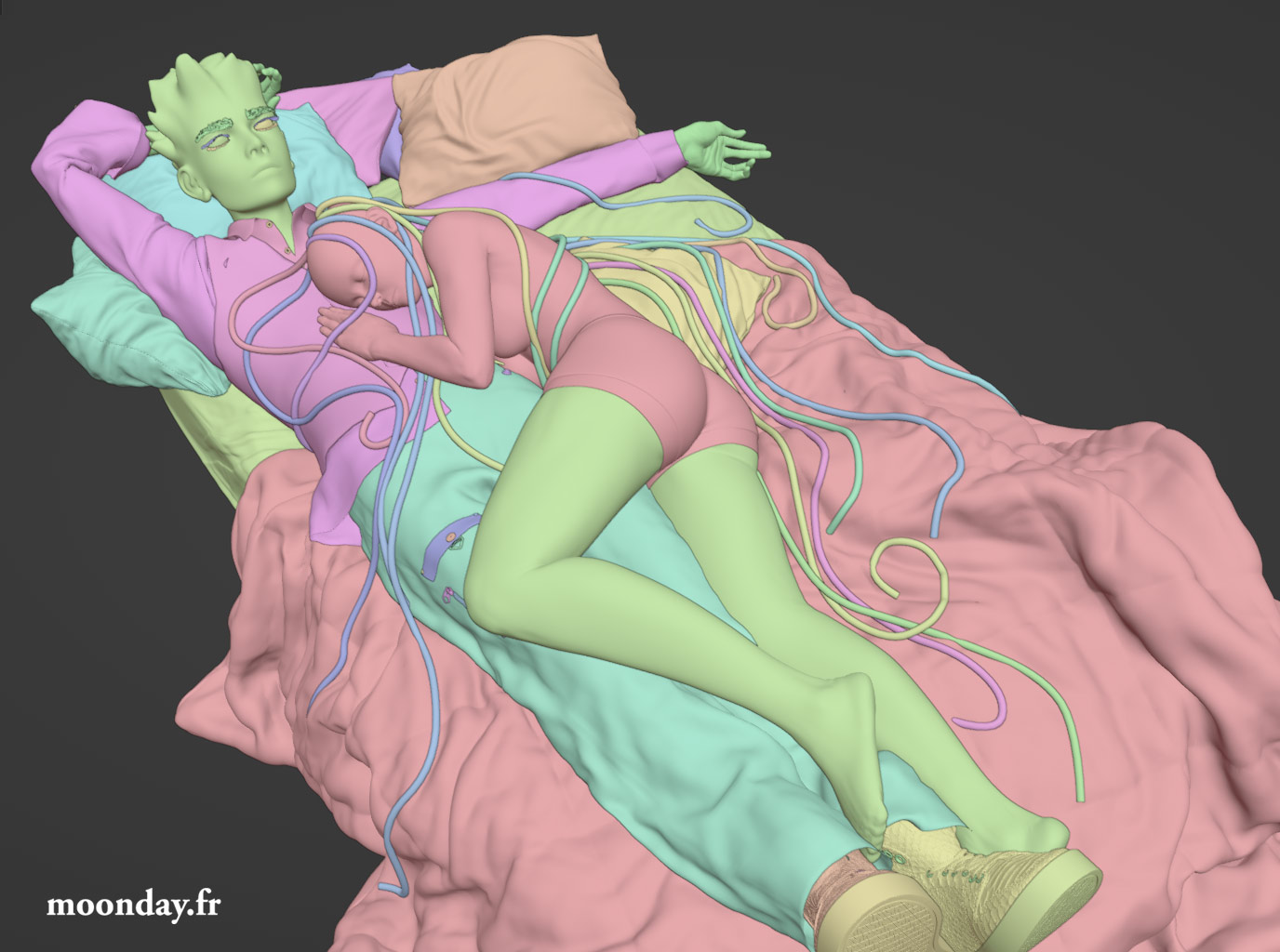

The woman has now nice long hairs running all over the bodies and bed. I heavily relied on Geo nodes instead of using multiple modifiers, I needed as much control as I can get in Ornatrix. The overall volume will need more work in the coming days but the main shapes are there.
TT_WIP_21_01
TT_WIP_21_02
TT_WIP_21_08
TT_WIP_21_07
Body hair is visible in the final resolution

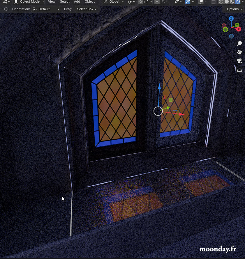

I dediced to test a different light scenario, first by playing with light passes colours in compositing then by editing light temperatures in Blender and by adding new light sources. I want the viewers to feel the duality expression of the artwork.
TT_WIP_21_06
The very first test of the new lighting scenario
TT_WIP_21_03
2nd version
TT_WIP_21_04
3rd version (trying to mix the old and new light scenario) + notes on adding elements

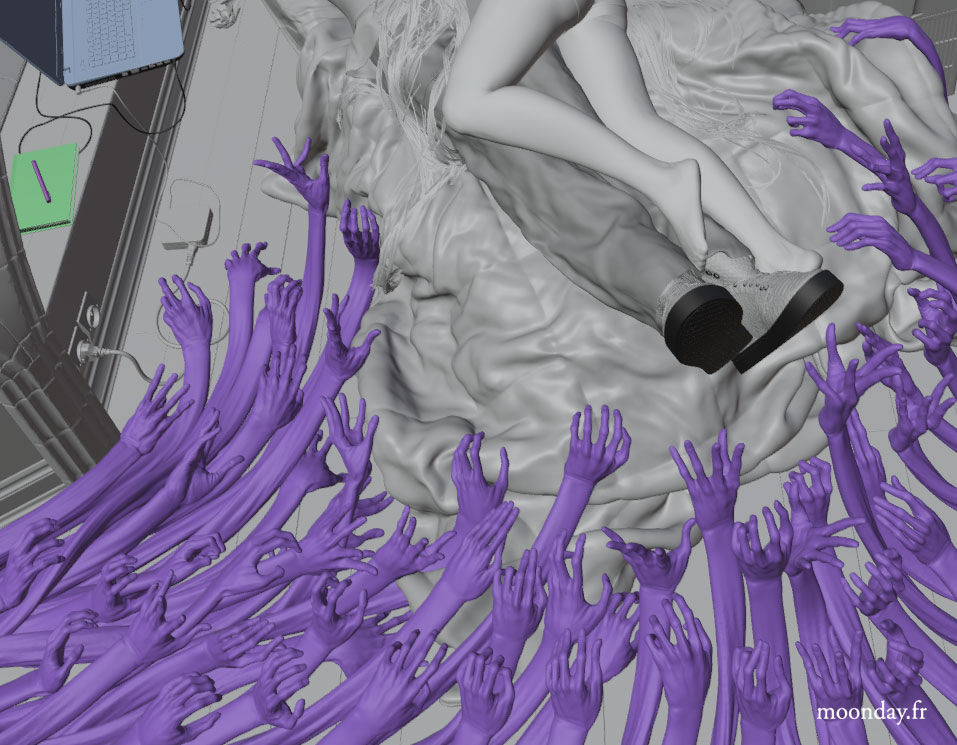

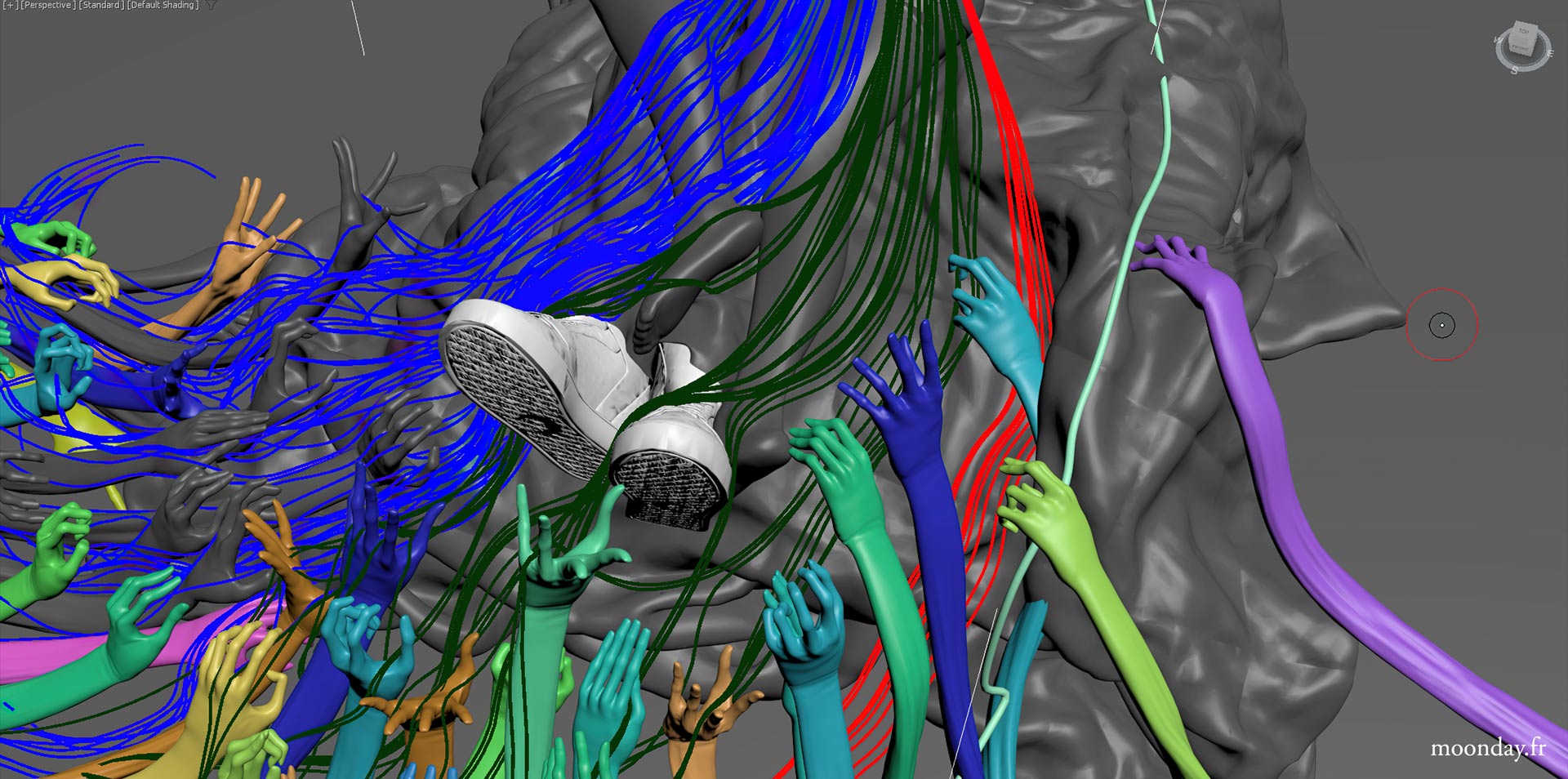

Give me a hand
After some render tests, again, I noticed which details could be edited, modified to complete the picture. Basically: more hands and soon, more details on the faces. About this last step, I still wonder if I’ll go with texture editing in painter or create an paint over in post…
TT_WIP_21_09
2 or 3 more hands are still missing

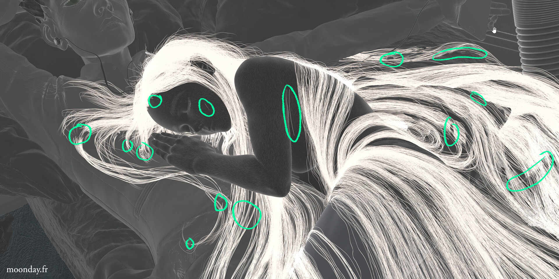

Specific render passes helped to better visualize collision issues
