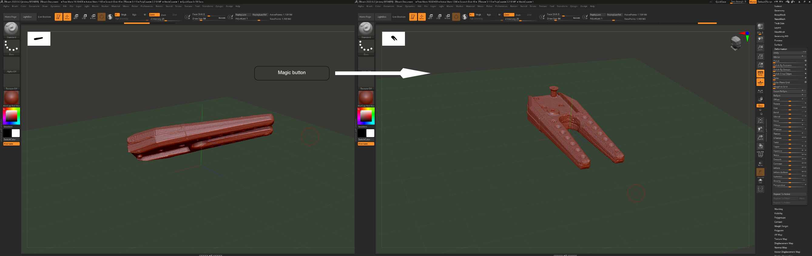

I work a lot with 3D scans in the medical field, and my problem is that the model imported into Zbrush never has the good orientation and I would like to know if there is a trick to quickly align the model? a bit like the zwrap plugin, we select an area we click on alignment and the model aligns with the grid for example.

Thank you very much for the response and the responsiveness, unfortunately it does not work, the object is already well positioned in 0, 0, 0, but it lacks the right orientation see the example:HELPZBRUSH
I see what you mean now. As far as I know, there is no 1 button solution to do this. You will have to align it manually. Using the Gizmo 3D along with Shift key to snap it to an orthographic view will probably be the quickest way.

Hi @Jerem3D
You can probably get a reasonable alignment with the Gizmo. With the Gizmo active, hold ALT and drag from one vertex on the model to another. The Y-axis of the Gizmo will align in that direction. Then press the Reset Mesh Orientation icon (rewind icon) and the mesh orientation will adjust so that it points with Y up. You can then rotate with the Gizmo so the model faces how you want. Alternatively repeat the same action for two vertices in the model X or Z direction. Hold ALT and rotate the axis so that the X or Z axis rather than the Y aligns to the two vertices. Hold SHIFT while rotating to snap rotation to 5 degree increments. Then Reset Mesh Orientation again.
There’s also Set View Perpendicular in Zmodeler:Polygon actions. So you can pick a polygon and it will reset the camera view so the polygon faces directly at the camera. Then ALT click on the polygon with the Gizmo and ALT-rotate so the axes are oriented as you want. You know the view is perpendicular so one axis is facing the camera. Once done Reset Mesh Orientation so that it’s not just the camera view that has been adjusted. Might help to make your target polygon a unique polygroup color to help visualize the result.
