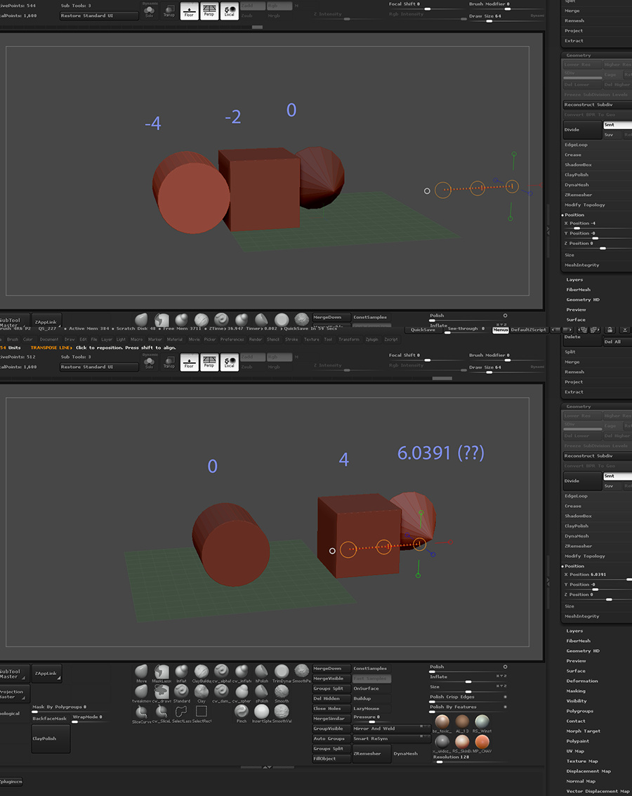

The sliders/ui update does seem to be the thing flipping out though. Something fishy going on for sure. It kind of works, except the non main subtools seem to move exactly double the amount I would expect. Sometimes in the wrong direction!
Thanks for the tips though. I will post some pics so the idea is clearer.
It’s OK, did you try it? It should work OK the way you want.

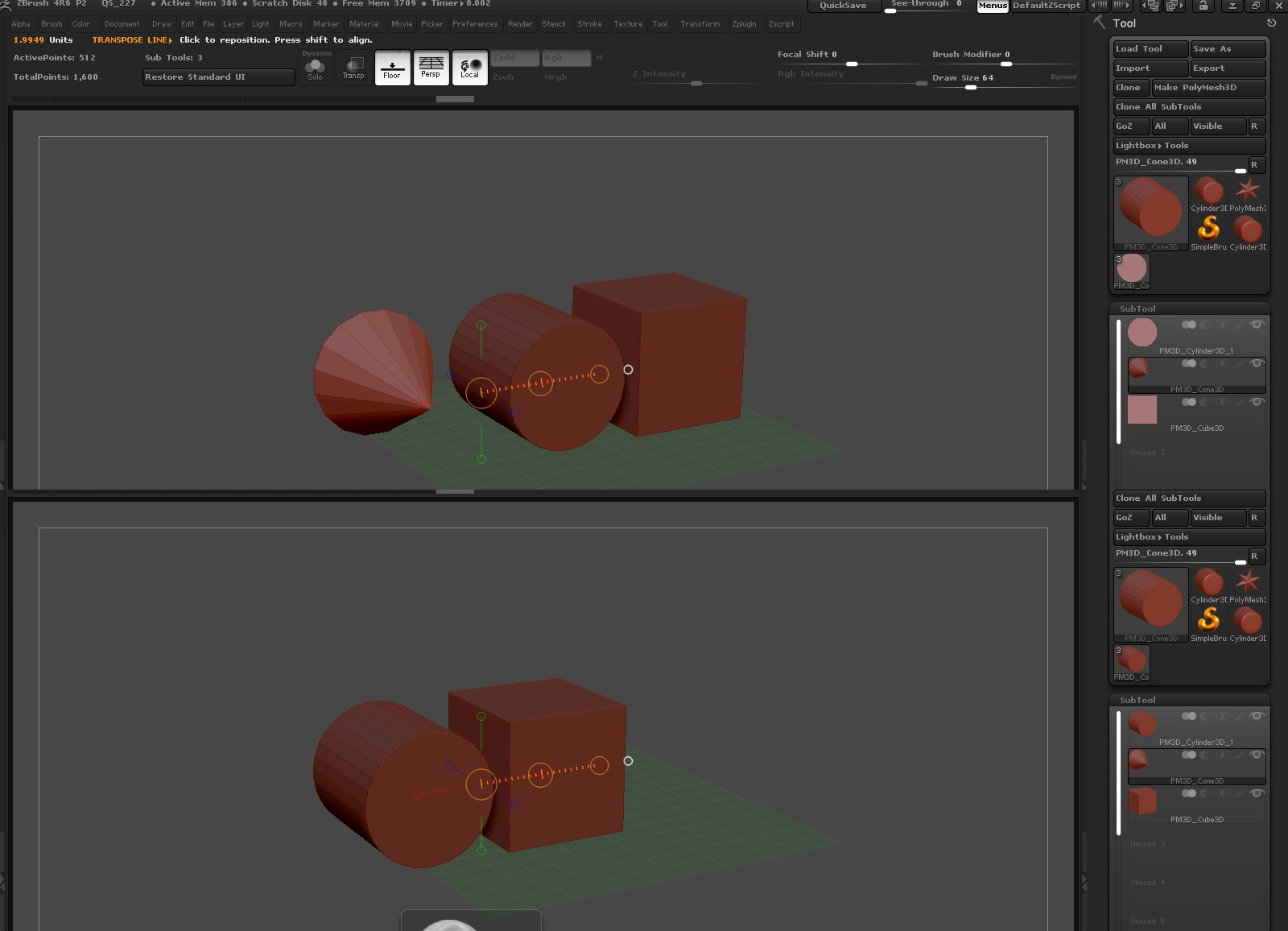

Using my code has the effect you were after. ZBrush adds the value to the slider’s current value instead of setting the slider to the value.
See the pics for an example. (the last pic is on the left!)

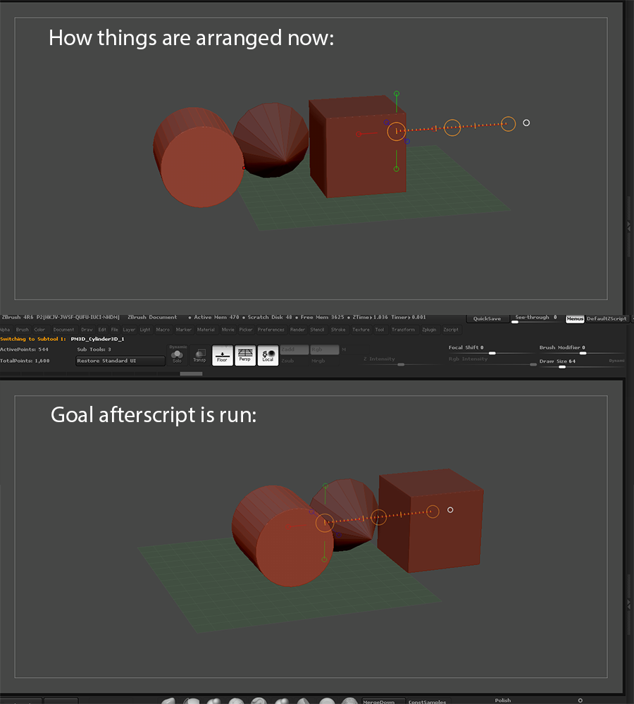

ok so here is the aim:
Hopefully the goal is clearer. One can work around it by starting a fresh tool with a symmetrical world space centred object as the first subtool and then re-appending all the other subtools to it. Just a ballache. It just caught my eye as ‘one of those zbrush things’ which I wondered if I could figure out.
If this clears the issue up and anyone still has ideas I am all ears.

The bit about Zbrush adding to slider value automatically is interesting. It might explain some of what I’m getting.
I have a mysterious offset of 2 and some floating point error looking stuff, but this is as close as I have got.

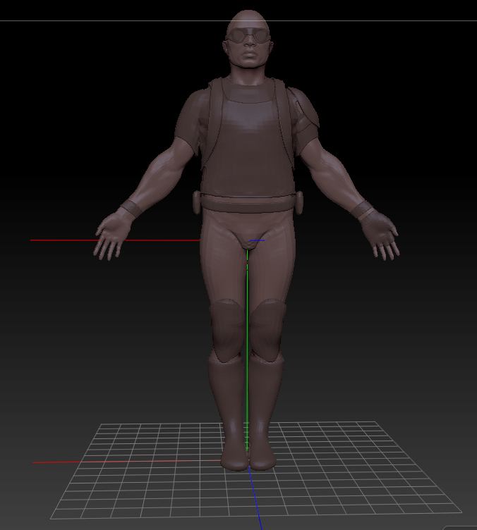

But after further testing I find that the results are inconsistent and I’ve not yet found out why. For example, the DemoSoldier, and the anatomy model (all 89 subtools) work perfectly but if I try to set up a test using primitives it will fail.
There’s obviously something going on under the hood which is beyond the reach of zscript.

What you describe with the anatomy model is expected behaviour because the model is already centred (the top subtool is at X position = 0) when you load the file. The only way to test is to offset it away from the centre first and press the button to move the subtools. But if after doing that you reset the top subtool’s position to 0 and press the button again then everything is moved back to where it should be.
But as I said, there are situations where this code will fail. It’s something to do with how ZBrush stores the relative positions of the subtools. I may look into this at some time but I don’t have time right now.
