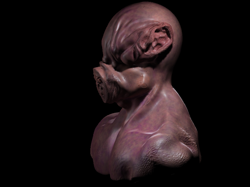

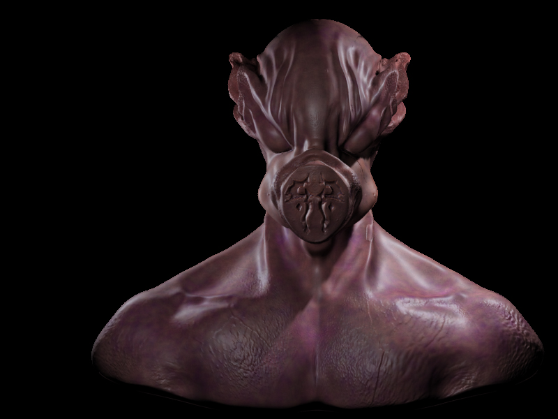

In all, here’s what i got. There were some artefacts around the neck area…Dunno where they came from.
Thanks once again okay??
Another view to show the problem area around neck properly
[attach=137283]Pig Hero.jpg[/attach] [attach=137283]Pig Hero.jpg[/attach]
Hey Teeto
Displacement map problems are sometimes caused by
  1. triangles in your mesh
  2. overlaping uv’s
Sometimes this causes problems when the mesh gets tesselated by the subdivisional approximation, at least it does in maya.
Keep going, displacement maps are painful so I feel your pain.
