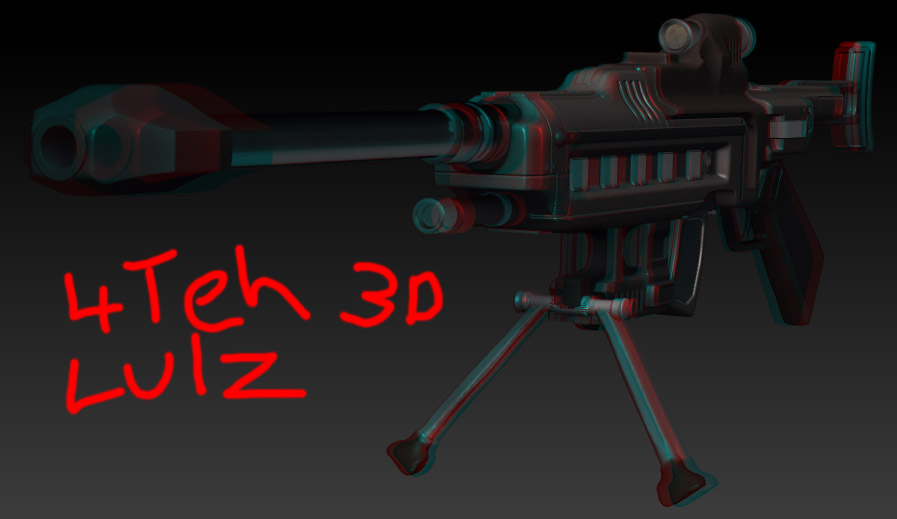

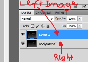

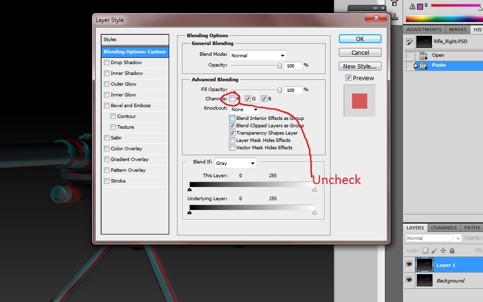

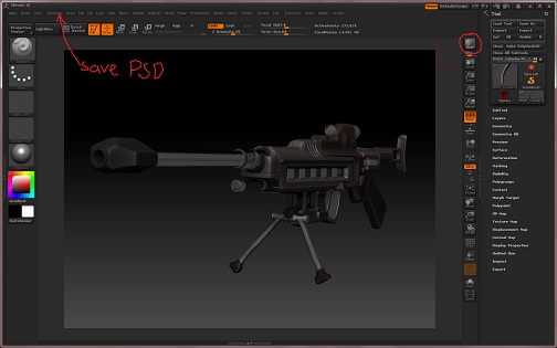

This Tutorial is for those who have Red and Cyan 3D Glasses and want to make their models come out of the screen and appear over 9000 times cooler than they actually are.
Please note, The Red side of the glasses is LEFT, and Right is Cyan

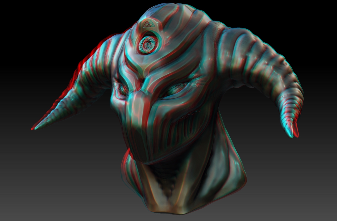

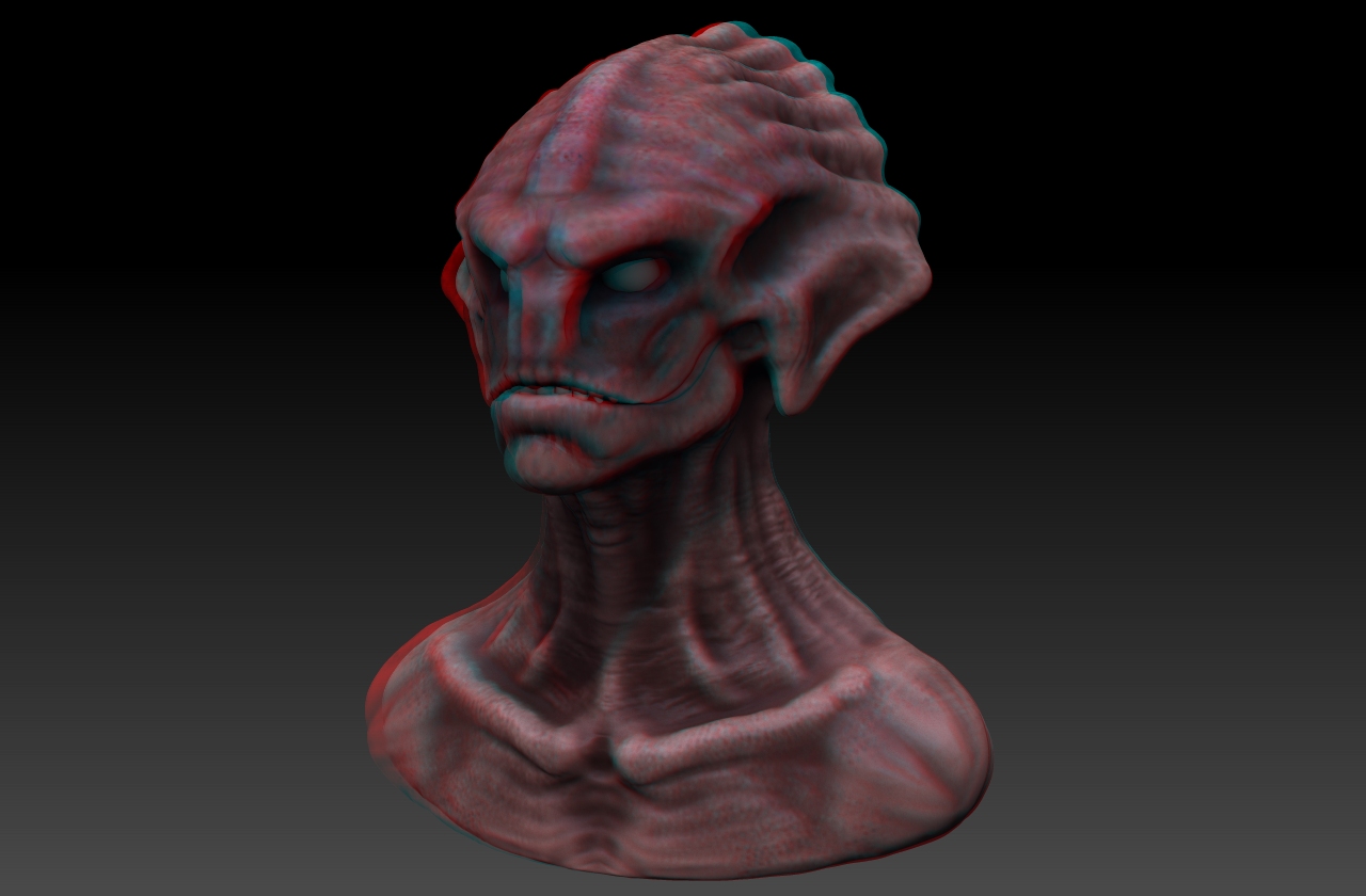

:+1:Thanks for sharing your technique. the first creature head really comes out of the screen. I recently tried the anaglyph render
http://www.zbrushcentral.com/showthread.php?t=69543&page=5&pp=15

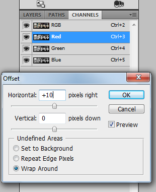

I basically copied the red channel from one render and pasted it into the red channel of the other render.
There is an alternative method one can use as well. This is the result of making something I did while learning zbrush and turning into a 3D (anaglyph) image in photoshop.
You can then use the selection options in photoshop to pop specific ares of the image (say cheek bones) with a positive value and push back areas (eye sockets) with a negative value.
This is mainly useful if you have a 2D image that only has one perspective, but it works none the less.

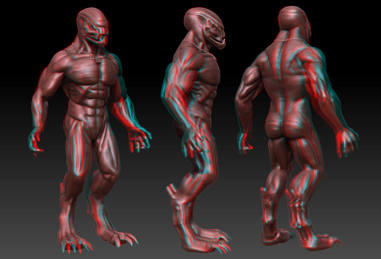

Post your 3D Images on this Thread! Lets get a 3D Thread Going!

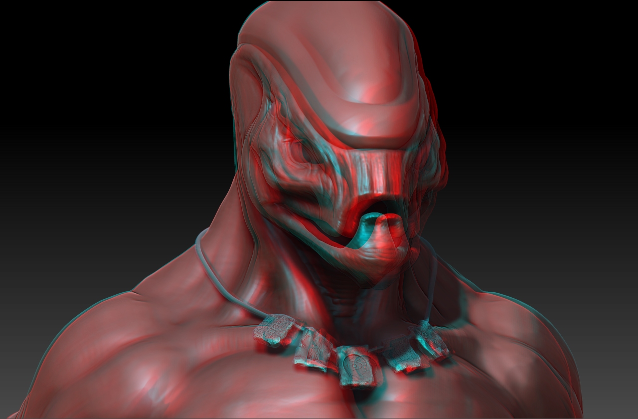

[attach=265512]FullAlienBody.jpg[/attach]

@u3190:
By the way, you interchanged left and right at the back view (the very right one) of your monster. :wink:

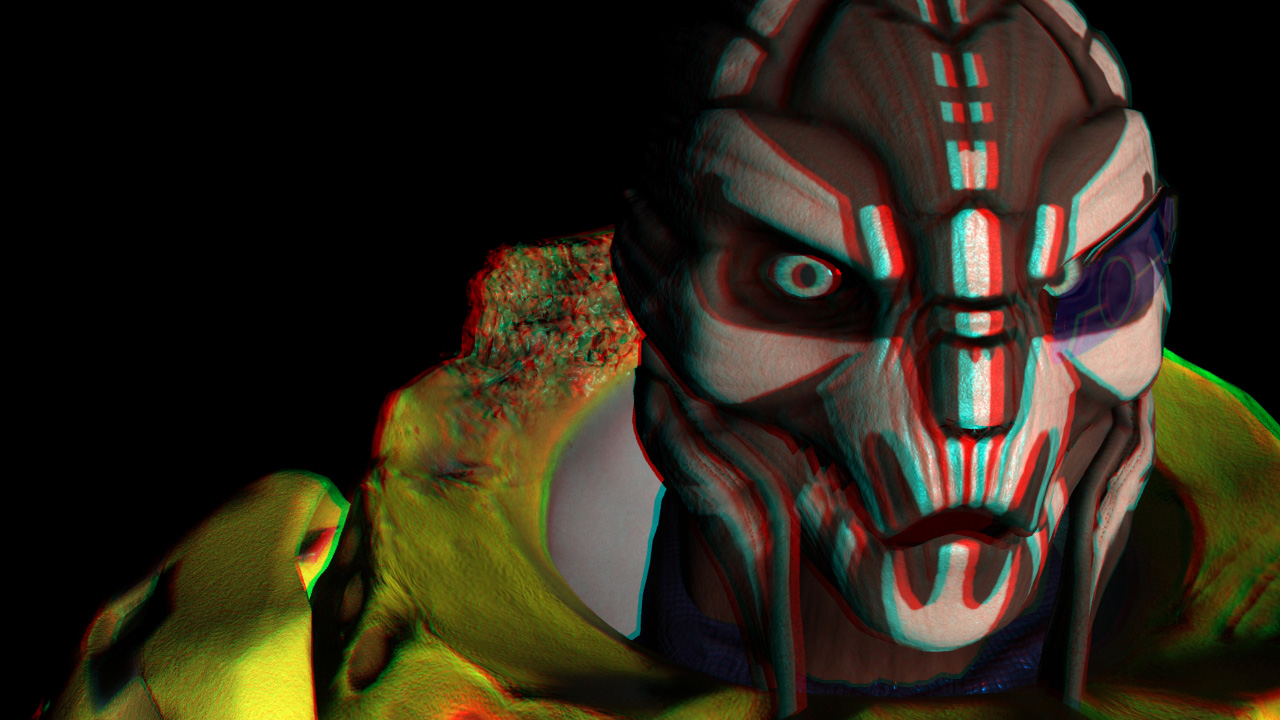

POST YOUR BEST MODELS IN 3D I WANT TO SEE THEM :smiley:

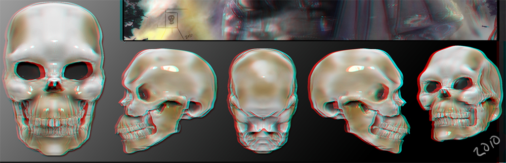

[attach=265650]The Interview.JPG[/attach]
[attach=265651]Aurelius_head.JPG[/attach]
