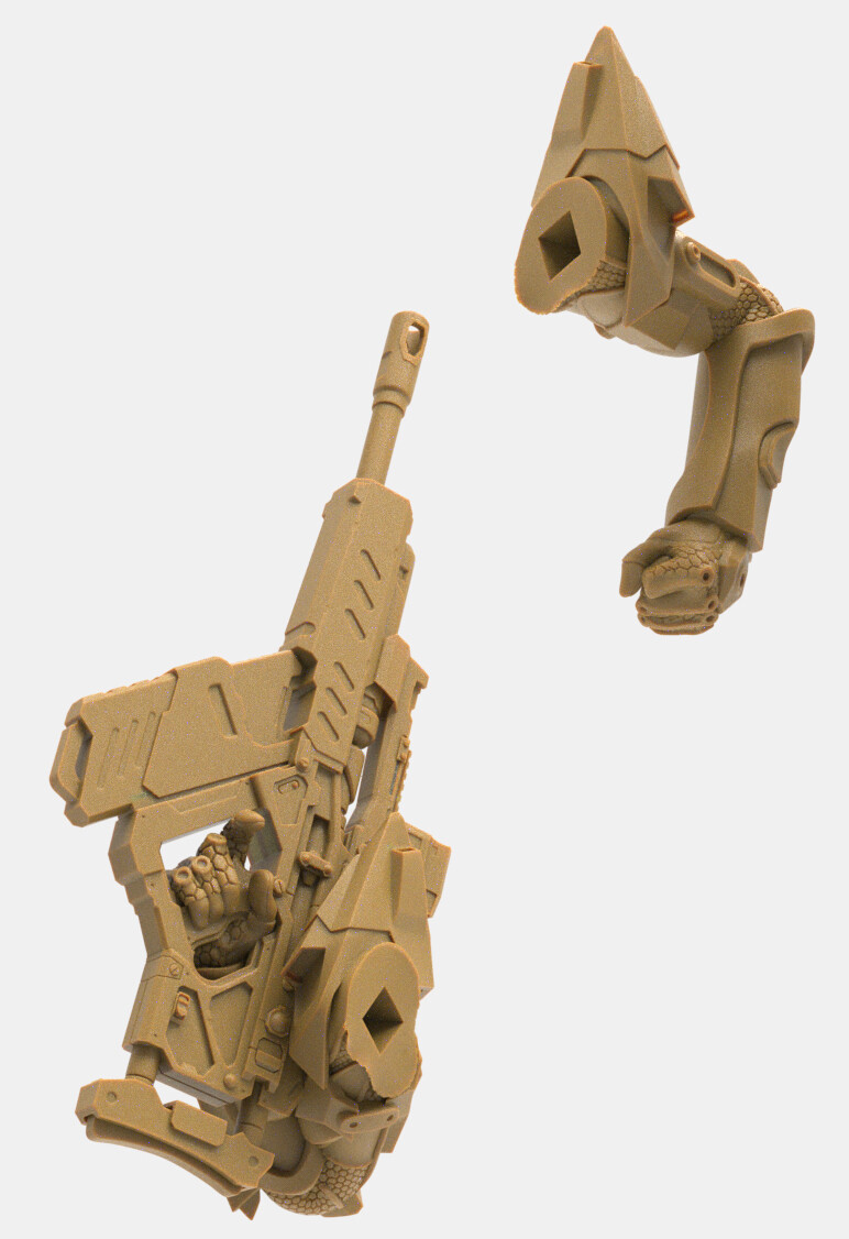

Did this a while back. all in Zbrush, with around 90% modeled with Zmodeler.
1:12 scale multi-part/keyed collectible. Commissioned by Atlas Support Solutions. Supports by Atlas.
(Design based on provided concept of existing real-time asset)

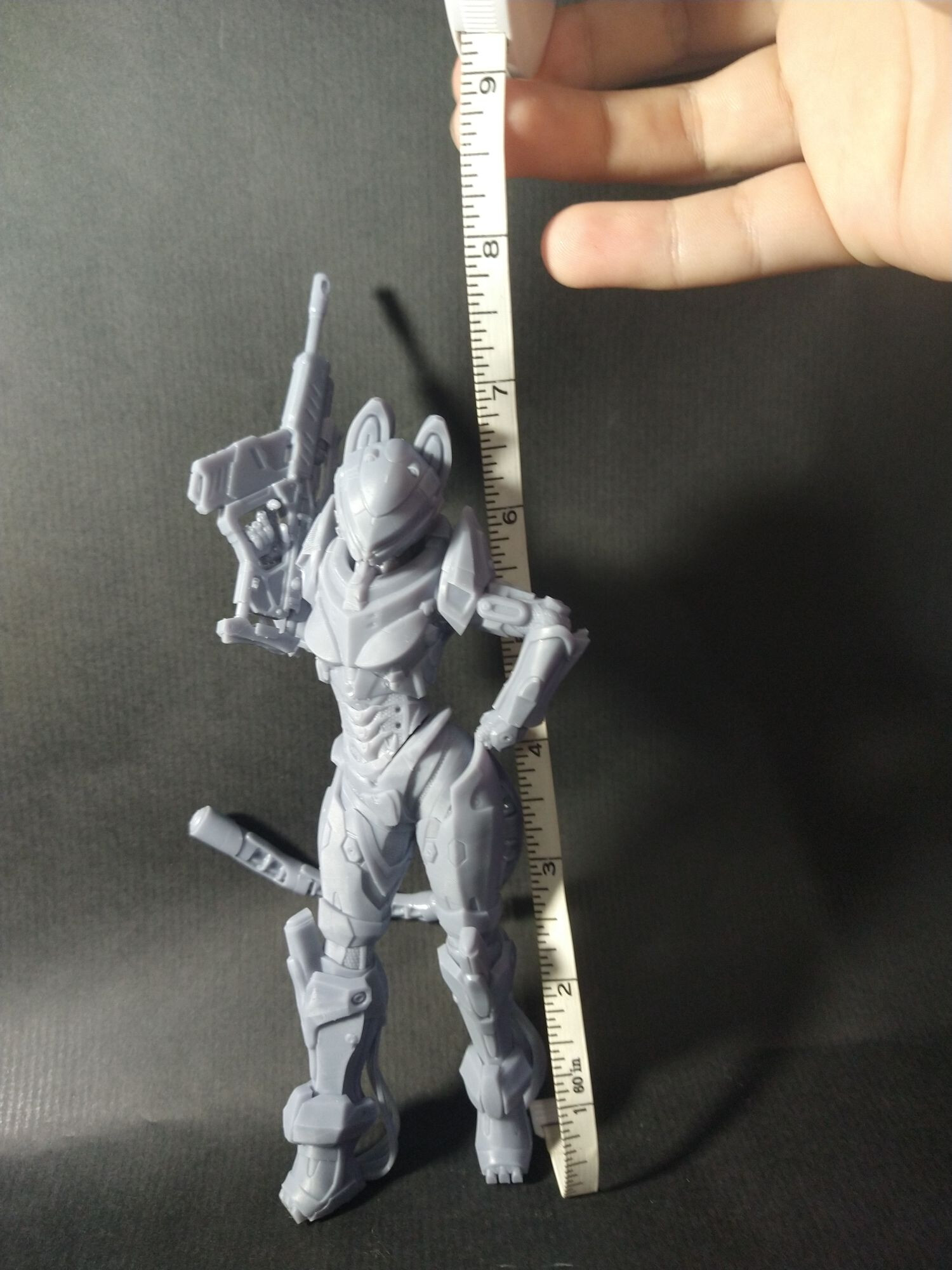

Prints

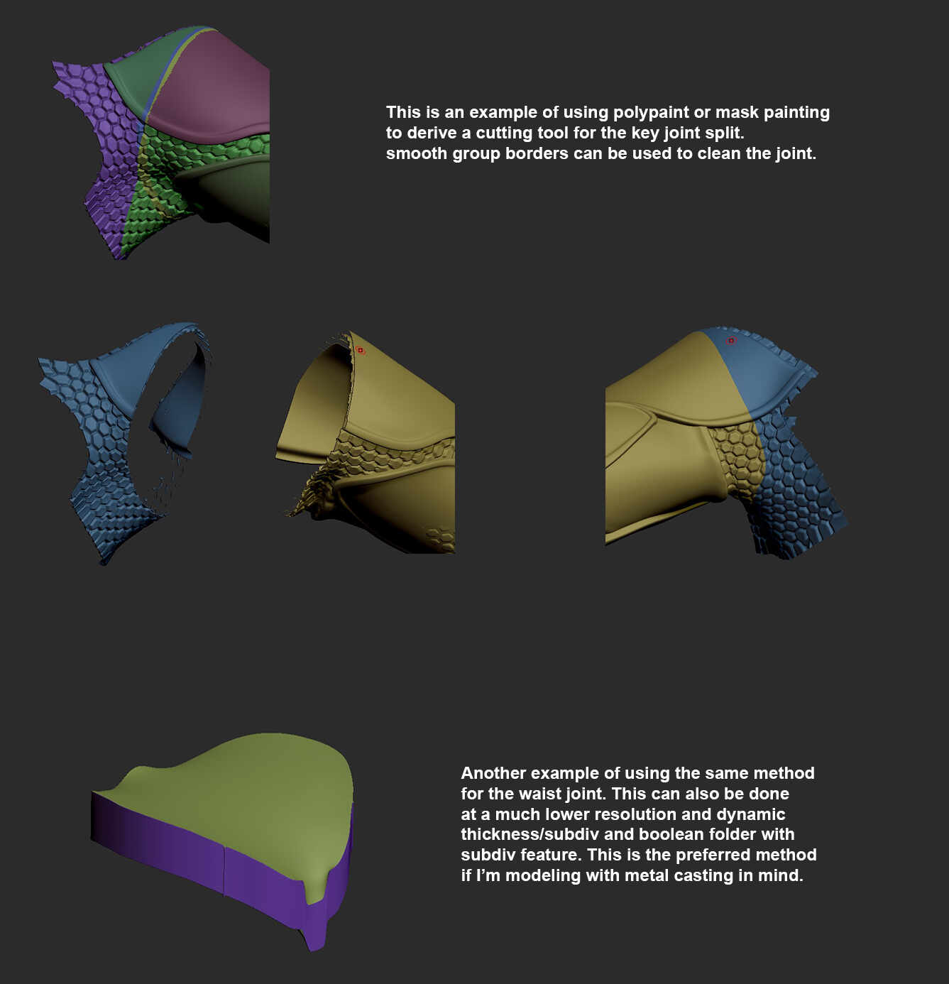

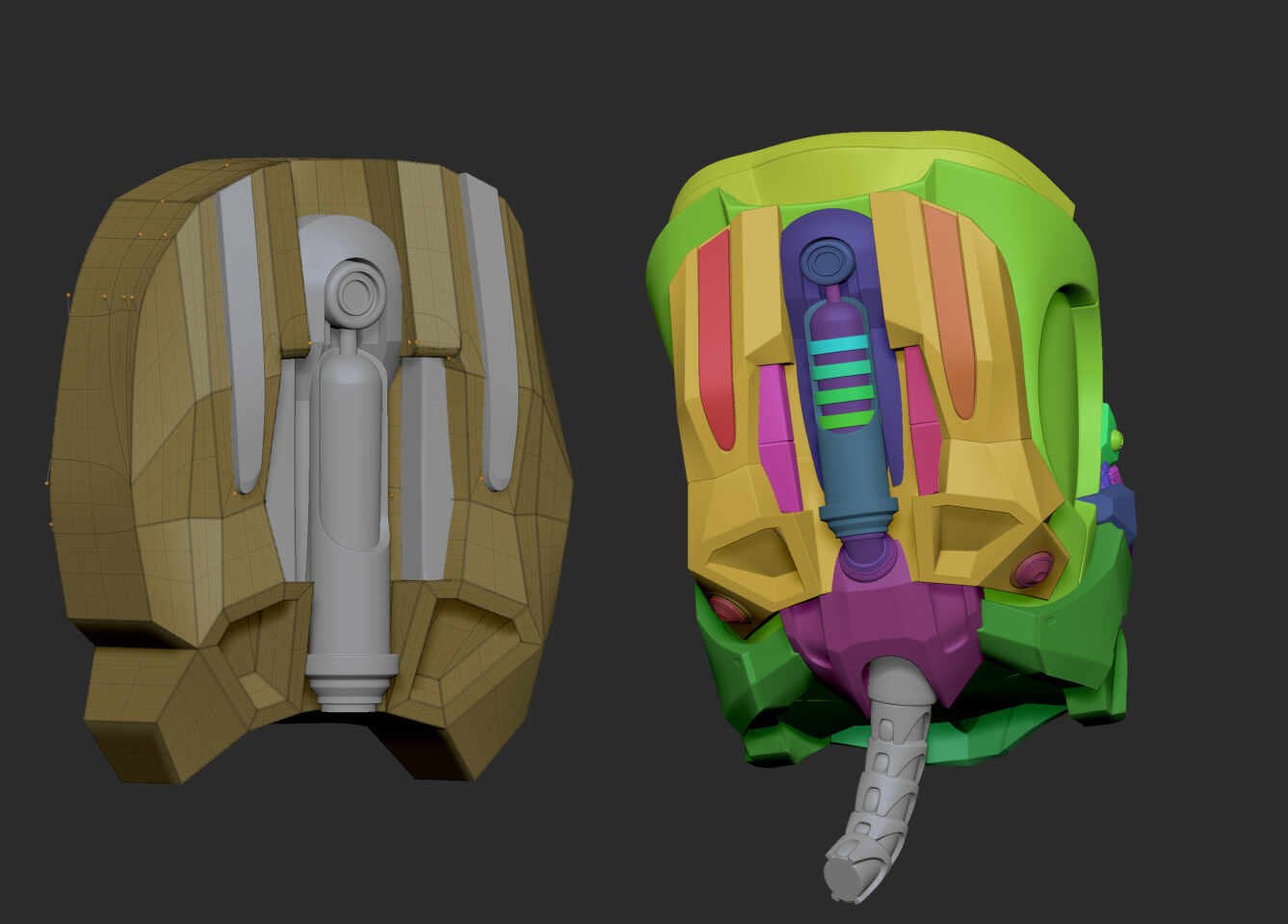

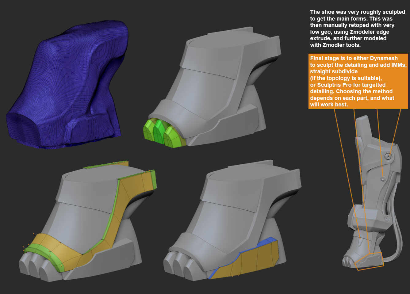

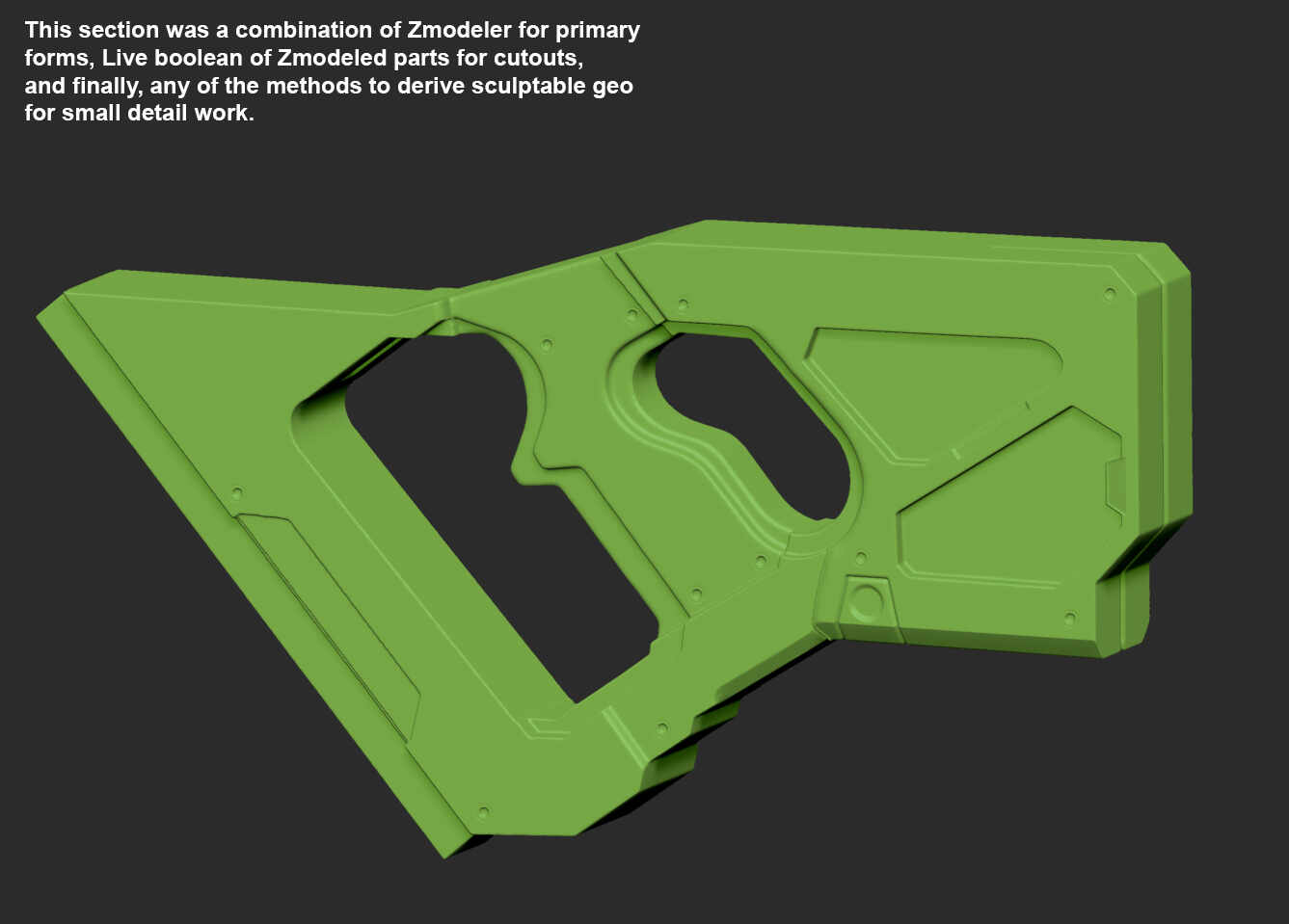

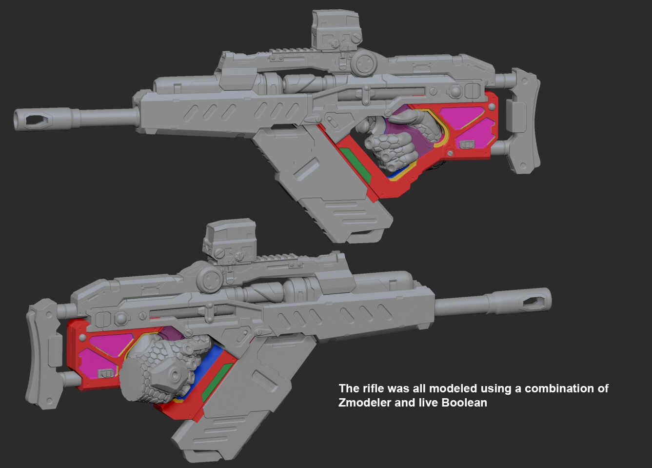

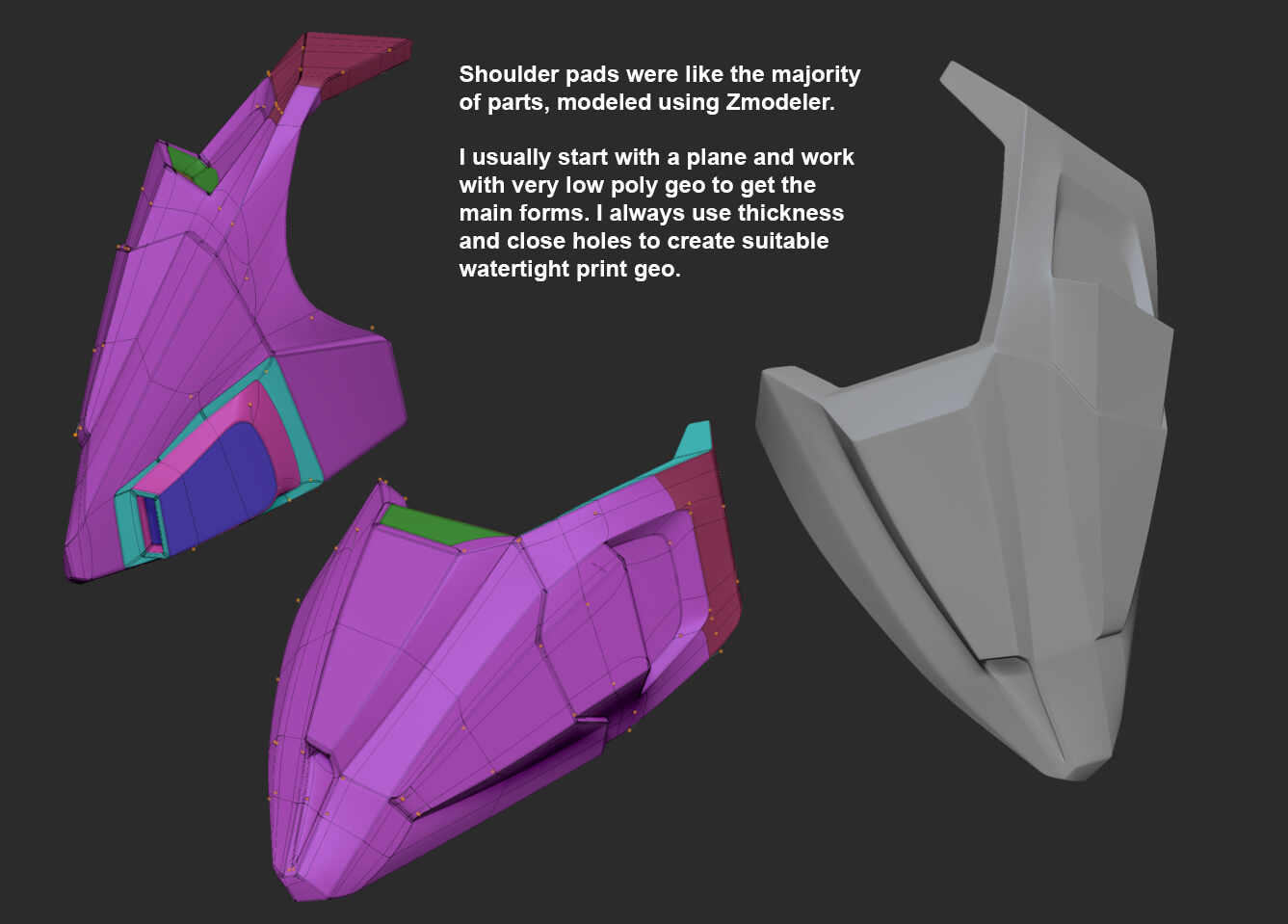

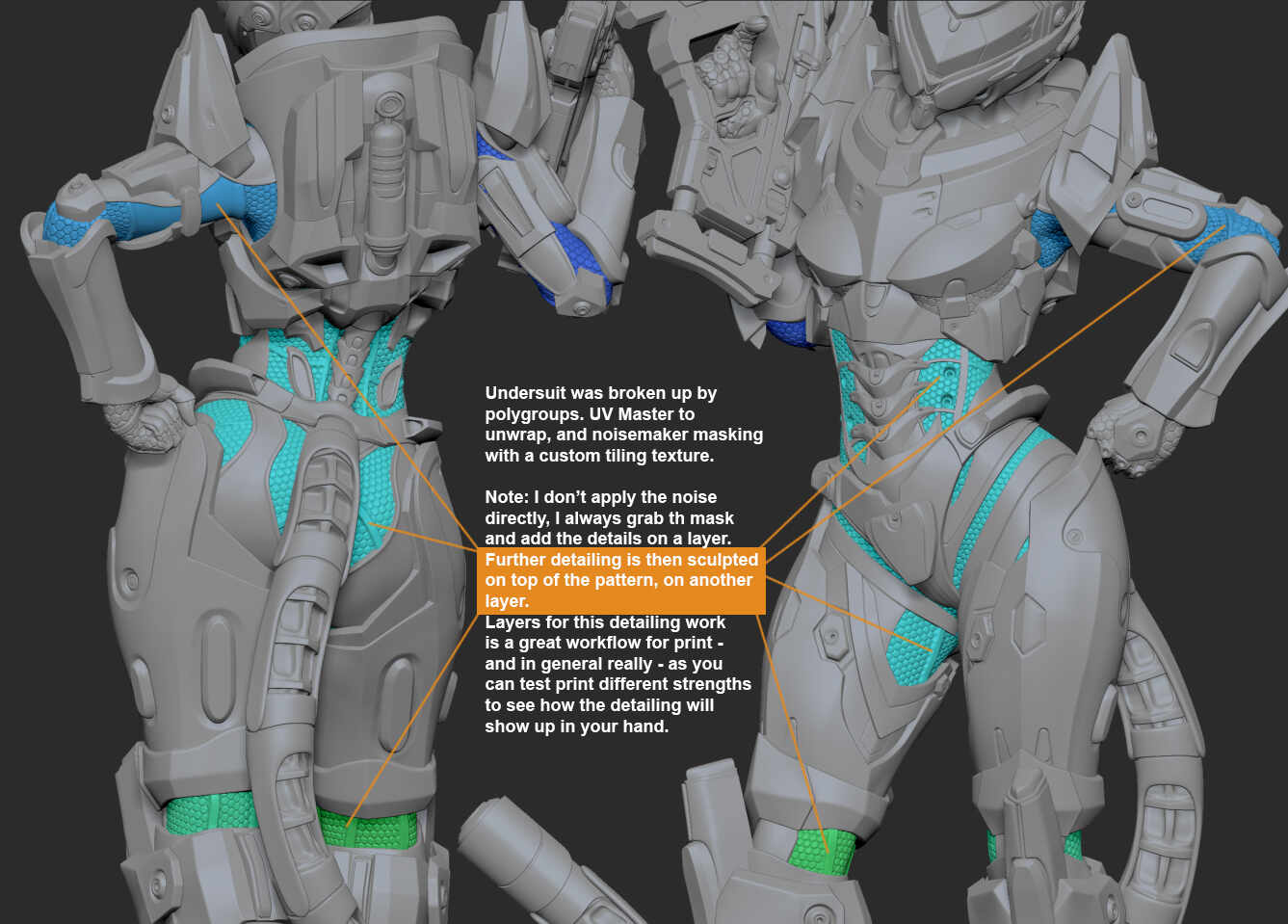

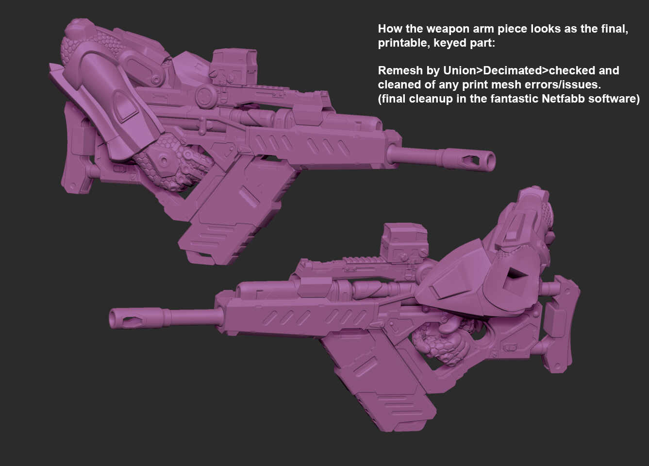

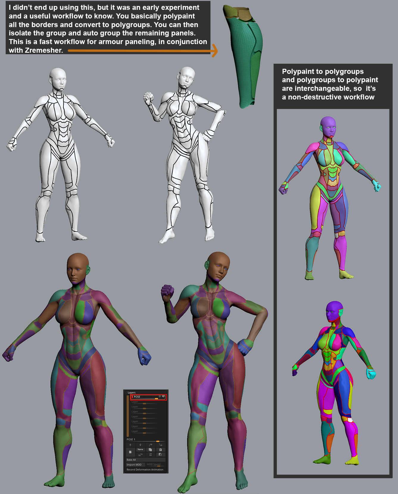

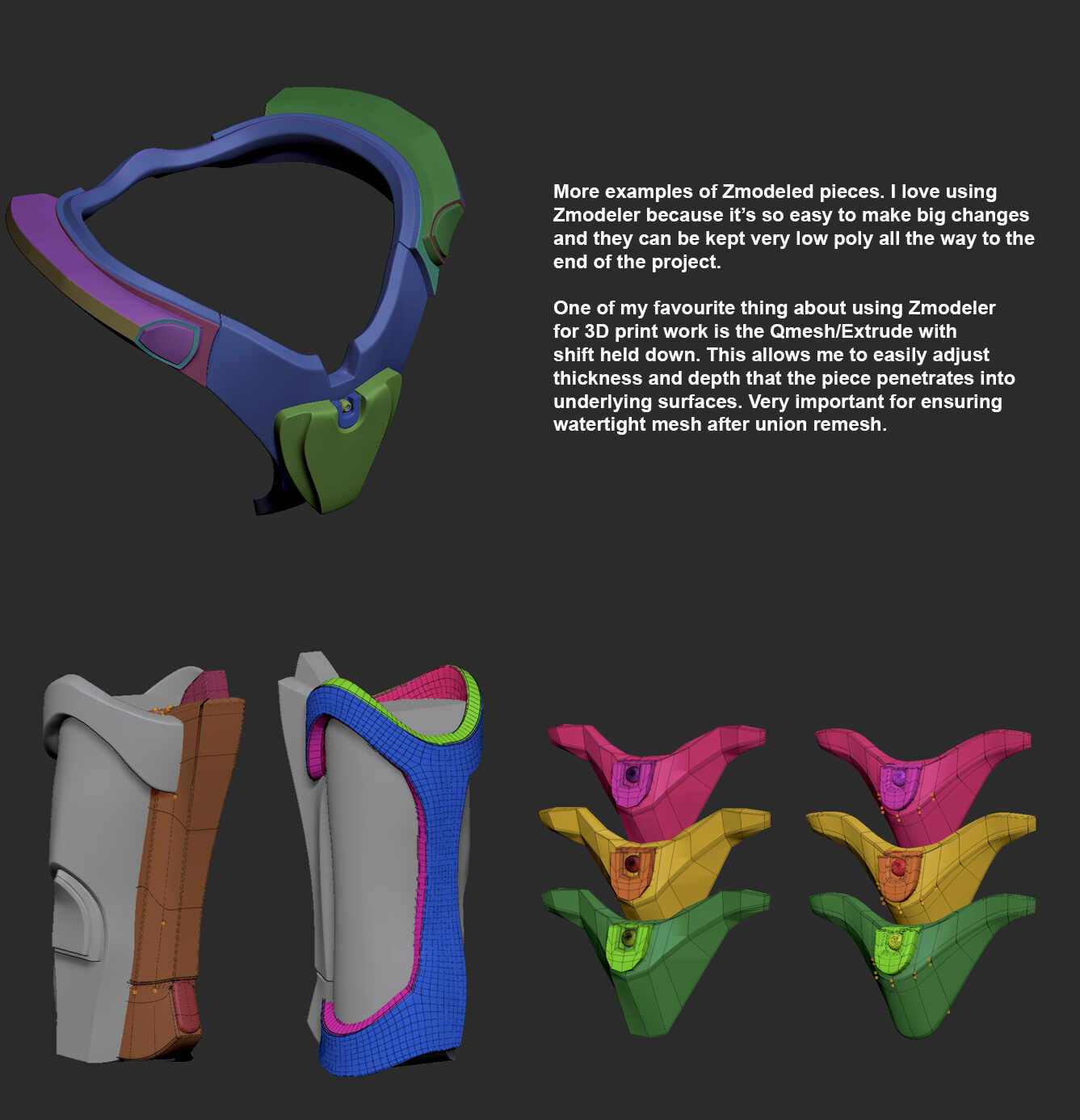

Thought I’d do a little breakdown of some of my process. As I mentioned above, most of this was modeled with Zmodeler. I’m a huge advocate for Zmodeler, and have been ever since my ‘100% Zmodeled Rhino 40K tutorial series’ back in the 4R7 days.
I’ve noticed a lot more people using it these days and I’m glad that people are finally seeing the power of Zmodeler within Zbrush’s amazing ecosystem of tools.
