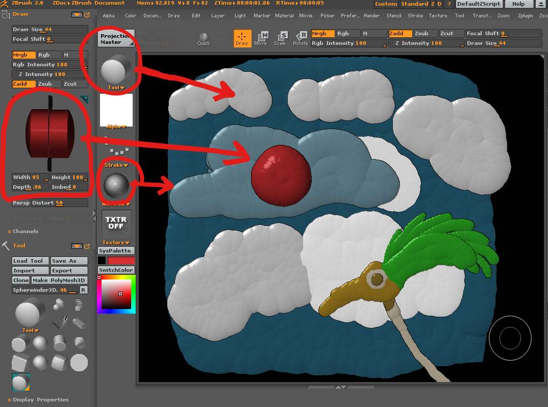

[attach=7486]z_depth5b.JPG[/attach]

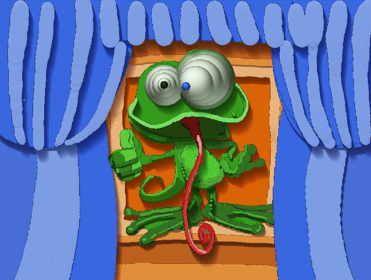

Jotajota, you are marvelous, I loved the froggy faced model and it’s cartoonish expressions. Great, man. You made me laugh.

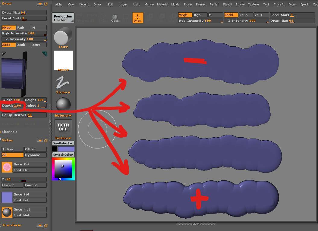

Pajonate…espero que ayude… :smiley: :+1: z_depth5f.JPG

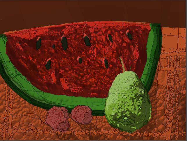

What you posted helps a lot, and I tried it before, but if you compare it with the post on the second page you’ll see that the object there are smooth inside, but I think that I figured it out. If you use the mouse instead of presure sensitive tablet you’ll get that result. With mouse you are having 100% pressure all the time and than the inner roudness of the tool is covered completely, and if you use a tablet, you can’t keep the 100% all the time. I hope this will help you also.
oK Pajonate ,pero lo que veo es que mientras se mantenga el valor imbed
en 1 depende de el valor en depth que se vea con mayor o menor volumen
el relieve :slight_smile:
la otra alternativa complementaria a lo que estas explorando es en el Panel Picker cambiar el valor del slider Z a -10, 10, 10,-40 para que logres trazados en diferentes planos de profundidad y cada trazo no es desdibujado por el otro (porque esta en un plano distinto).

I don’t understand spanish and I had my admin assistants help me with translation.I think I got what you said mostly from the picture, and as soon I get home I will try it. From the look of it (the picture) I think you nailed it. that is exectly what I was looking for.

1- select tool cilinder 3d
2- select stroke
3- select in  Draw  IMBED 1
4-select in Draw Depth (this is variable + or -)
5-select in Picker orientation (variable) and Z Depth -10 -20 -30 10 20    30etc..etc
6-paint in canvas

what jotajota stated in numbers is what i was trying to add¡¡
