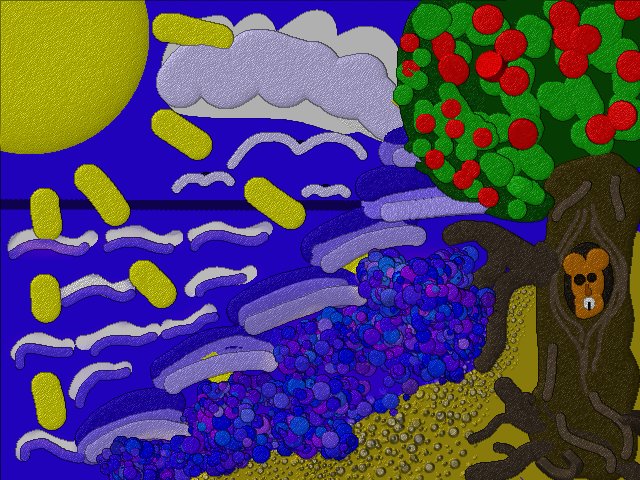

To say what Jay said, “This is so cool” !!!

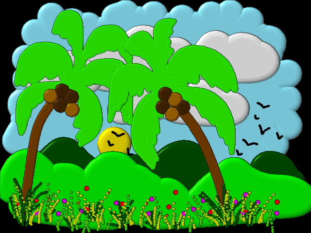

I’m hoping this looks a little less like Pix on crack…
[attach=7463]user_image-1001292264dzx[1].jpg[/attach]
-Muvlo (Having lots of fun, thanks Pix!)
![user_image-1001292264dzx[1].jpg](http://zbc-dev.zbrushcentral.com/uploads/default/original/4X/d/3/b/d3b0faed49e7eabb4d4a30d0a5b70b0d71144172.jpeg)

VERY cool, Jay (welcome and thank you for bringing this up again!) and Muvlo!
Thank you, Aurick, Muvlo, Juandel. You’re very kind.

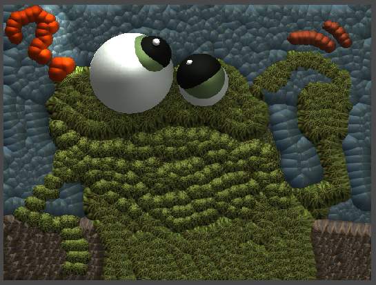

I’ve just started learning the demo, and the felt material was the first one I’ve tried to make. Pixolator did not specify how to make ‘felt’, and it took me a while to get it right. I also noticed that Pixolator doesn’t seem to have a problem I have when using freehand: the pixels on edges tend to jag by two instead of one. This is not the case on the stencils. Given that this is simulating felt, it is not the end of the world to have a jagged edge. But it is noticeable between the stenciled pieces and the freehand pieces on my test picture. I do not see the same problem in Pixolator’s pics.
Pixolator or anyone else, is there some setting that would resolve this for me?
Muvlo’s texture looks like colored clay, pressed flat and cut-out to create the picture. The light on the sun area makes it really look like a physical creation and not a virtual piece. That is neat. The other thing that it looks like is colored leather pieces.
Muvlo, did you intend to have the dark edge around each piece? I had the same thing with the felt pieces originally, and it detracted from the realism of my virtual felt. Many tests with adjusting the Diffuse Curve resulted in just about the right amount of shadow and highlight along the edges. The actual adjustment ended up being very simple.
Thanks all,
Jay
Thanks for your comments Jay and Juandel. Jay, I’ll give that Diffuse tip a try, thanks! And welcome to ZBC, hope to see lots more from you.

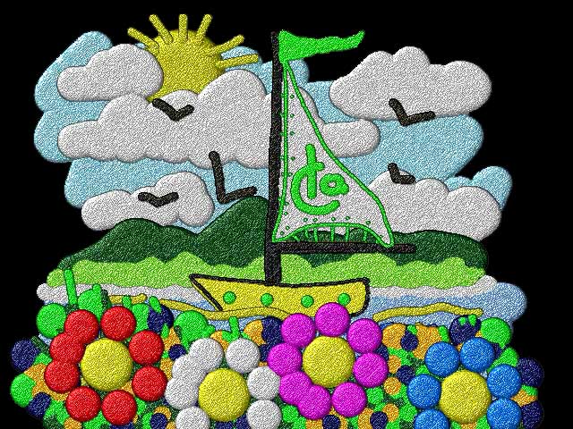

Here my first experience:
[attach=7464]user_image-1001419303uqq[1].gif[/attach]
[attach=7465]user_image-1001419339anr[1].jpg[/attach]
![user_image-1001419303uqq[1].gif](http://zbc-dev.zbrushcentral.com/uploads/default/original/4X/d/1/e/d1e2d70ba424076209a449de8c811552db90b5f1.gif)
![user_image-1001419339anr[1].jpg](http://zbc-dev.zbrushcentral.com/uploads/default/original/4X/b/5/7/b57fc501c3a77bb430a4fae873bb388e0fa96519.jpeg)
ah, brasil… wonderful!

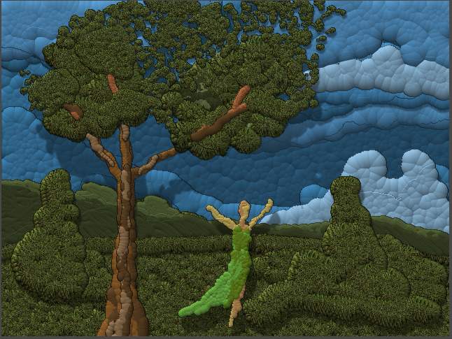

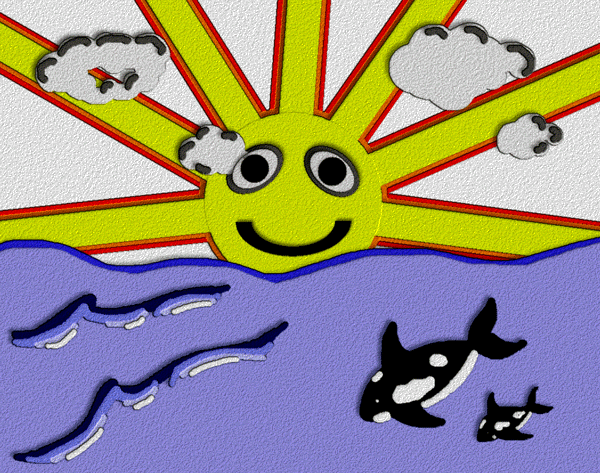

Ran accross this thread while perusing Pixolators threads :D. Thought Id play around with it. So I just kinda did something similar to what he did … plus I liked his killer whale
… so I made a baby one.
Dan
