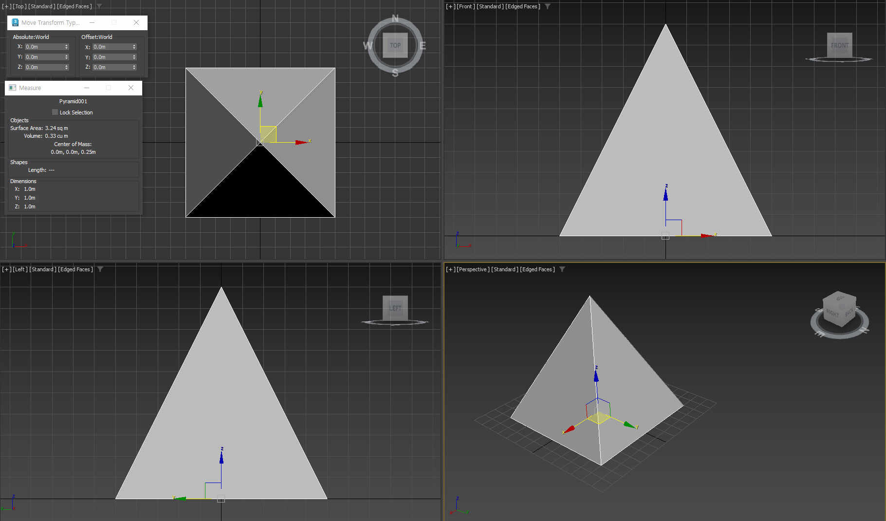

(Picture Attachment 1 - Max Pyramid)
After making a 1m pyramid in 3dsmax, export the FBX to ZBrush.
bandicam 2023-01-17 01-38-54-721
(Picture Attachment 2 - Zbrush picture attached)
Import FBX from Zbrush.
Then, import the ZBrush primitives with Append.
You can see that the position of the pyramid is strange.
If there is no problem, these should overlap each other.

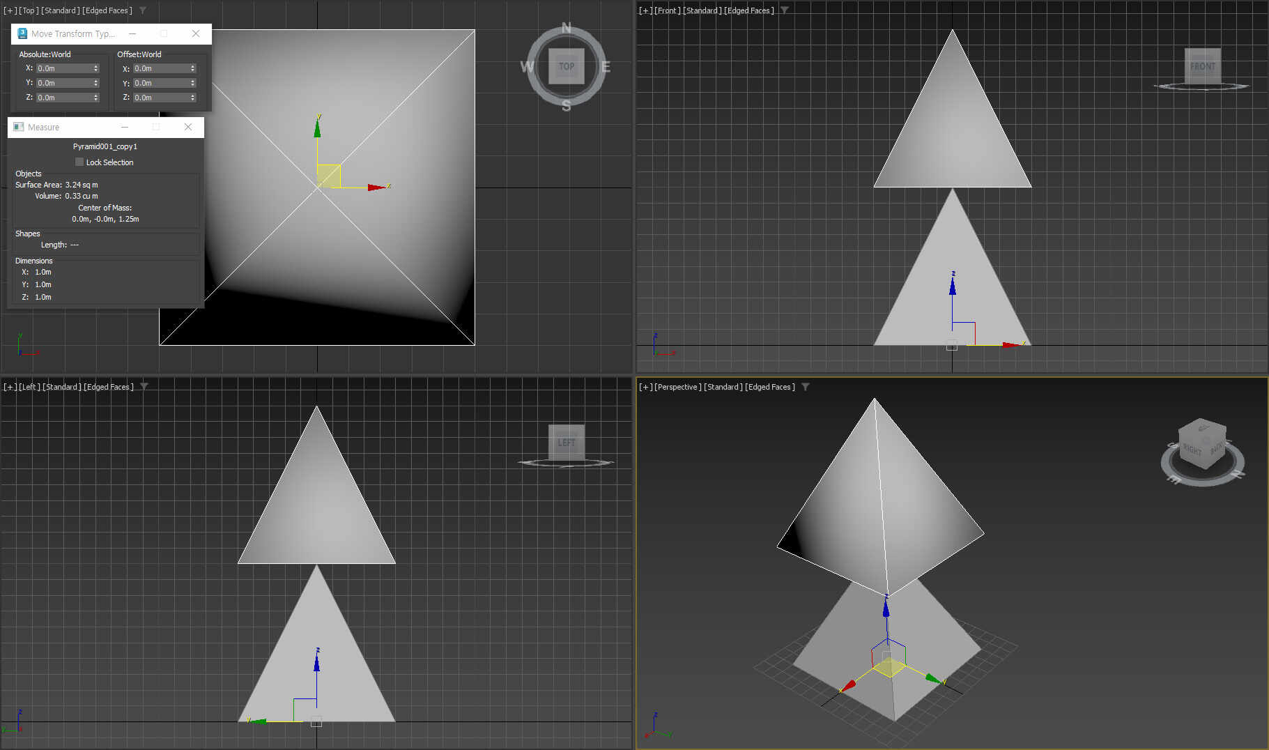

Again, export this pyramid to 3dsmax.
bandicam 2023-01-17 01-42-00-390
(Picture Attachment 3 - Pyramid stacked in two)
Pyramids have been loaded with a misplaced position. :frowning:

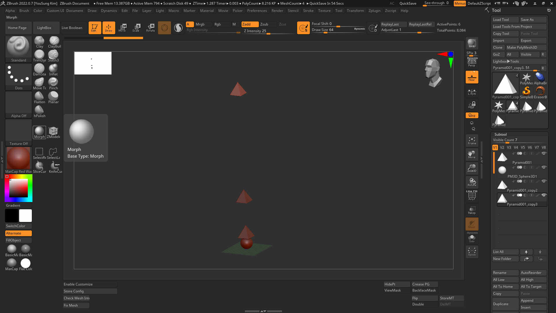

Shall we try again?
Let’s bring the upper pyramid back into ZBrush.
bandicam 2023-01-17 02-01-57-468
(Picture Attachment 4 - Distant Pyramid)
The gap gets bigger as you move away from (0,0,0).
The 2022.0.5 version or the 2021.7.1 version before I updated was not like this.

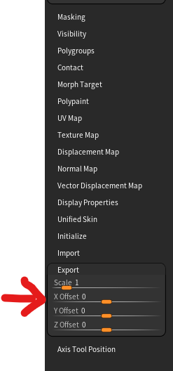

I stranded this thread from the internet search engine ocean.
This is memo for someone who strand too.
If this value is something different, set like below.
It maybe work?
Tool->Export
