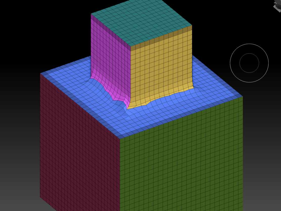

hi - I am just trying the new Bevel Arc Brush and have the problem that it messes up the sides when bevelling interior edges with ALT. The same happens with the Bevel Flat Brush. Masking the area does not help…
Am I doing something wrong or is this a bug?

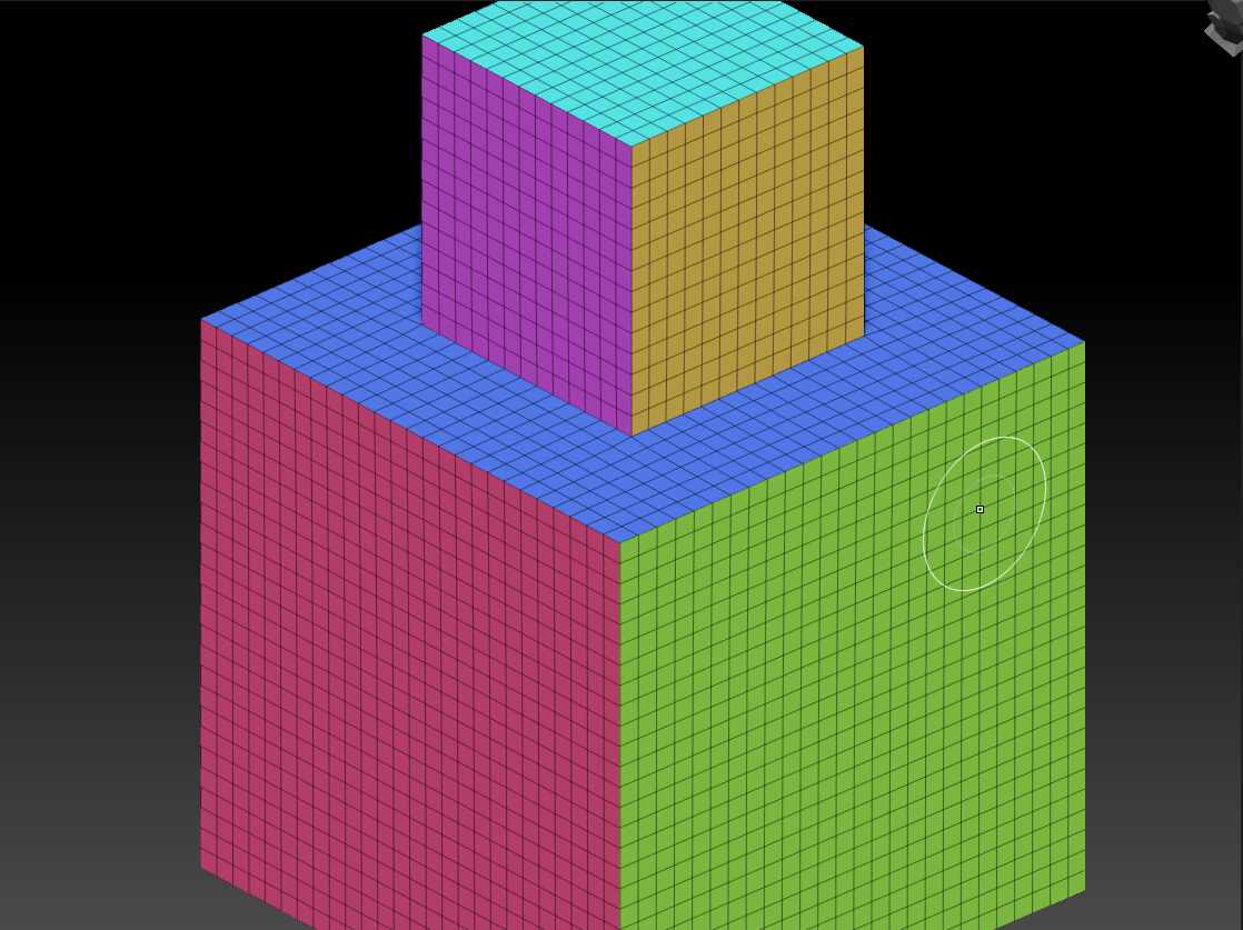

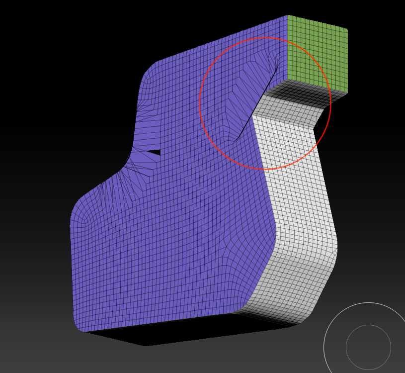

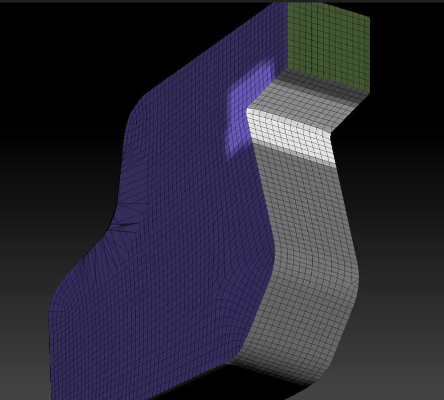

1_tool 2_sides messed up 3_same with Bevel Flat Brush 4_masking does not help 5_masking does not help-2

Your brush influence is pulling points from the sides. You may be able to diminish this effect by masking the sides and/or enabling Brush> Auto Masking> BackFace masking for the brush.
However, you are altering the shape of the mesh. Some stretching of the polys near the edge is unavoidable. For a simple shape like this, ZRemesher should be able to clean that up easily with either the “Detect Edges” or “Keep Polygroups” options enabled.

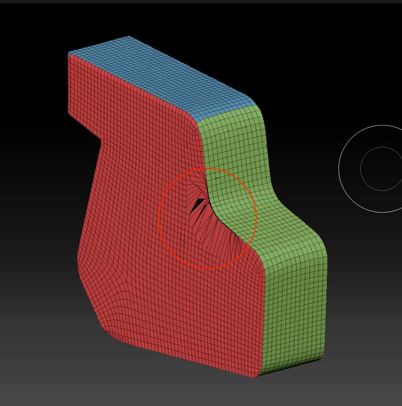

thanks for your reply -I agree: its cool for some situations but has a lot of limitations:

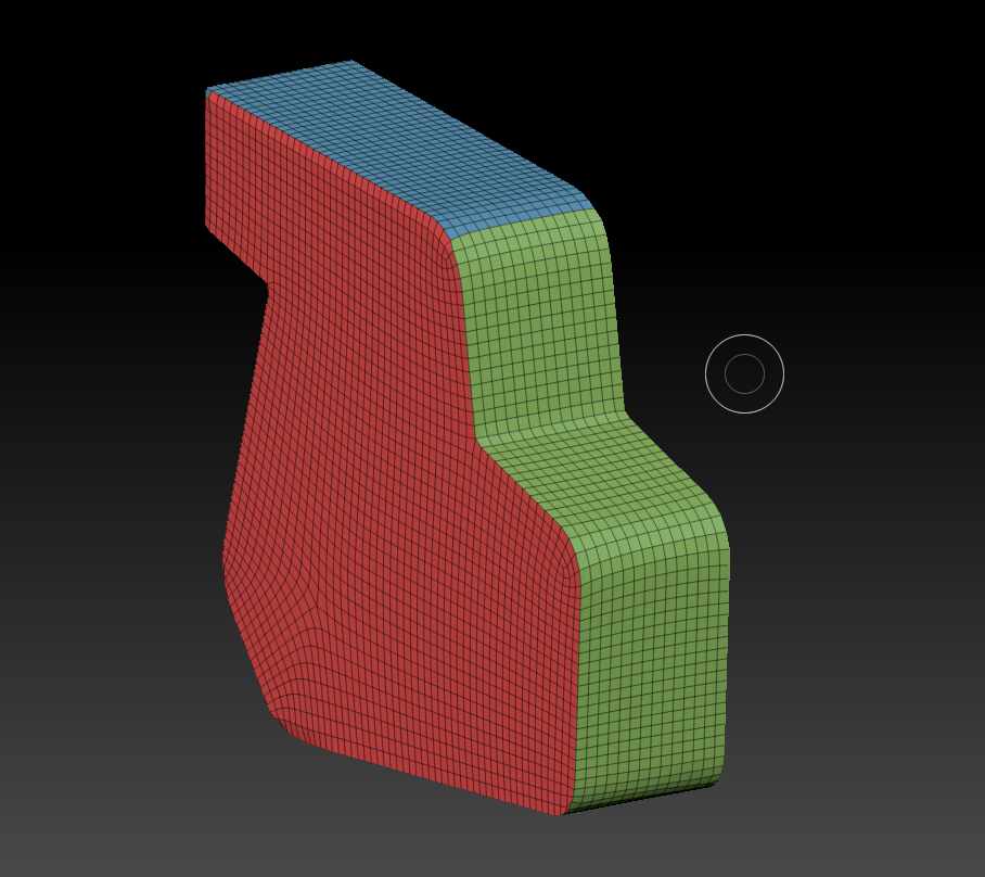

e.g. bevelling those interior edges does not work, even though their are straight. Symmetrie does not help here…bevelarc2 bevelarc1
