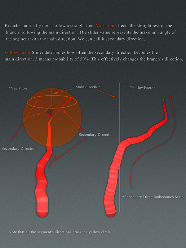

And finally… I made a little plugin to grow “ivy” on top of a mesh. it’s very very slow but it works for me. It has the advantage that you can use masks to guide where you want it . Not sure if it’s something people would be interested but I am still playing with it and adding things…

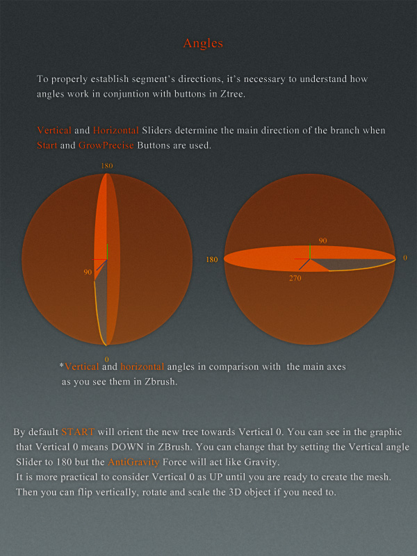

Edit: Oh, I and I forgot to mention something… The Trees don’t necessarily grow upside down… Everything else is upside down in the Zbrush world.
Don’t believe me? Try to see the coordinates at the position Sliders in the Tool:Geometry Subpalette… move the Y towards the negative side and see where your mesh goes. Or try to look closely to the transpose line coordinates. Negative is UP!
But hey, who said that negative can’t mean UP and positive DOWN?
You can work in any direction! and use rotation and flip under the deformation panel later
Also there is a vertical slider, want to grow in the other direction? move it all the way to 180 degrees. the only difference is that the antigravity will act as gravity…

Hey guys, Am I the only one having trees growing upside down ? x)
I came here to find an update but it doesn’t seem to make a difference; is there any trick I’m not aware of ?
Hi Tetsuo… if you simply set the vertical angle slider to 180 and click start it will go Up but this won’t work with the auto trees. Notice that, at any time, you can go to deformation and mirror in the Y axis or X/Y axis and fix it…
The main reason I decided to set the default vertical angle to 0 was because I wanted to consider positive coordinates in the Y axis to be Up.( in ZBrush Y negative is up) and because this way the attraction force that I made (that I called antigravity just because I am a freak and I didn’t want to sound pretentious by calling it phototropism ) goes in the right direction. If you grow the tree in the opposite direction ( vertical slider 180 ) the Attraction force will act like a sort of gravity force. This can be what you want but by default is the opposite.
So, again, the solutions are pretty simply :
1- work with the tree like it is and mirror Y when you are finished or after you make the adaptive skin.
2- start with an angle of 180 in the vertical slider but this will make the attraction force , if enabled, to behave like gravity.
I got this question several times so I will probably just flip the coordinates and update the Plugin soon.
Tetsuo, I just changed the default vertical orientation to 180 so now the trees will grow UP by default. (bear in mind that the vertical angle slider can be changed to any desired inclination ). I also changed the direction of the attraction force and the Auto trees . Finally I fixed that weird alignment of the first two buttons that were set to be of a fixed size and not relative to the width of the sub-palette, they should look better now.
Try to download it again…

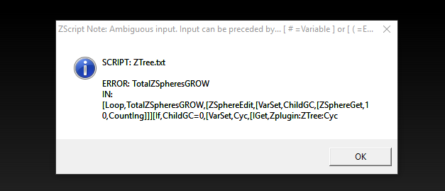

Thanks a lot for the plugin! But I have one problem with one. When I click L-sys buttom appears an error2016-09-11_13-26-32.png
How i can solve this problem?
you need at least one segment( 2 zspheres) to use L-Sys. So, go to segments , set it to 1 and press start, then try to use the l-sys.
