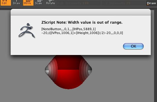

Does this script work with the Mac version of ZBrush 2 ,Iam not having any luck. I am following the instructions and am using the corrected script. My selected Zshere turns red and I get an error message ā€œZscript Note: Width value is out of rangeā€
Tbeattle is correct TVeyes, Mac users are getting the same error.
Thanks to both of you for notifying me.
Here is a version that will work on a Mac (and PC). XYZadjust2_Mac.zip
You will still need the graphics from the file on the first page of this thread.
A new version is due very soon. Yes I know, but this time it really is soon:) I will also be hosting the files myself so various versions are not scattered across a thread like this one.
This now works. Mucho gracias! Merci! Thank you! Woooohhoooo!!! :smiley:
