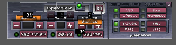

When I load the script the interface is upside down and backwards. Has anyone seen this behavior?wackedOutInterface.jpg
That script was written for at the very least 1.55b and maybe even an earlier version. Things have moved around a bit in z2 so sometimes older scripts don’t quite work right.
if you are using z2 there is a spin button…i think its called spin…i don’t have zbrush in front of me at the moment…check the tools, transform or plugin menus. When I get a second I’ll look and get back to ya.

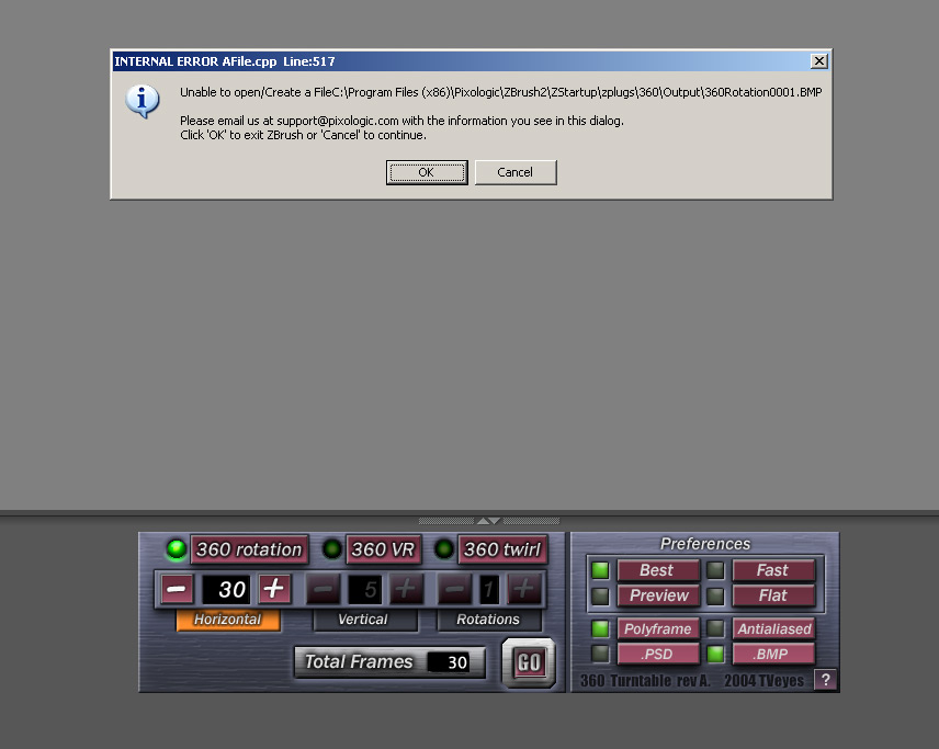

getting the following error with script
please help
I suspect that error is caused by a missing folder. Do you have an ‘Output’ folder at the path given in the error message? If not, create one and see what happens.
HTH,
Same with me, the interface is turned backwards like in your case.
Please, dear author, correct us or the proggy.
