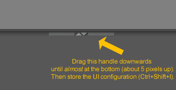

A tip for those who work with a maximized work space:
To stop the canvas being resized when you use the hotkeys (or many other plugins), drag the bottom canvas resize handle until it is almost at the bottom - about 5 pixels is right. Then store your UI configuration (Ctrl+Shift+I). The canvas will now remain at this size.
