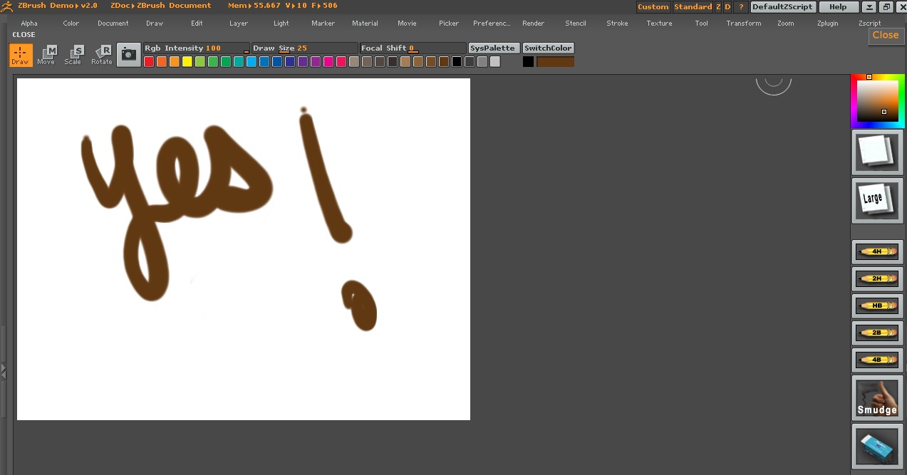

does this script work with the demo ?
Paul
Absolutly yes! :sunglasses:
