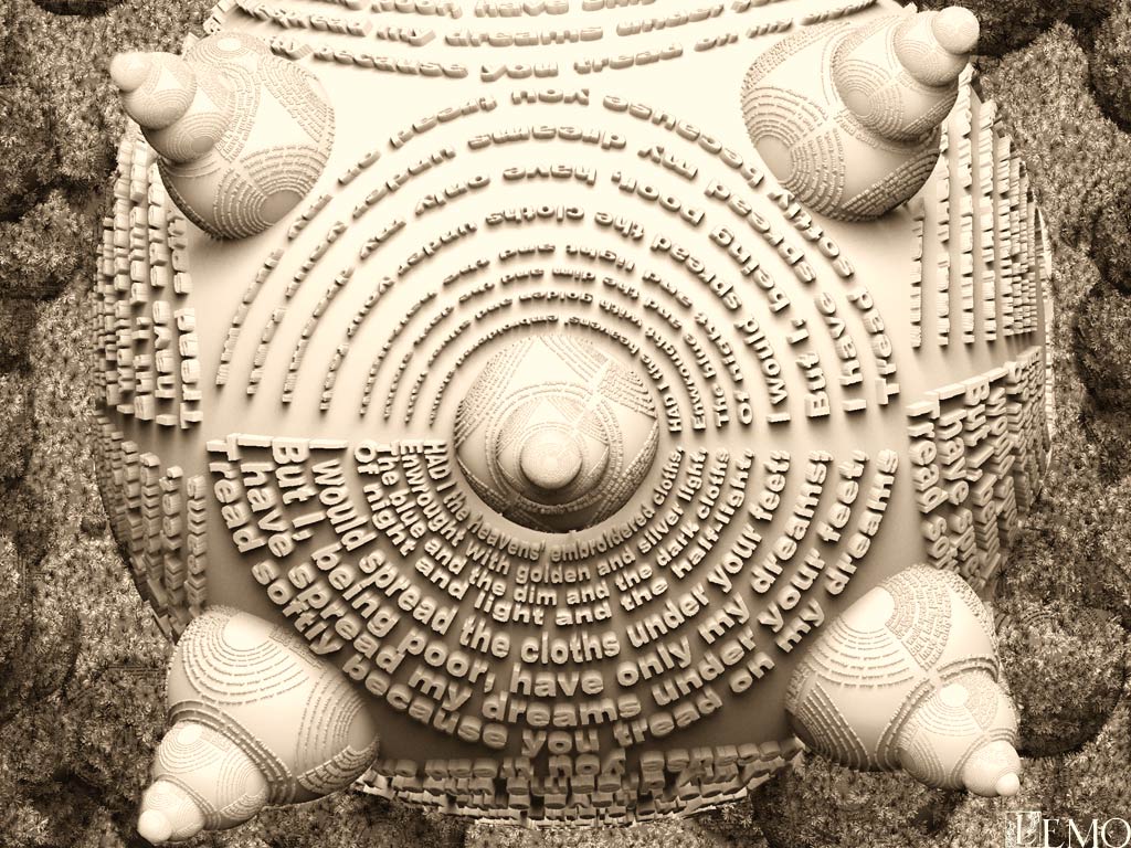

This is a lot of fun, but for the life of me, I cant get sharp text. Could you offer advice for sharp text.
I used assorted maps of 2k to 4k on models of 2ook poly to 2million poly, smoothing etc, but still jaggy edges. I tried psd, tif, bumps, I tried grabbing my mask for alpha… nothing seems to work.
Any advice
Sorry… have not seen this for a while. The secret is:
[attach=37695]highrestext_actual.jpg[/attach]
And Highres means HIGH RES. 2Mio will not cut it. One subd level higher and you are in detail heaven! For this cube I put a few support beams into my house before I dropped it onto the canvas ;-).
Besides that… Mask with 2K texture or higher… I UV mapped the 2K image onto each side of my cube. So it would require a 2K x 6 large texture to yield the same result on a cube where all 6 sides should be different… The cube itself has 6.x Megapolys… So… yes, it’s excessive…
Lemo
PS:jpg make such a mess out of the result 8-(. It’s much much sharper on my screen. To bad we can’t use .png…

Just playing… Thanks to WB Yeats for the great Poem.
Lemo

Yes, it’s bit cliche, but I was compelled to make it.
[ATT=]SphereTest.147.jpg[/ATT]
