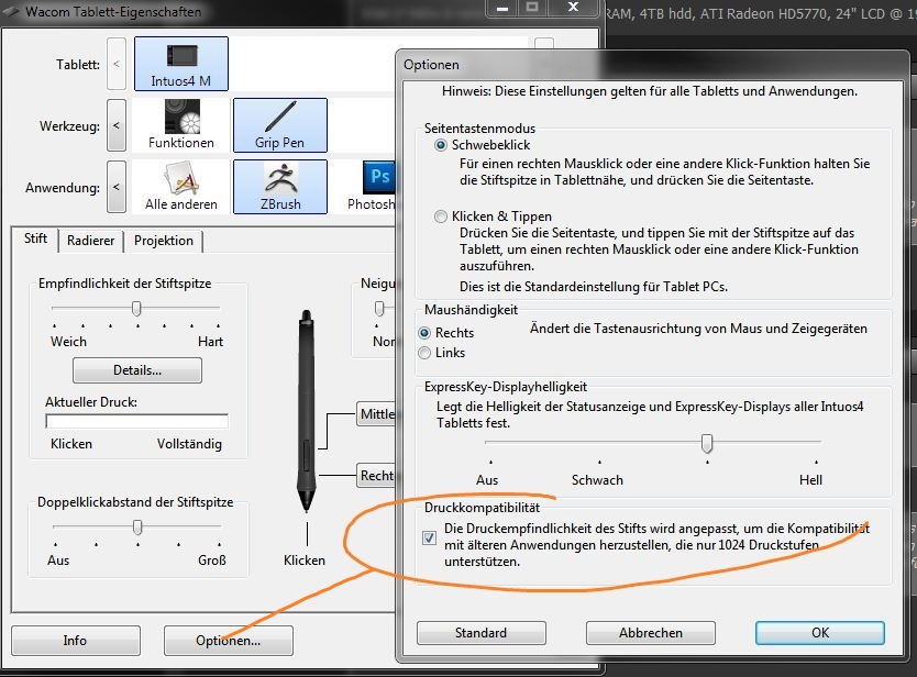

I had the same impression last night, but since it seemed a little laggy on my desktop , but not on my notebook although both have the same computing power I wondered what the difference might be and right away checked my wacom settings.
after comparing I noticed that there is one setting I had activated on my laptop, but not on the desktop. it’s under options and deals with pressure sensitivity compatibility. see the attached image which unfortunately shows the german menu, but it should still help you locate the option in the menu.
once I activated that setting it seemed a lot smoother again. didn’t seem to matter with the previous Zbrush version though.

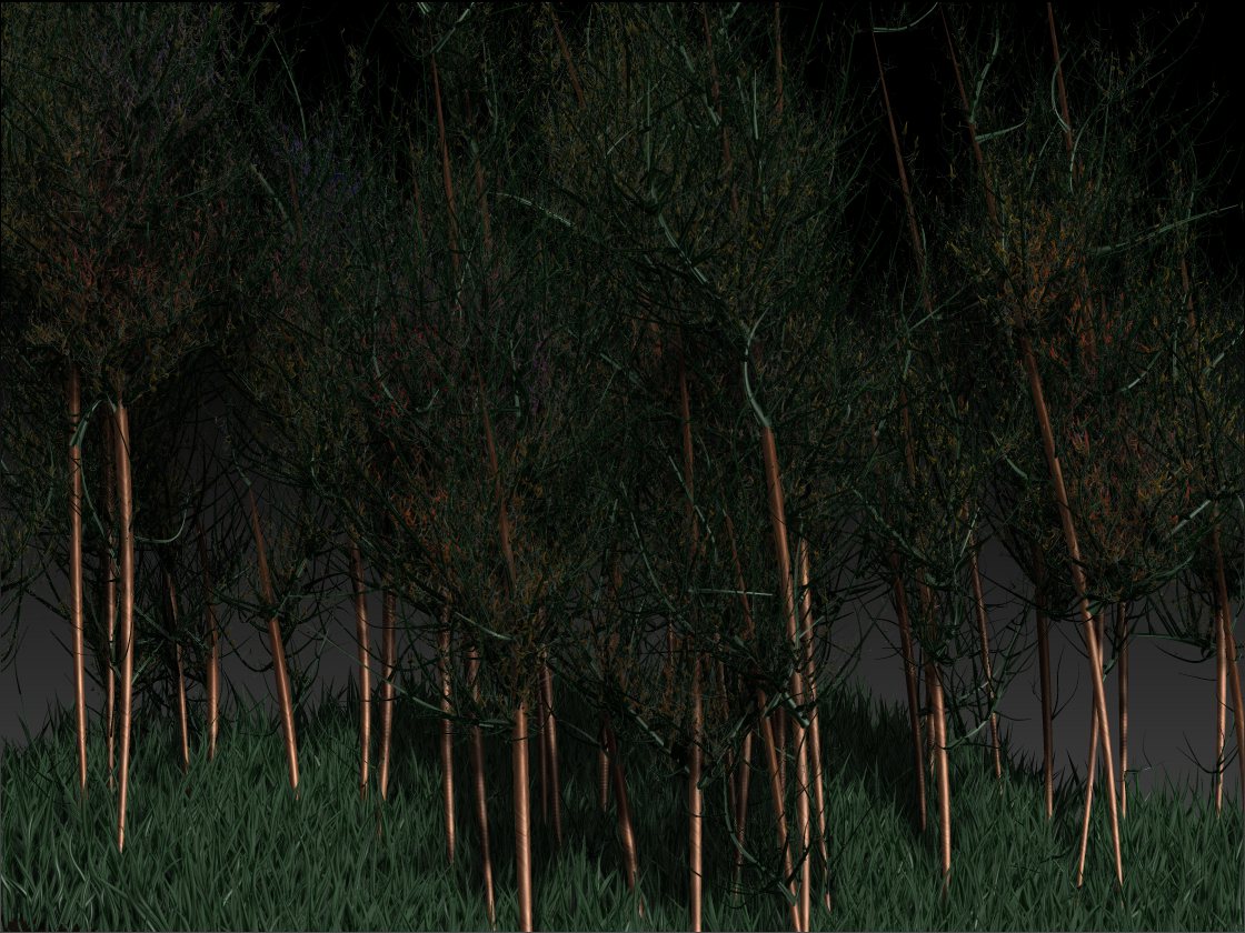

last doodle for the day , a very cool addition to zbrush, i’ve smacked hair on some of my old models to test with and you can get cool results in no time.
This one was a try at a funky forest ;p
