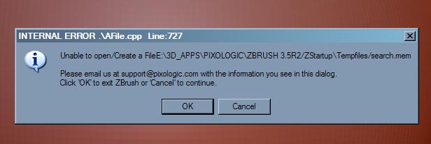

A few minutes ago I followed the suggested procedure to activate 3.5R2 and whenever open ZB I get the following message…
Some times I also get a second message, " cannot write to file" .
