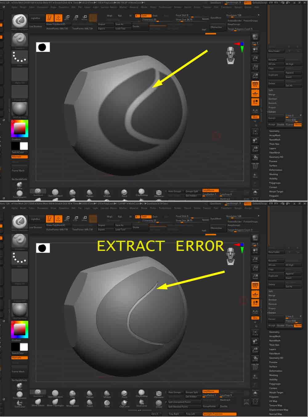

Good evening with the last update I encountered the following problem with the extract mesh function.
It does not respect the design of the mask.
And I also ran into problems with trim curve brush, it doesn’t behave like in previous versions.
Bye
Leo

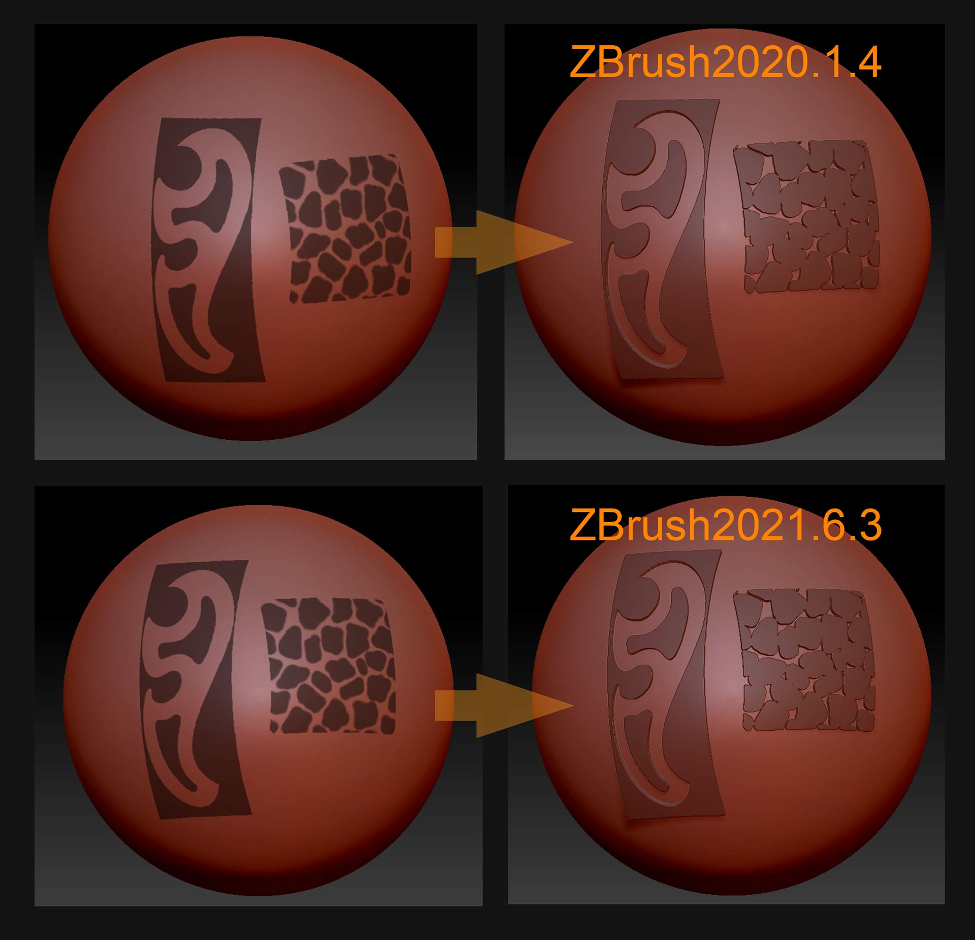

Hi @marciani
I’ve tested your extract issue, and find no significant difference in the silhouette of the extract generated on the same tool in ZBrush 2020.1.4, and ZBrush 2021.6.3.
extractacc
How accurately an extract can capture the shape of the underlying mask depends on many factors, including the underlying mesh size and resolution, and the settings in the Subtool> Extract menu.
If you feel I’m missing something with your scenario, or you’d like to elaborate on what you feel the issue with the trim curve brush is, please visit Pixologic Support, and start a conversation there. The Pixologic Support site is where technical support for ZBrush for registered users of the program is conducted. Reporting an issue in any other way risks having your issue go unnoticed by the developers.

extract-error2
it seems to depend on the type of brush used

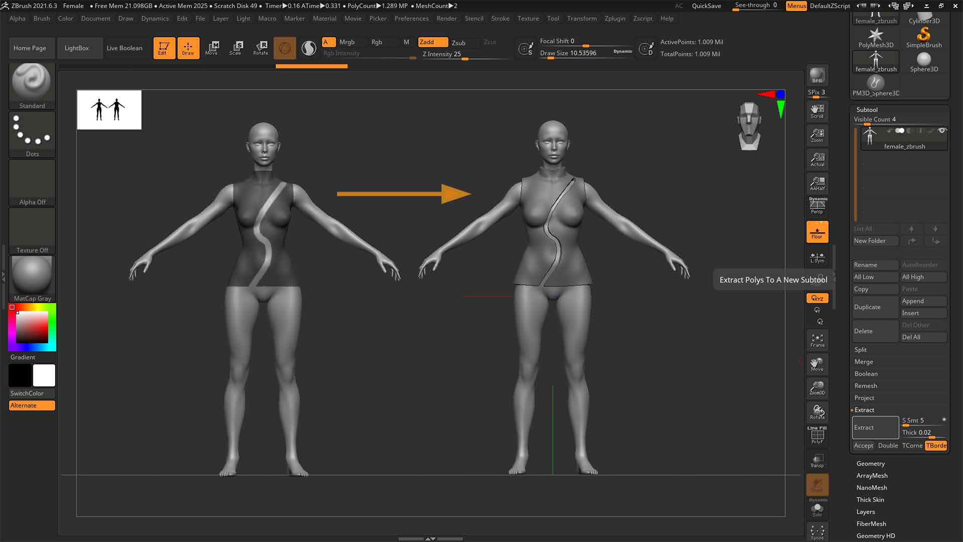

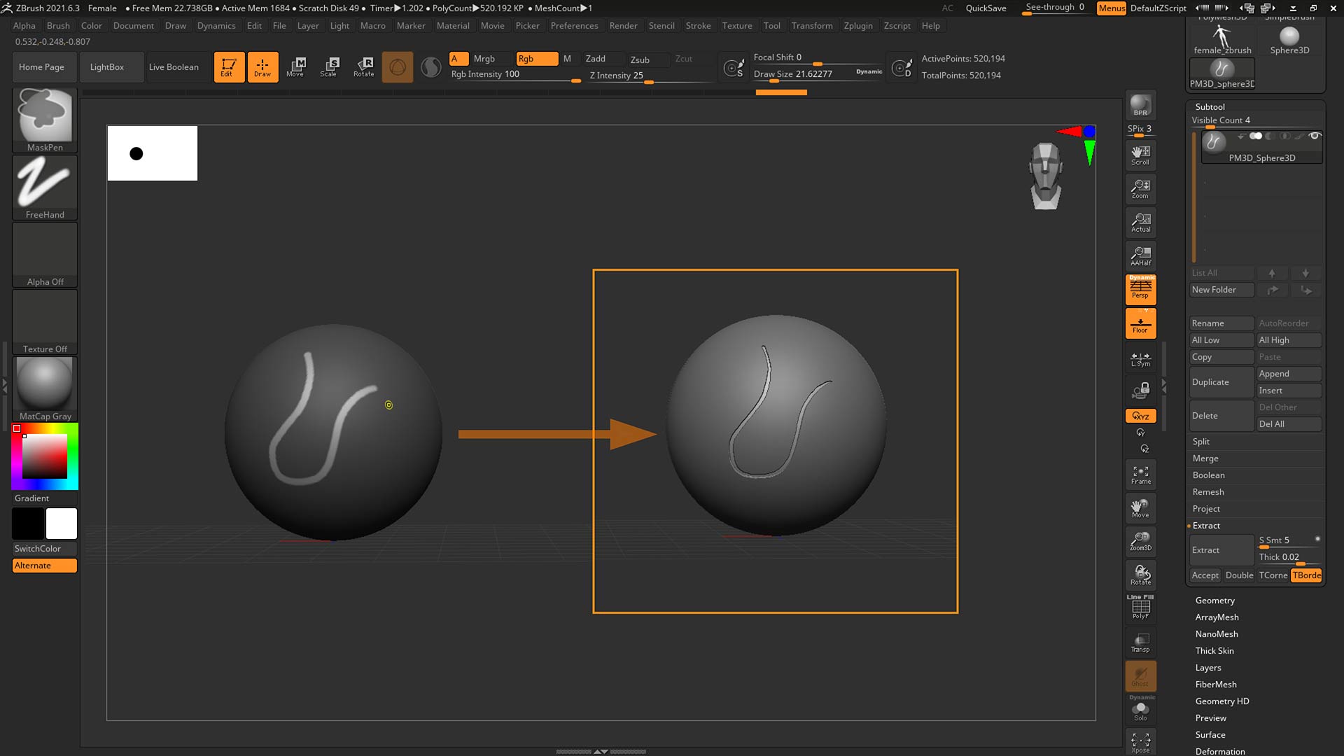

Hello @marciani,
I’m sorry, I cannot recreate your issue. All my testing indicates Extracts are functioning as expected:
extractacc3
extractacc2
Please be sure to perform your testing with a traditional mouse to rule out any issues with a tablet. Depending on the pressure sensitivity settings of your tablet, the stroke you are making may not be completely “clean”, and may be leaving residual masking value causing the extract to close up more than expected.
Please address any further problems with this issue to Pixologic Support as directed previously. No further examination of your issue will occur in this thread.
Thank you!
hello @Spyndel
we are probably on the right track; it would seem that using the wacom tablet generates the error in question, an error that never occurred in any of the previous versions.
I tried to change the parameters in the preferences / tablet menu but without success. Any suggestions?
Thank you
@marciani. As Spyndel mentioned, what’s happening is the pressure sensitivity is not 100% unmasking all of the polygons.
What I’m assuming you are doing is masking off the whole sphere and then doing one stroke of unmasking, correct? This one stroke it taking in account you pressure so it may look like there is a 100% unmask but there are polygons that still some masking on the meshes.
If you try what you’ve been doing and click the 1 key a few times after you unmask do you get an extract that you expect.
With this said, I’ve reported your findings so we can look into this for future versions of ZBrush.
seems to work, honestly I don’t know where to change this parameter to avoid this error.
thank you

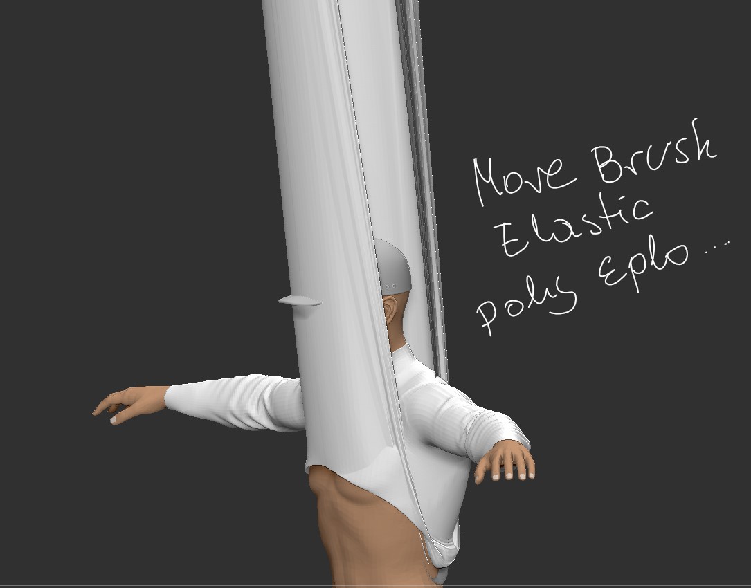

With all the new updates that provide great tools I also experiencing huge amount of crashing like never before while working on a simple low poly models . Especially after using dynamic cloth on the model , using after simple move brushes it explode the polys in every direction , also a lot of subtools getting corrupted to the point I have to delete it or can’t even display the project on the screen as everything vanishing all together .It is random , not always happening but something trigger this and since working with Zbrush from its first release I never experienced as much troubles since the release of Zbrush2021.1.2 and it getting worse with each update latelly.

I did not experienced crashing after installing the new updates yesterday and working with it for many hours , other little issues solved itself as well , but the only major issue that persist is still the Move elastic brush , polygons still exploding and I had a lot of troubles yesterday with using it to the point I had to stop using it .Screenshot 2021-04-21 081344

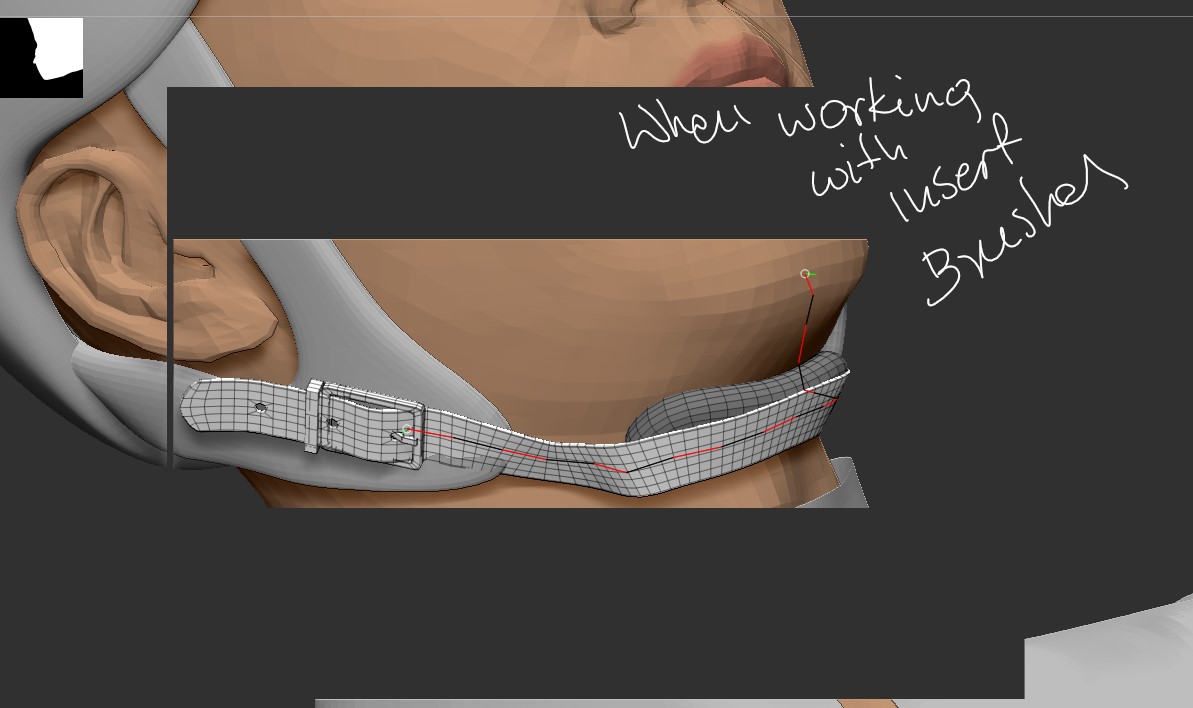

also when using insert brushes I am getting weird artifact second window on the screen
